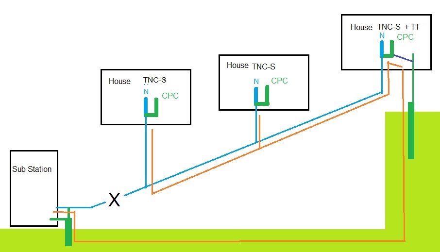

The orange path is the only way the Neutral currents from the loads in the houses can return to the sub-station. The purple link Rod to CPC in the house is the critical weak point.
That corresponds with what I wrote.
However, as I said, and unless the CNE fault is at or close to the transformer (e.g. due to 'metal theft', seemingly fairly improbable with 'a transformer in someone's garden') in the OP's situation it would seem that any such fault would be most likely to arise downstream of the last connection to another installation, in which case the only current which had to return to the transformer would be that due to the OP's installation - and, in that situation, even if the earth rod (or a bonded extraneous-c-p) had a (very improbable) extremely low impedance to earth, it's unlikely that a TN-C-S-compliant earthing/bonding conductor (i.e. ≥10 mm²) (your 'purple link') would come to any harm with a domestic supply.
However, as I also said, literally millions of people have TN-C-S installations without even being aware of this potential issue, let alone 'doing anything about it'. Even if a local earth rod becomes a requirement for TN installations, the likely impedance of any real-world domestic rod is unlikley to have appreciable impact on the situation, or be asked to carry any large current. The greatest potential risk exists if there are very-low-impedance (bonded) extraneous-c-ps, in which case addition of an earth rod would essentially make no difference at all.

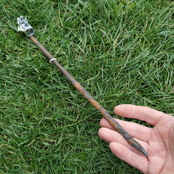

Rods corrode and rot away, often in a very short time.
This is an example after less than 10 years. Was a 4ft long copper clad rod.
Rods corrode and rot away, often in a very short time. This is an example after less than 10 years. Was a 4ft long copper clad rod.
I don't doubt that they (particularly fairly 'modern' ones) can, if (assuming they are steel) the copper cladding/plating is not very substantial, although I have to say that my 'original' rod (which I suspect is best part of 100 years old) still has a very respectable impedance - but I suspect that "they don't make them like wot they did back then"!
I do agree that one should use something which is likely to last (physically) for a long time, and that one should look for a n impedance no greater (ideally appreciably less) than 100 Ω, but as I recent wrote, particularly in the context of discussions like the one in this thread, I don't see why people should be wanting 'very low' impedances, particularly give that such will increase even further the potentially very high currents, under certain fault conditions, which they appear to fear.

If the DNO's fail is an open circuit Neutral in a TN-C-S service then all the electrical wiring in the house including the CPC will be pulled up to Live potential. The path for this pull up is through any appliance or lamp that is switched on. Gas meters and other external metal works bonded to the CPC / MET will also be pulled up to Live potential.
To the people in the house it will appear to be a power cut, nothing electrical is working, they will see it as annoying but not dangerous . They will be unaware that almost all Earthed metal will be at Live potential.
