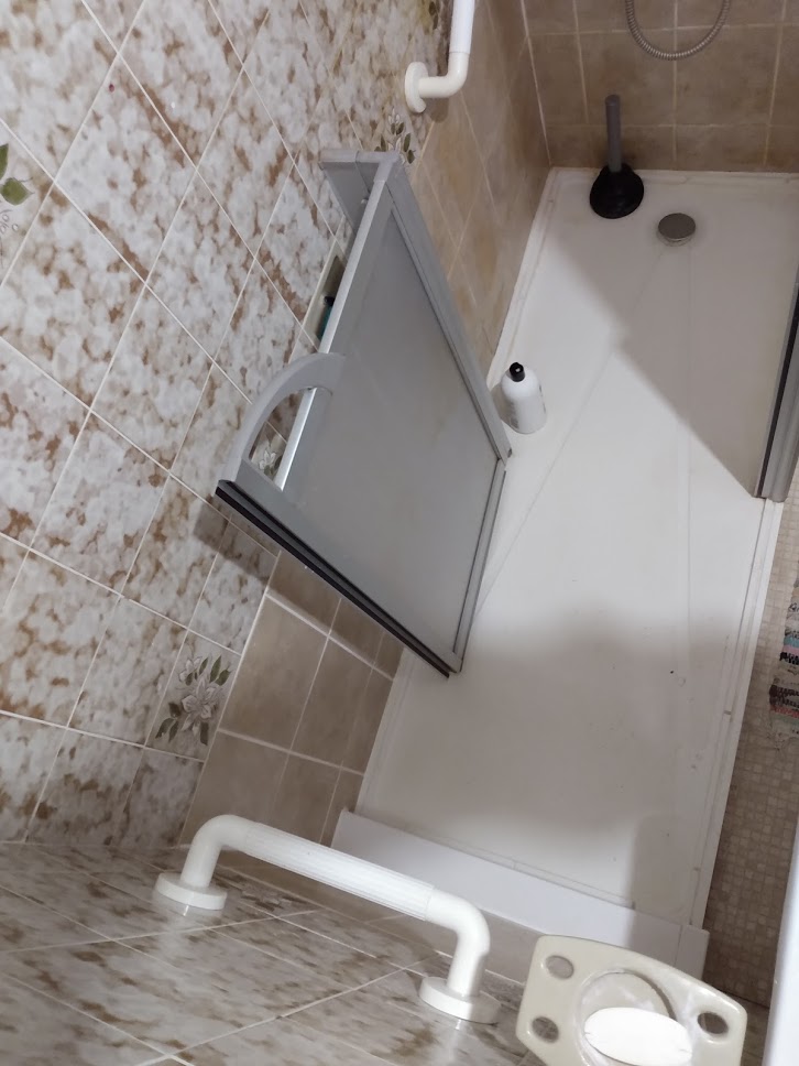

New shower room will be finished soon, which is good news!
Before renovating the old shower room (that will become a bathroom) I need to do the hallways and guest room, so still 6 months from sorting the old shower room out. But my wife really wants her bath back.
The old shower room had a bath, and previous owner replaced with bath sized shower tray. So, idea is to just pop a bath rub in, secure somehow, and shove the bath waste down into the shower waste. Quick job, just so we have a functioning bath.
Is that a good idea? Or will it end up being more work than it's worth by time it is secured in place? Won't need to be sealed, as water will just drop onto shower tray...

Is this just as a temporary (6 month) job til you get to do it properly? In which case crack on. You might want to put some sort of restrictor in the bath drain so it doesn't overwhelm the shower drain (unless you get lucky/can arrange the bath so the plughole lines up with the shower drainhole). Obvs get rid of the decorative plastic top from shower drain
Yeah, temporary. Literally rip out the shower door and side panel, dump bath in, make not wobbly...
I guess I'd need to make some sort of frame for the bath though, then dismantle it? Or do baths come with frame these days? Never bought one before!

The cheap plastic baths come with support legs & that's about it.
Is that shower tray plastic or solid resin- if placcy then it may not take the weight of the bath, if resin then some plywood under the bath feet as load spreaders should do. Frame for the bath=make it up yourself, bit of 3 x 2 screwed to the wall on 3 sides & a lashup for the open side of your own design, I'd leave a catflap so you can keep an eye on the drainage sketch
Yeah, that makes sense. Maybe just put a bit of chipboard floorboard down for the bath to sit on. Probably won't bother with a side panel at all.
Tray is solid, resin I guess.
If it's temporary and the shower tray is being replaced anyway I wouldn't worry about protecting the shower tray. My bath has wood bonded into the resin/fibreglass under the lip and just used L brackets to fix it to the wall, so it should be simple enough to lash the bath up.
For the drain I would remove the shower drain as best you can and then bodge a new pipe in and sealed with whatever you can. In an ideal world you'll get enough access to solvent weld a new pipe in, but that might be a long shot. Though temporary, it might be easier to make enough space to get the drain connected properly. The simplest bodge would be to fit a tap to the waste and set it up as a restrictor so the flow doesn't flood the bathroom, depends if you want it running for 30 mins to empty it.
To be honest I'd just lash everything up and restrict the flow.
