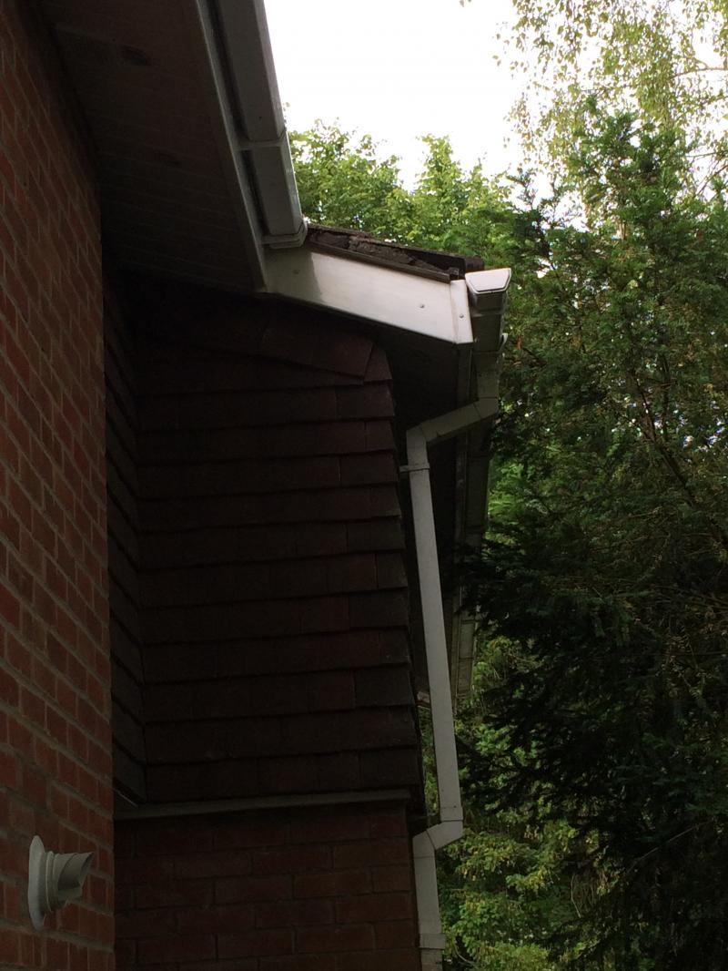

Hi - I'm in need of some advice please...
Last week I noticed my gutter overflowing. When I tapped the downpipe, I could tell it was full of water. The downpipe goes straight into the ground/concrete. Today I cut the pipe to see if I could clear the blockage - 5 hours later, it's still blocked. I'm very concerned that the pipe hasn't been installed into a proper soak-away or into the drains. I don't have the tools (or even the will after 5 hours) to dig up the concrete.
I wondered if Plan B might work - I have two gutters on the side of my house with two downpipes - for two different extensions. The attached picture shows the other downpipe - which definitely drains water away fine. In the top left of the picture is the gutter with the faulty downpipe.
Is there any reason why I could join the gutters together and remove with my non-functioning downpipe? Is there a maximum roof span that a downpipe could sufficiently cope with in the event of heavy, prolonged rain?
Or shall I just go for it?
Many thanks
Hi - yes I tried that and I got some debris up. I have also used my Karcher and cobbled together a pole with a hook to dislodge anything. But still the water only runs away very slowly - like a mm every 5 seconds.
I'm thinking that joining the two gutters together and getting rid of the faulty downpipe may be easier!

6. Your pic stopped short of the ground-RWP junction?

I would be inclined to reverse the fall then add another d/p drop, in the corner close to the one in the image then swan neck it over at the bottom and into the (if there is one) existing gully.

Squareline gutter has a fairly high carrying capacity, and will drain a large area, however I think you'll struggle to join the gutters as they appear to be on different planes. You'd be better taking Noseall's suggestion, although you made need a plethora of bends to join the two downpipes, if that one also goes directly into the floor.
Possibly needs further investigation as to where the water drains to, appreciate your reluctance to dig the concrete up, but putting two downpipes into one may overload the system, particularly if currently both downpipes go to separate soakaways....
From your pic it does look as if you could (with 2 90 degree bends and a length of gutter) link the high end of the gutter that isn't draining to the low end of the one that is draining. Better off (as someone else said) reversing the fall and linking, better off still clearing the obstruction.

My Karcher pipe cleaning attachment arrived yesterday - tried it this morning and the blockage went - total 5 minutes work!!
Thanks for all the replies...
