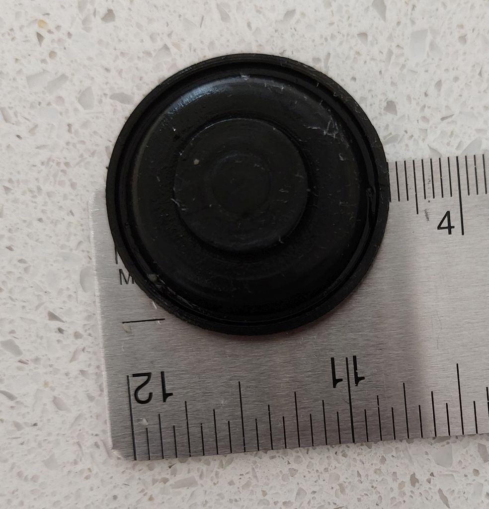

Recently the toilet fill spout drips for a long while after flushing. It's not leaking - I can push the ball down and when it's filled another few mm the drip stops. So on it's own it's just not shutting off sharply - and it takes hours of dripping through the night to fill that last bit to close the valve.
Is there any adjustment or cleaning I can do to fix it, if it's just due to it being a bit old and sticky?

1. Change the diaphragm washer in the inlet valve. These go hard with age and require increased pressure to shut off. Post a photograph of the valve and someone may be able to tell you what type it is.

This is the washer - around 33mm.
I gave it a good clean - lots of black rubber residue came off and some gritty bits. That seems to have helped with the drip. If it comes back, at least I can look for a replacement. Are they easy to source?
Less than a quid from your local plumber's merchant. It is a 25p component.
I am not a plumber but I vaguely remembering someone saying that smearing a little bit of silicone grease (read: not Vaseline) will stop the rubber from sticking to the housing/fittings. Hopefully a proper plumber can confirm/deny that.
Looks like a Delchem diaphragm washer. Toolstation stock them, Screwfix appear not to. B&Q have
Plumbsure Rubber Ball valve Washer, (D) 30mm Pack of 2.​
