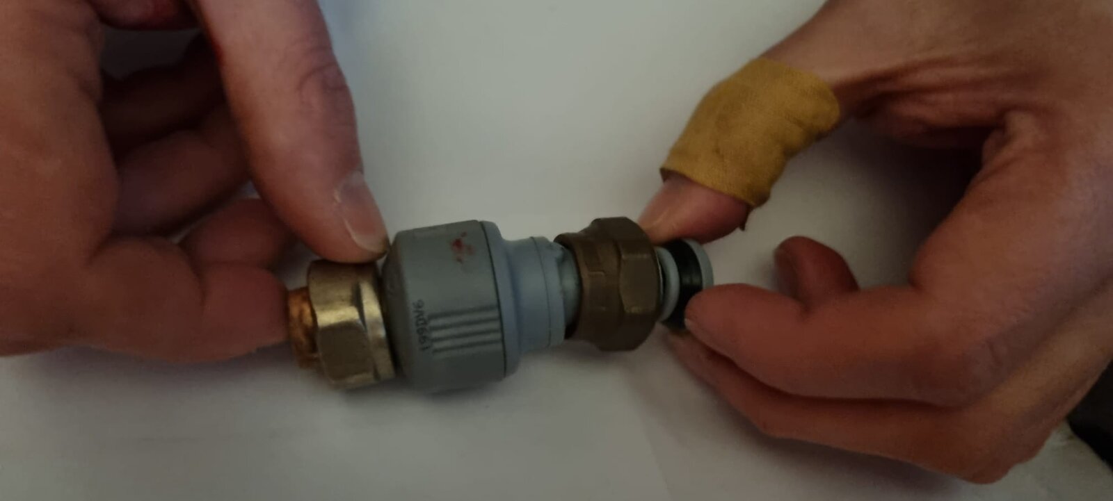

Can anyone help identify what part or parts this is please?
It goes between the top of the toilet shut off valve and the base of the toilet fill valve.
It broke when I removed the cistern to fit a new flush mechanism.

It’s an older version of this https://www.screwfix.com/p/hep2o-pl...0L3rDLdtS6JGmPC88xxoCIeQQAvD_BwE&gclsrc=aw.ds going onto a piece of copper with a nut and olive. Spare nut’s and olives are available, and you also have the option of soldered type (depending on your capability), or even a compression tap connector, https://www.toolstation.com/compres...c64TwbfoAI193NVtZjRoCkWEQAvD_BwE&gclsrc=aw.ds. If there’s no isolation valve, you could opt for https://www.screwfix.com/p/straight...XINYYBYreTf7NpTV3UxoCx1MQAvD_BwE&gclsrc=aw.ds

Thanks for the quick response.
I've ordered that and demount kit. I take it I can just use the demount kit to unscrew the copper pipe and refit from there?

Demount kit not needed for the grey type, my mistake sorry, that part will unscrew, then, being careful, remove the rubber o ring, green grab ring (sharp), and possibly a plastic washer. Therefore retaining the nut and olive.
