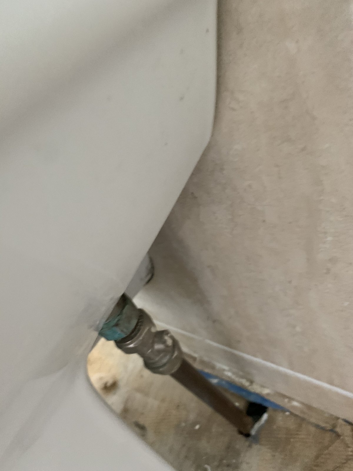

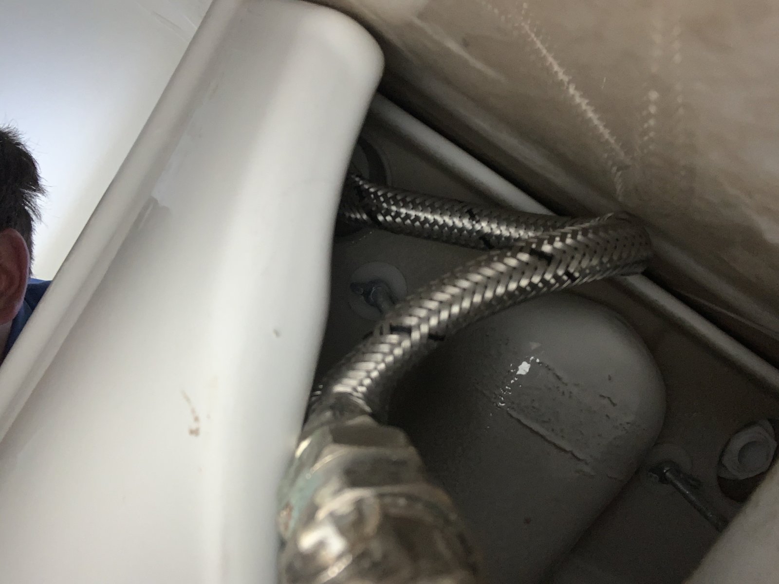

Right, so isolated the mains. Took screws out of cistern.
tried to disconnect the cistern feed but I am officially defeated. It’s absolutely welded on and I cannot unscrew it. See pictures.
I wondered if I can unscrew from inside the cistern but i can’t see a clear place to unscrew it.
Am I officially needing to call in a plumber? That hose connector to the valve will not budge

Release it from the next isolation valve compression fitting and work on it in comfort .
the one at the bottom is the one I am trying to unscrew and it won’t move.
there is no way you can reach the one at the bottom of the cistern, that’s completely inaccessible from below.
or do you mean the one below the valve?
To clear up what I mean.
the one up on the flexi hose is inaccessible
the one below IS accessible but twisting the hose connector above the valve is completely stiff and stuck, even with 2 spanners.
there’s a connector below the valve attaching to the copper pipe. That I haven’t tried
Hold the isolation valve with a set of grips ,and undo the nut on the top of the valve with a spanner. It's really not that difficult !
