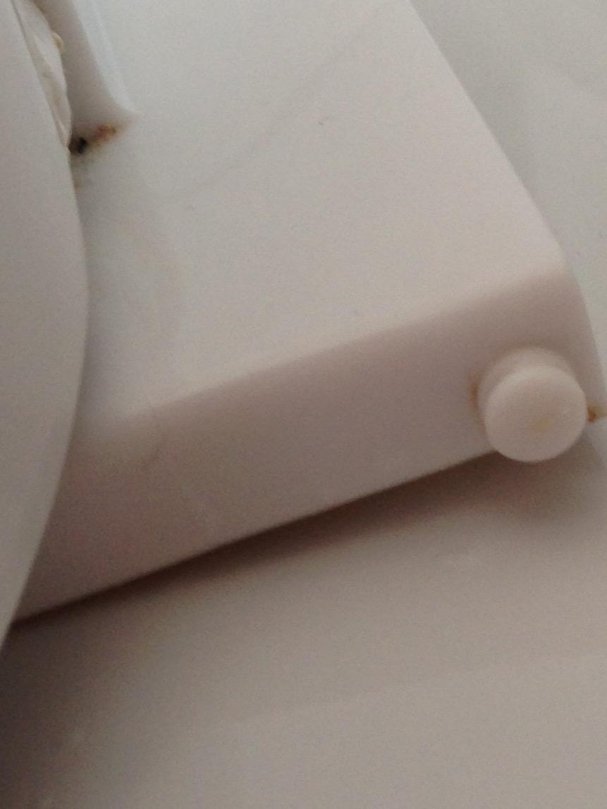

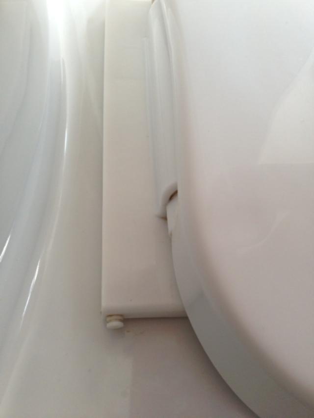

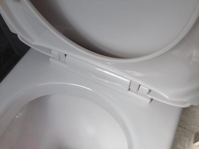

Can anyone tell me how to remove this type of toilet seat - it is top fixed as there is no access under the pan.
The plastic "screws" on the side are removable but I still can't get the seat off.....has anyone got the same seat or know how to remove it? Many thanks!

If you remove the plastic screws on the side what can you see? It is normally a case of squeeze this/ push that and lift at the same time. So thinking the release catches might be under the screws which are in effect only covers.

Just recalled one where that bar at the back was the release catch.

You might get lucky if you push a screwdriver in and feel a spring tension, that will be the release catch, so push anything you find and pull the seat as I said earlier.
