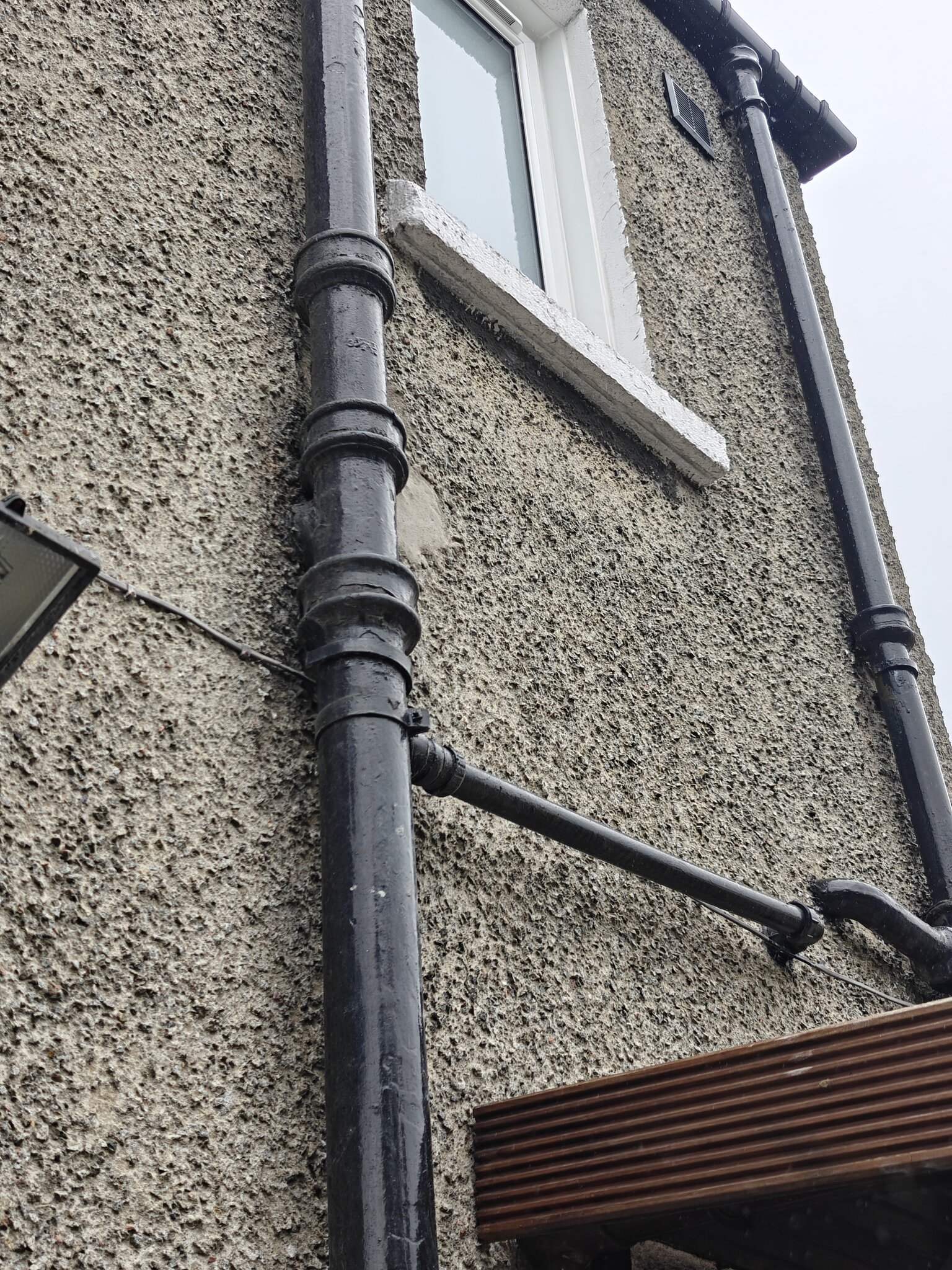

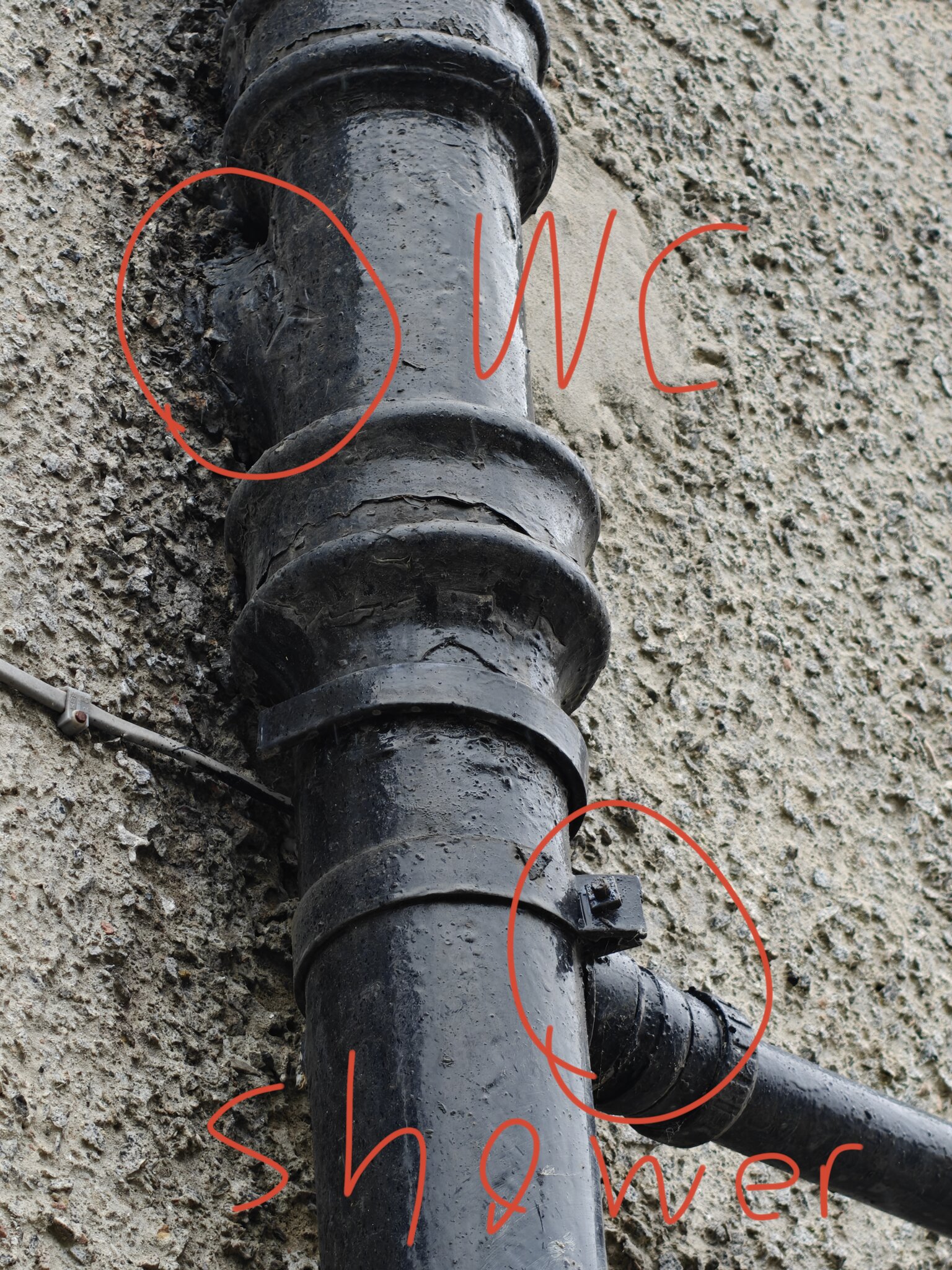

Im replacing the bathroom in my new house and found the toilet and shower share the same downpipe. The basin runs to a different stack.
I used to do some plumbing when I was younger and I've never seen this setup. It seems a bit unhygienic. It's an older house so the waste and rainfall downpipes will share one sewer in the street, but I still feel the toilet and shower shouldn't be connected like this. A back up could cause sewage to flood the shower before the toilet (those in theory if it all runs to one sewer in the street, this may not matter).
Should I move the shower waste to another downpipe (basin is using the old bath waste) or is it a waste of time and money?.
Single Stack system, widely used since the 60's. Provided the smaller appliances are fitted with the correct depth traps, you should never have an issue. Waste pipes into Hoppers are banned unless as a direct replacement for an existing setup.
