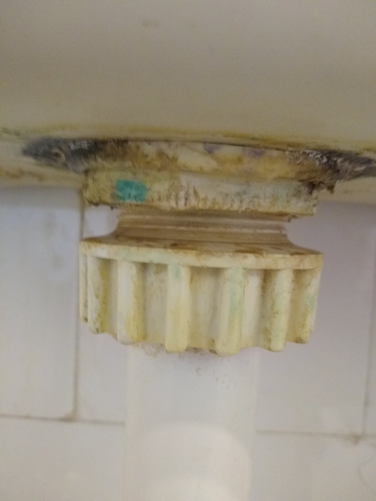

Hi - it's leaking slightly on the underside of the cistern (on the outside). It's a bit messy with some kind of sealant and presumably a washer or just the backnut. On the inside of the cistern there seems to be a kind of squishy doughnut of sealant - isn't it normally just a flat rubber washer (or a domed washer?) - some say use use silicone sealant in addition to the washer, manufacturers say it's not necessary?? Because it's all a bit messy I'm worried that if I dismantle it I may not be able to reassemble and make it leakproof. By the way the cistern is marked August 1970!
Regards.
I would take the siphon out and fit a new washer on the inside of the cistern. NO need for a washer outside .

Yes ,inside cistern the siphon washer is a thick flat washer. Never needed any sealant in or outside cistern.

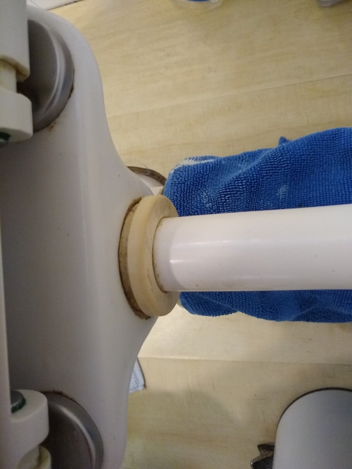

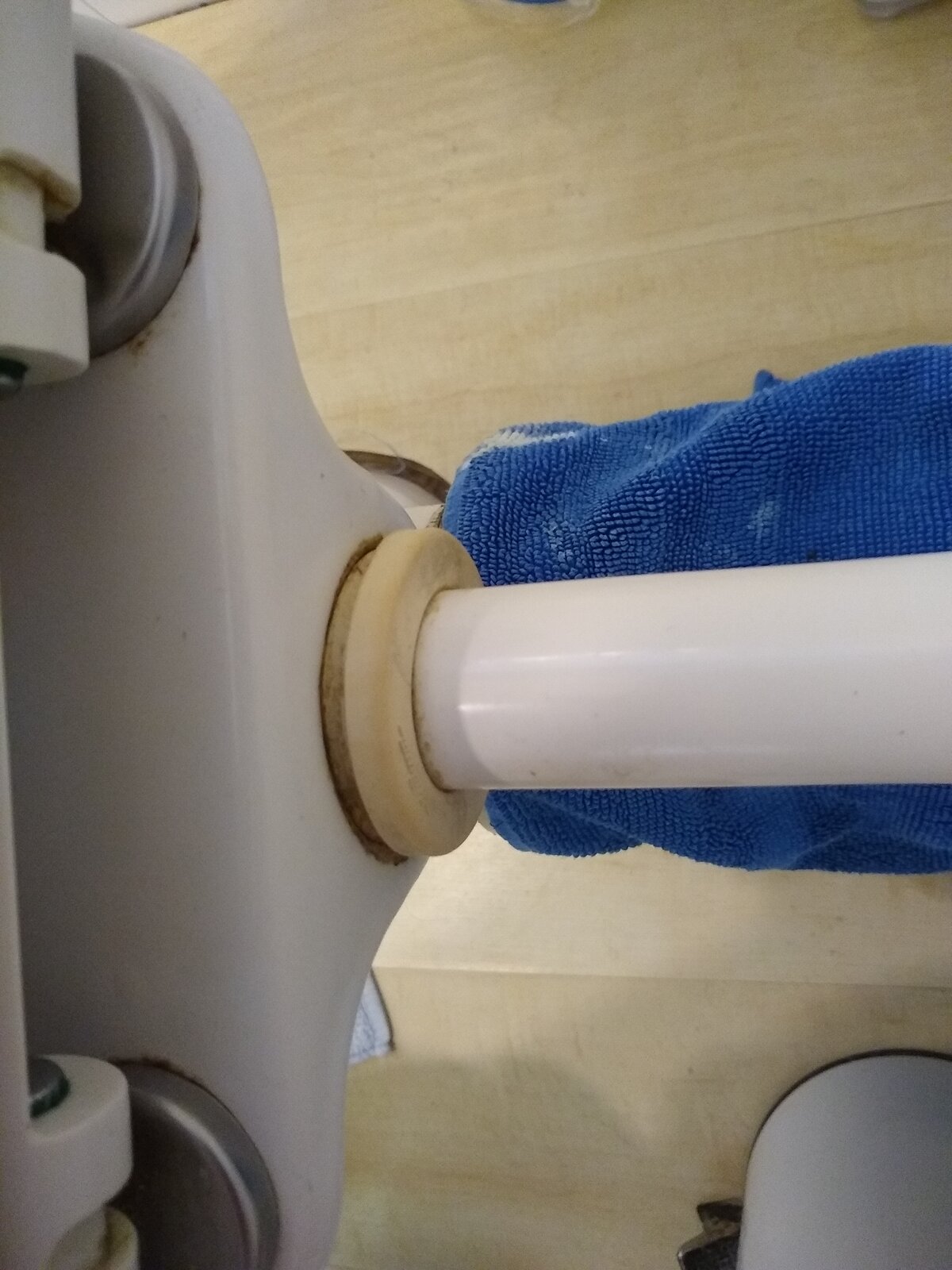

Where the flush pipe goes into your pan inlet ,is there an internal or external flush cone joining the two ?
Pics would be helpful.

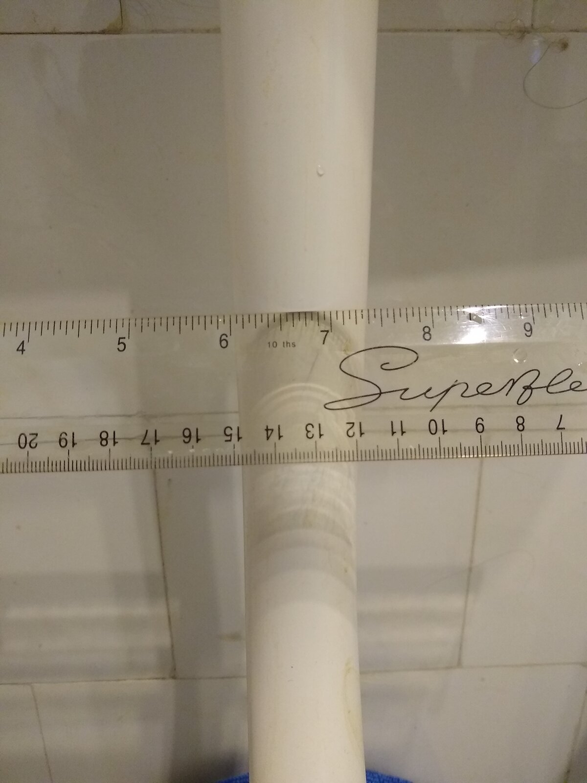

How have you determined the outer diameter of the flush pipe if it hasn't been disconnected ?
It's an internal cone into toilet pan inlet. I'm fairly good at maths so I measured the outside circumference which gave an outside diameter of 38mm giving an internal diameter of approx. 32mm (I believe plastic pipe is referenced by its internal diameter?). I've attached a couple of photos.

1 ¹/² inch pipe is 40mm outside diameter.
1¹/⁴ inch pipe is 34mm ( ABS pipe for solvent welding is a couple of mm larger ,but your flush pipe isn't gonna be ABS)
If your pipe is 38mm outside diameter it should join into a 1¹/² inch siphons compression fitting no problem.
Thank you Terry for all your help and advice. I thought I was familiar with1½" pipe and this looked smaller - I attached the photo with the ruler because the photo of the pipe entering the pan seemed a bit deceiving. I think I'll bite the bullet and go for it - it's not a great expense (in fact some washers are nearly as much as the full siphon kit!). I won't go for the £5 cheapos though some are favourably reviewed - but Fluidmaster seem well respected. Thanks again.
Regards.
The pic with ruler appears to show an outside diameter of 30mm ??
What exactly is the circumference ??
