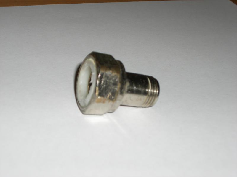

I'm sure there is a simple answer to this one but have failed miserably so far to find it!
I'm trying to fit a new water inlet pipe into my toile cistern by replacing the current ball valve unit. The problem I have is connecting the water pipe (a 10mm threaded pipe) to the plastic 15mm pipe. I think I need a 10mm x 1/2 inch tap connection but can't find one anywhere - there is one already so the item must exist but it has the old pipe in which I can't get out so need a new one.
This is what I am looking for:
[/img]
fit a 10x15mm fitting then you can fit a standard 15x1/2" connector or service valve.
