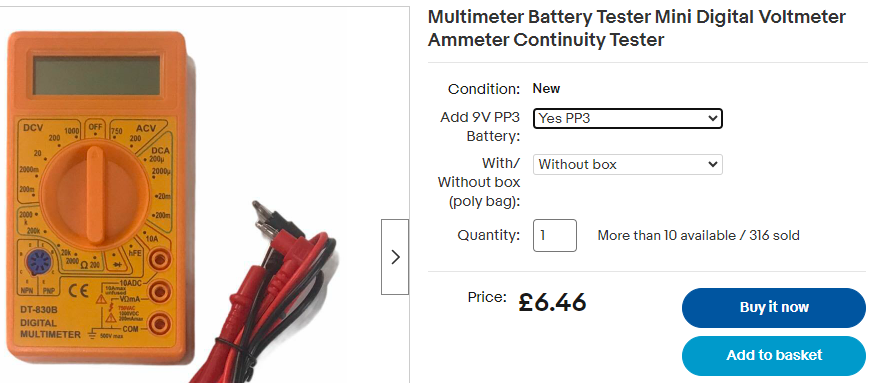

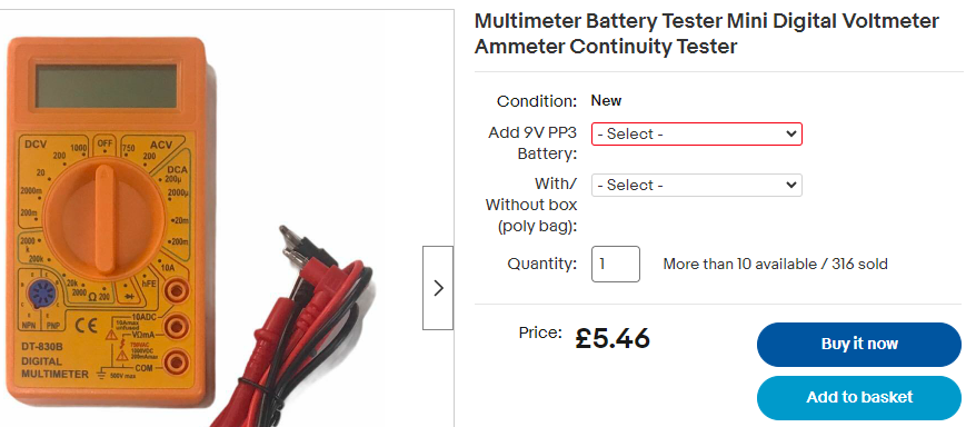

Likewise here, and much more expensive, but a more basic multi-meter can be had for not much more than £10, and will be more than adequate for the described task.
