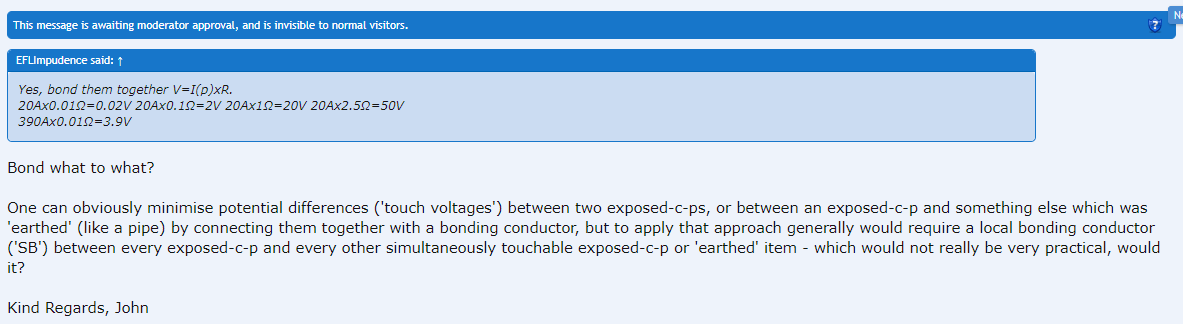

Yes, bond them together V=I(p)xR.
20Ax0.01Ω=0.02V 20Ax0.1Ω=2V 20Ax1Ω=20V 20Ax2.5Ω=50V
390Ax0.01Ω=3.9V

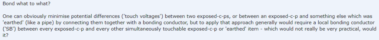

Bond what to what?
One can obviously minimise potential differences ('touch voltages') between two exposed-c-ps, or between an exposed-c-p and something else which was 'earthed' (like a pipe) by connecting them together with a bonding conductor, but to apply that approach generally would require a local bonding conductor ('SB') between every exposed-c-p and every other simultaneously touchable exposed-c-p or 'earthed' item - which would not really be very practical, would it?
Kind Regards, John
