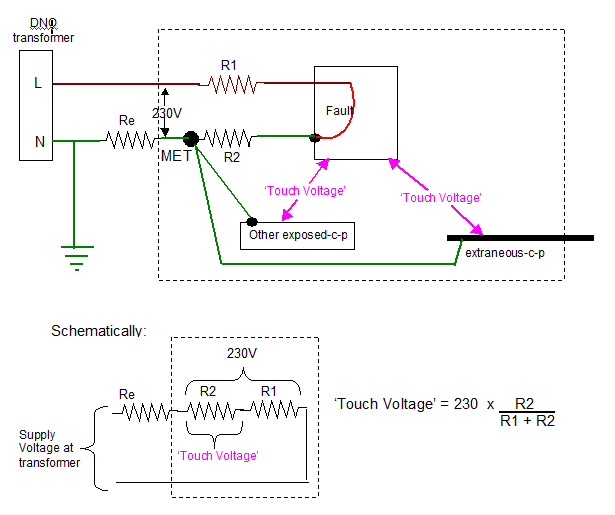

Not sure what you mean that the drawing is the wrong way round.
The values given were for the conductor sizes for the CPC and Line?
I was trying to simplify the resistance paths Ze 0.20Ω, R1 0.34Ω R2, 0.56Ω.
For a start, I'm not sure where your starting figures come from. The maximum Zs for a B32 is 1.37Ω and, per BS7671, 1.5mm² cable is 14.5 mΩ/m (at 70°) and 2.5mm² cable is 9 mΩ/m (at 70°). However, that doesn't alter the concept of your calculations.
This is from the onsite guide
You have also confused things considerably by drawing R1 and R2 'the wrong way around' - in terms of standard convention, R2 should be the resistance of the CPC - the one which joins to Ze (at the MET), but you have called it R1 in your drawing.
Not sure what you mean here.
The R2 ids the resistance of the CPC and the R1 is the resistance of the Line
More importantly, your Image 1 does not represent the actual situation, since the entire current loop includes the impedance of the supply L as well as Ze - and the voltage driving current around that loop will be the voltage at the transformer, usually more than 230V.
I included the Ze which I called Re. I was trying to simplify the resistance paths Ze 0.20Ω, R1 0.34Ω R2, 0.56Ω.

Thanks again. Not sure what you mean that the drawing is the wrong way round.
The values given were for the conductor sizes for the CPC and Line? I was trying to simplify the resistance paths Ze 0.20Ω, R1 0.34Ω R2, 0.56Ω. .... The R2 ids the resistance of the CPC and the R1 is the resistance of the Line
That is, indeed, the convention, and the point I was making was that, the way you drew/labelled it, it was the Line (R1) that was connected to the incoming earth (hence Re), not the CPC. Other than the confusion it caused me (and possibly others), it doesn't matter.
As I said, for working out 'touch voltages' within the installation/premises one is not concerned with what goes out 'outside' (i.e. Re). Apart from anything else, we don't know the voltage at the transformer - we only know (are assuming) that it is ('nominally') 230V at the origin of the installation.
Does this diagram help at all? ...

Thank you guy so much for you help and patience on this
So just to put some numbers in
0.56
----------- = 0.62 0.62 x 230 = 143v
0.34+ 0.56
So a voltage of 143 volts will appear on the faulty metal part.(If measured between the neutral in the CU and the faulty metal work)
And since all that metal work is effectively connected together. 143v will also appear on the exposed and extraneous CPs. Give or take a bit for the resistance of the ECPs
So between the fault and a conductive part they will be 0 (ish) volts potential
The protective device operates and clears the fault.

Thank you guy so much for you help and patience on this ... So just to put some numbers in
0.56
0.34+ 0.56
Yep - well 143V between the faulty metal work and the MET. With TN installations that will be much the same as between the metalwork and neutral, but with TT, under these fault conditions, the MET will be at a much higher potential than the neutral (so the metalwork-neutral pd would be appreciably less).
I'm not sure what you mean by 'all that metalwork', but I suspect the answer is 'No'! Any exposed- or extraneous-c-ps connected (via different CPCs, or by bonding conductors) to the MET will still be at approximately MET potential, whereas the faulty exposed-c-p (and anything connected to that metalwork via that circuit's CPC) will be about 143V above the MET potential.
See above - what you say is ONLY true of other exposed-c-ps on the same circuit (i.e. same CPC back to MET). The potential between the faulty part and any other MET-connected part (not on the same circuit) will be 143V, not 0V-ish.

So the resistance between the fault (an exposed CP) and and Extraneous CP has fo fulfil R< 50v/Ia .... So if it was a 6 amp circuit 50/30 = 1.66Ω .... So as long as The resistance measured between the two parts is < 1.66 Ω. So if testing, this would confirm that the Protective bonding in place is acceptable, and supplementary bonding is not required.
That's more-or-less what the regs say, but it gets complicated and I need to think about how best to try to explain the situation. One problem is that if, say, the Zs at the circuit is already at the maximum for ADS, then any additional resistance in the fault path will prevent the device tripping magnetically.
Having pondered a little, I think it's pretty easy to explain the thinking behind the 'test' ("50/Ia") in the regs ....
... given how the MCB (or whatever) works, it's impossible for a current of more than Ia to flow (to anywhere) in that circuit for more than a few milliseconds, since it would magnetically trip at a current higher than Ia.
Hence, the most that could possibly flow (from that MCB) through any path between any two parts will be Ia. If the resistance between two parts is (in your example) no more than 1.66Ω then, with Ia=30A (for a B6 MCB), the maximum possible voltage that could ever exist across that path (i.e. between the two parts) would be 1.66 x 30 = 50V (Ohm's Law - volts = amps x ohms). In practice, the maximum possible could well be appreciably less than 50V, if the resistance between the two parts was 'appreciable' (but less than 1.66Ω in your example).
I don't think I will bother to even discuss the potentially complicating/confusing factor, since that would probably confuse you even further, and it's not really relevant to this discussion!
