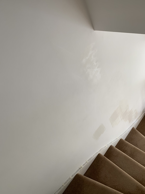

I have had a nightmare with touching up the walls in my new house.
When I moved in, I got some inevitable scuff marks.

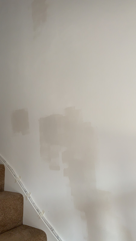

I went with his recommendation and started touching up, but the results are awful. The paint he suggested has a sheen to it, where as my walls do not. It now looks worse than before.
Homebase have said they will refund me for the tin of paint, and have offered to give me something else to try, but I think I will just go out and get a trade tub of the stuff above.
Can anyone tell me if I am going to need to sand these patches down now before I put the right stuff on?

It is never very successful just "Touching up" marks with paint even if you had the original paint you would notice a shade difference with the original paint coverage and the paint in the tin after a few weeks
Its best to paint the complete wall that has the marks, you may have been able to remove the marks originally using a damp cloth but its too late now you have applied paint

You shouldn't need to sand the Zinsser that you used. Just paint over it. The Zinsser painted areas will take longer to dry than the surrounding areas but that isn't a biggie.

You cant get away with touching up patches on walls they will always stick out like a sore thumb even if its the exact paint, I have been a Painter and Decorator for 33 years and would always recoat a marked or damaged wall.
