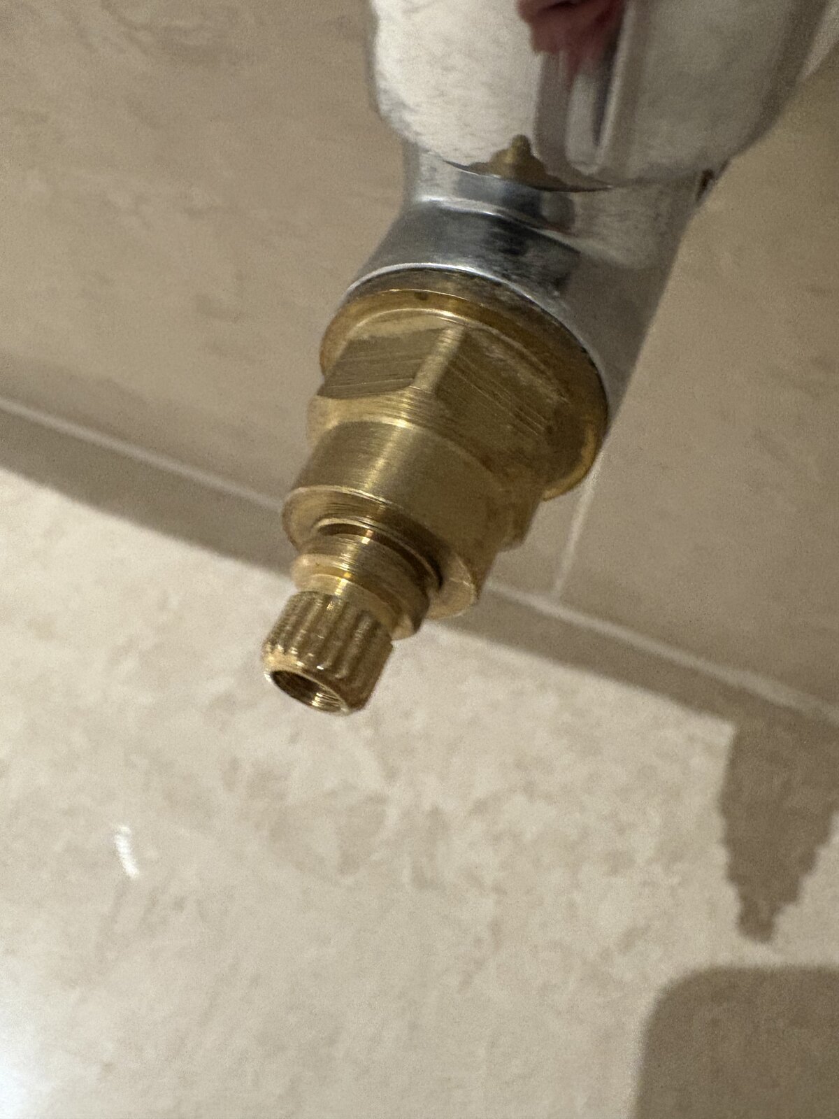

Hi all,
My towel radiator isn’t working. I have bled it and there is no air trapped inside. I have adjusted the valves and these seem to do nothing at all so I am thinking either one or both are stuck. The types of valves are a little different to what I’ve seen online so I’m not sure how I can try free them up. I have tried turning them fully clockwise, not working, and also fully anticlockwise still not working.
Any suggestions appreciated
Matt

To establish if valves are not working,close both of them. Then open the air bleed valve ,a little water should come out and then stop. Then open one of the valves ,water should stream out the air bleed valve. Close that valve and open the other one ,again water should stream out the air bleed valve.
If water doesn't flow out when a valve is opened there is a blockage or that valve isn't opening.

Inconclusive really. If you are telling us that water flows non stop from the air bleed valve on the radiator, irrespective of the two valves positions ,then one, or both of them ,must not be closing fully.
Are both valves the same style ? Does it only take one quarter turn to go from open to closed positions on those valves ,or does it take several full turns ?

The left one only does a quarter turn. When I turn it all the way clockwise, water drips out ever so slightly.
The right one takes many turns and goes fully in and fully out

And if you open that valve does water flow out non stop ?
Yes it’s a slow drip but it is constant. Does the fact that it drips mean that it is in the open position (even though fully clockwise)?
If you open fully clockwise do you get a constant,and strong flow of water from the air bleed valve ? If you do ,but you only get slight dripping when turned fully clockwise to closed position,then that valve doesn't appear to fully close.
