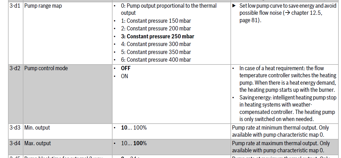

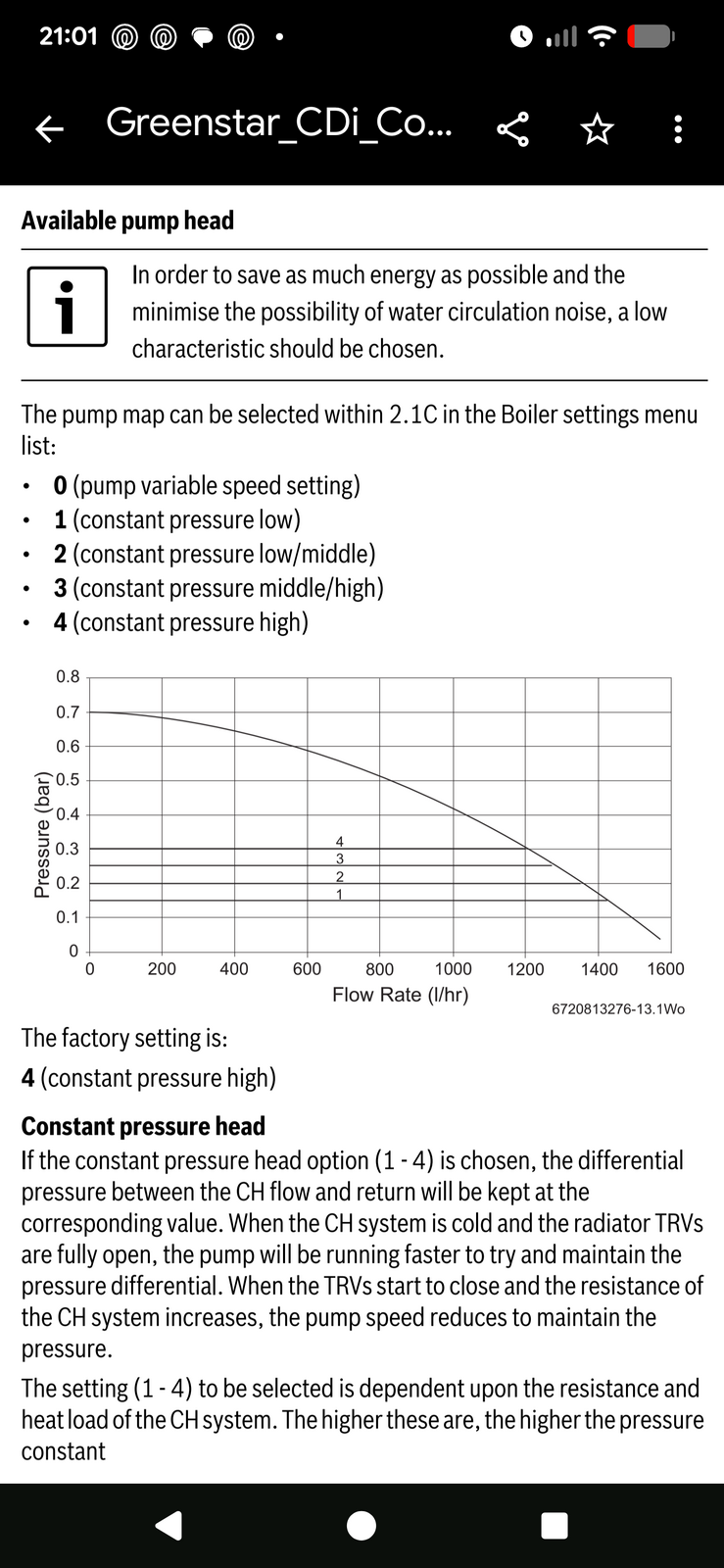

Have a look at your MIs, if you have a eCopy post it on here, your circ pump will/should have several options like the attached, you can see which one yours is set to, once you know that then its relatively easy to set up the ABV.

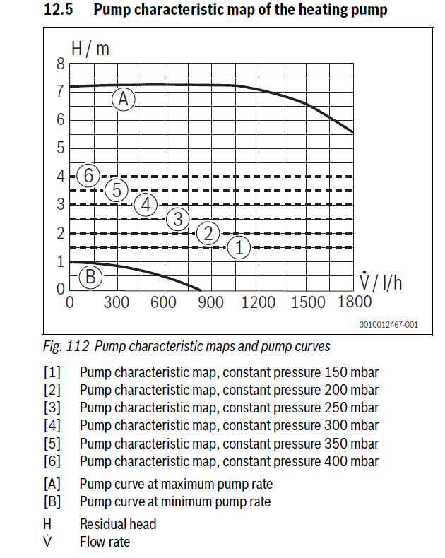

Yes, but a constant pressure setting shouldn't be used with a ABV as it depends on the pressure (head) increasing as the flow decreases which can only be achieved with a pump running at a fixed speed, option 0 is variable speed (depending on boiler output I think) but even though this can/should be able to be clamped at a fixed speed it can be difficult to figure out the settings, what you can try is, set/leave the pump on setting 4 which is 0.3bar, 3M, and set the ABV initially at 0.4 on its index, when the boiler is running and up to temperature the outlet (bypass to the boiler return) from the ABV should remain cold/cool, then very slowly keep turning the adjusting knob anticlockwise until the ABV outlet starts getting hot then turn the ABV adjusting knob clockwise say 1/2 a turn or so and see how it goes at that. Have you got a link to your particular boiler, if so, post it on please.
see above settings again

OK then, the only in theory "perfect" way is to open up all the rads (TRVs etc) to give full circulation, then check what mode the pump map is on, check the actual pump speed in %, then change to mode 0, 3-d1 which is variable speed mode depending on the boiler output, no good for your ABV,but you can "convert" this to a fixed speed, if the actual speed was say 60% with all rads open (and Hot) then set 3-d3 to 60% and 3-d4 to 65%, you then have, in effect a fixed speed pump which should make the the ABV setting up easy!!, however the fly in the ointment is the boiler's internal ABV, which may still open depending on the pump head so even though the rads flow and return may have a nice dT of say 15C to give reasonable condensing (if flow temp is 60C) the internal ABV might result in a boiler dT of only 7/8C reducing the boiler efficiency. IMO if your 2 towel rads don't have TRVs then those, together with the internal ABV should give adequate circulation with the external ABV shut off at index 0.6. Anyhow see how you get on, just note any pump mode/settings before making any changes.
