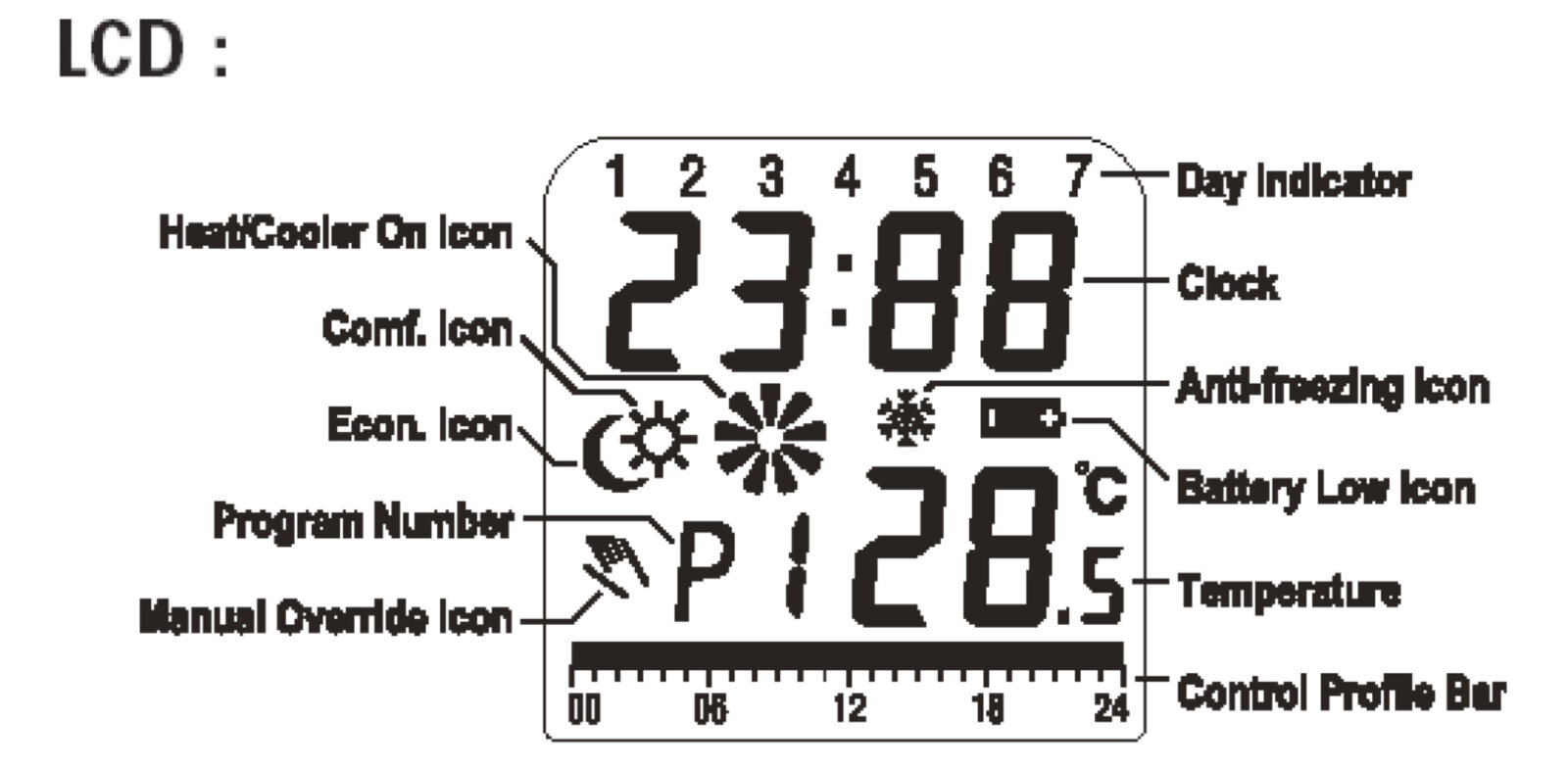

What fan sign ?
The three blade symbol in the middle of the transmitter display.
That is the comfort icon nothing to do with a fan, can you post a pic of the display of your actual stat so I can see what it thinks is happening

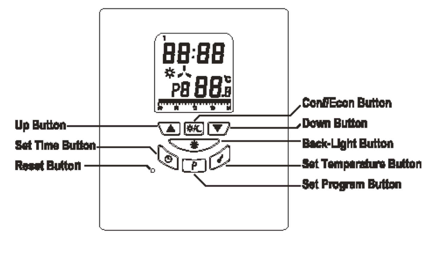

The instructions don’t seem to mention the 3 bladed “fan” icon? I’m wondering if it’s the heat/cool icon?
Comfort seems to be the sun?

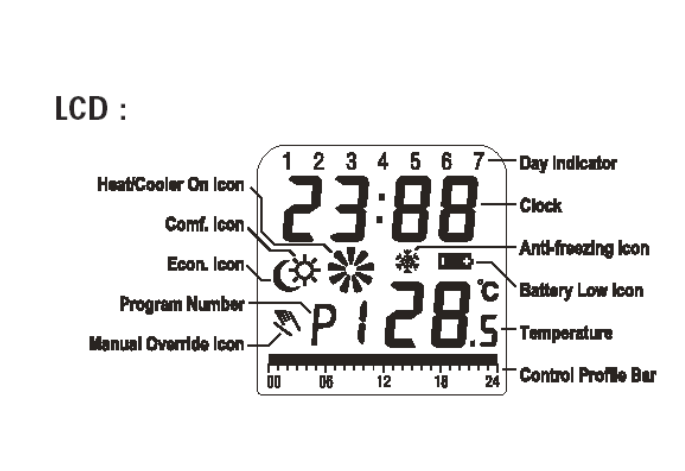

Yes, the sun and the fan mean two different things.
The fan symbol is when the stat is asking the boiler/cooler (as it can be attached to either) to do something. So for me, whenever the boiler fires (in the past at least) the fan would blink, then when the fan stops blinking, the boiler turns off. It's the fan turning off, and therefore telling the boiler to turn off that the boiler is not responding to.

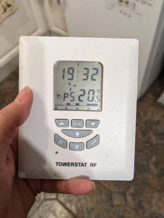

Does this help

Sorry, you'd already posted the display, for some reason I couldn't see it.
When it 'lights up' it shows as three blades sort of turning, not like on that picture. It's difficult to explain.
Great, can you post a photo of your display as per Ian?
Then would look like this when the boiler has reached temp, the fan turns off.
cant see any issues there, that is perfectly normal, if you switch the receiver to off does the boiler stop ?

Can only be a communication error,or a faulty unit, your settings are all correct, when you took the batteries out to replace them , did the reciver stay on ?
