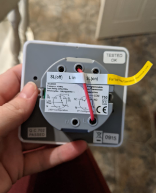

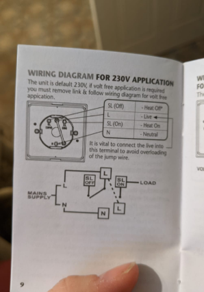

Likely 5 wires on hard wired bit, maybe 4 and a link. To me easy, but hard to say how you would find it. So your looking for either replacement programmable thermostat using wifi or hard wired, so step one is work out best option, step two is work out what is the best compromise between best and what can be easy fitted.
