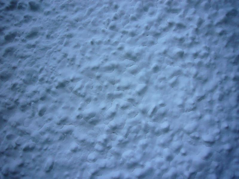

Hi there,
My decorator is using the above paint watered down however as it has dried it has cracked. It looks like it has dried unevenly. My pebbledash is very stony
Has anyone had this experience?
Is it common?
What should decorator do about it now?
I dont know if this paint always does this on pebbledash?

I should have given more detail. The pebbledash surface had been previously painted and the decorator had watered down the paint that he applied.

Need a lot more detail than that, such as - What was the previous coating / what condition was it in / what was it washed down with / how long was it left to dry / how many coats of the "watered down" paint has your decorator applied / how much are the pebbles raised, is it deep / are the "cracks" below the top level of the pebbles or is it all over / has the job been finished / is it at eye level ?

previous coating was done about 6 years ago and was dulux weathershield.
It was in reasonably good condition, just losing its whiteness really.
I dont think they washed it down at all, some of it is at first floor level.
The pebbles are very raised, They are quite coarse, maybe 8mm high variance from base.
The cracks are forming between the pebbles and have the appearance of a skin that has split. It varies over the surface, in some places the cracks look worse.
As it is all over, some of it is at eye level.
The painter has put a second coat of even more watered down dulux weathershield which I will see tomorrow.
The annoying thing is my neighbour had homebase weathershield put on the same pebbledash and it hasnt cracked at all!

He might of chucked it on too heavy and it dried too quick in the warm weather

This sounds a classic case of ''mudcracking'' Where the paint has been too heavily applied and not spread out properly. Difficult really, I go over each finished section with my roller which has been rolled dry of any paint on next section, so that my now dry roller will pick up any puddles in the crevacies.

I called up the technical helpline and they say it is a common problem that occurs with pebbledash. There is a tendency to apply it too thickly and then when it dries it cracks.
The solution is they say to put on watered down layer, really pushing it into the cracks.
I can only imagine that this will take 3 recoats to correct.

I think the replies have answered your technical question. The paint was almost definitely applied too thick and has subsequently cracked.

Any chance of a picture?

The problem is adding more waterbased to try and fill the cracks will make the thick paint wet and on drying will crack again. I didn't agree with dulux advice lots of years ago to carry on giving more and more coats (well it's good business for them eh)
I maintain That to stop the thick and cracked crevacies from cracking again then a non water based product should be applied, Dulux all seasons solvent based springs to mind.
My own remedy actually, when I have to sort out fried, cracking masonry paint is to apply a coat 1/5 of Pva. followed by one coat of waterbased... perfect finish. I can hear the howls from you fellow deccies lol but I have done this several times and can show these jobs 4/5 yrs later and still sound.
