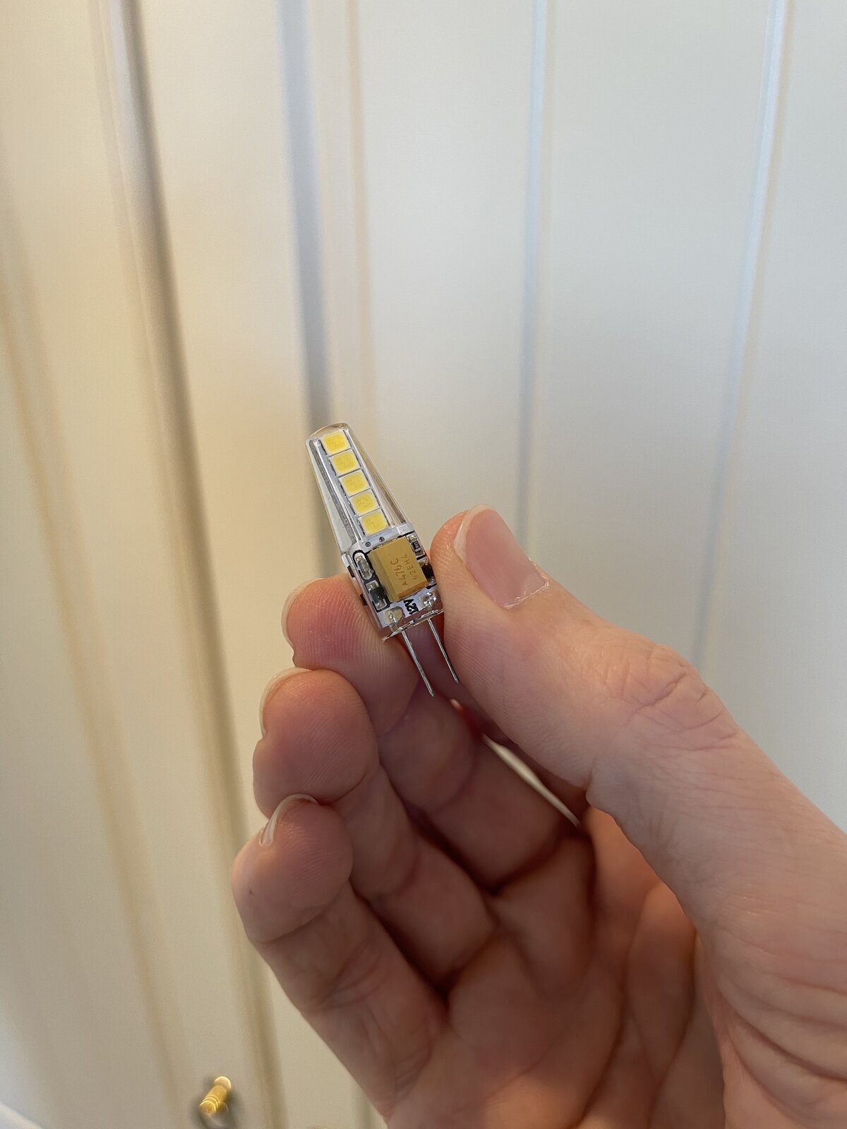

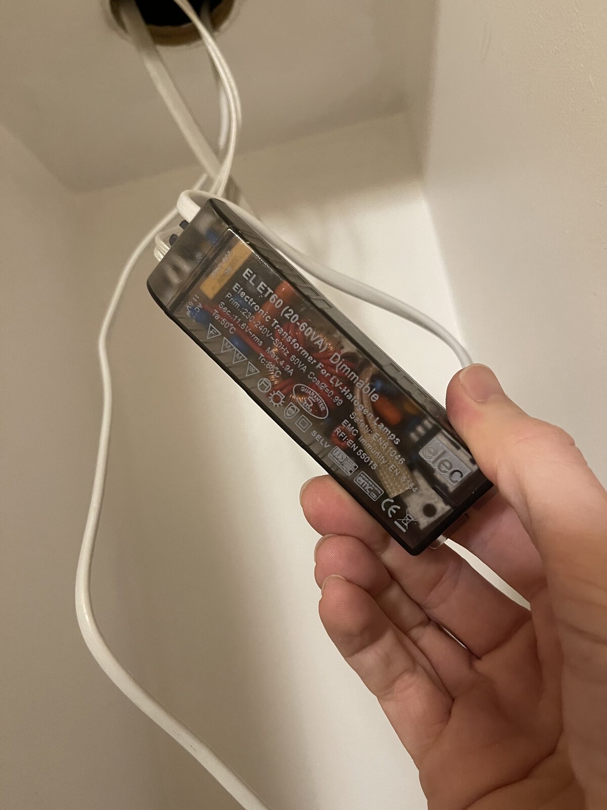

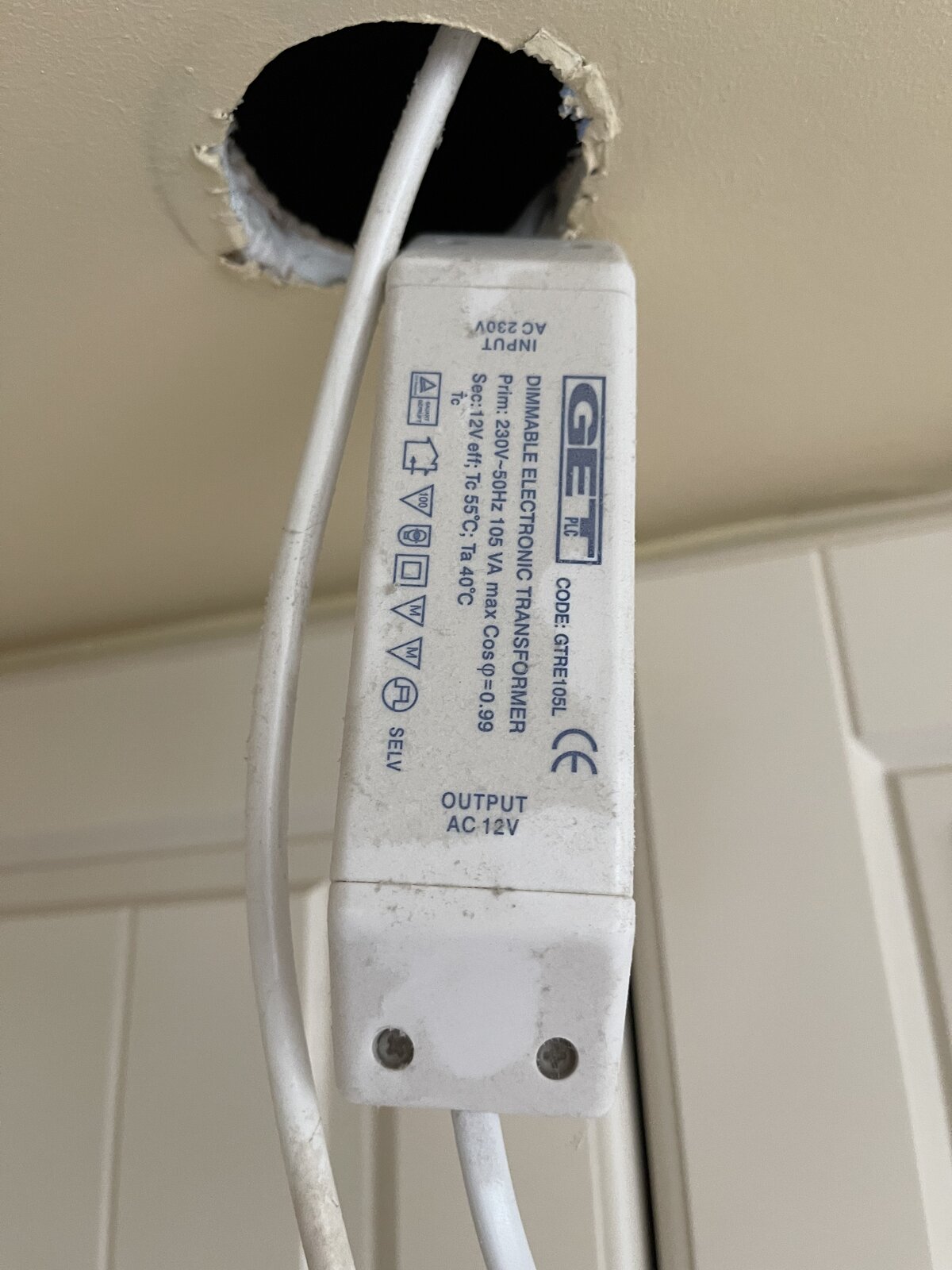

Hi guys, I’m changing my 3x old 20w GU 5.3 halogens to 3x 3w LED GU 5.3 . This is the old transformer GET 105va but wanted to check if it can still power the new bulbs or will I need something smaller?

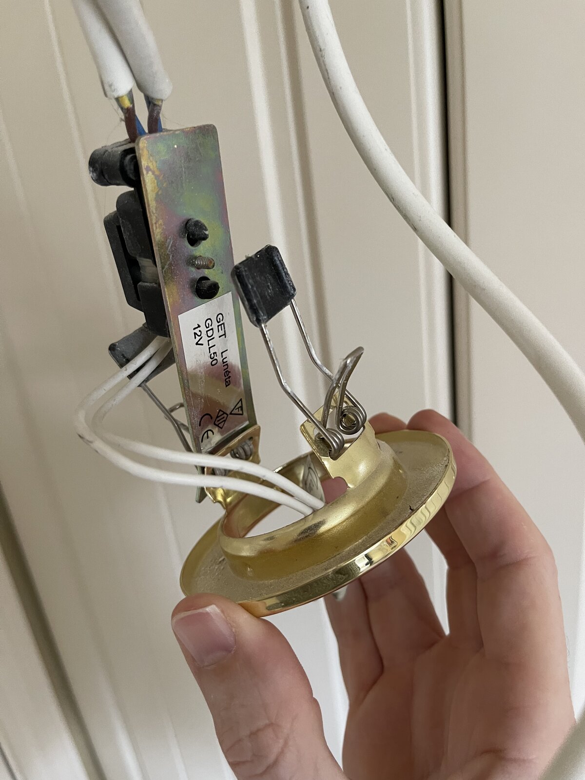

Also, there are 3x G4 display lights that run on a different transformer all off the same Circuit. Now the led bulbs work ok but I think the transformer is to high as if you put 3x leds they are very dim. Could I run all 6x off the first transformer?

One electronic transformer clearly marked 20 - 60 VA so needs a load of 20 watt, other one says 105 VA max only and some electronic transformers can go down to zero. I was lucky I had toroidal transformers so not problem, in your position I would try it first and see how it works.

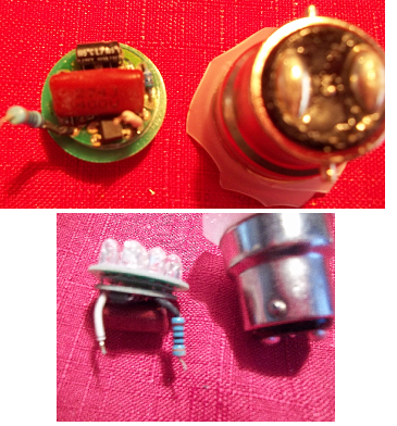

Cramming the cheap, mass produced driver into the bayonet cap of a standard lamp does work but some designs are not very reliable.
This is the driver from 1 watt LED lamp (15 elements in series) and hence less than a Watt of heat to dissipate from the bayonet cap into the lamp holder.
Dissipating 10 Watts into the cap can result in high temperatures in the cap.
