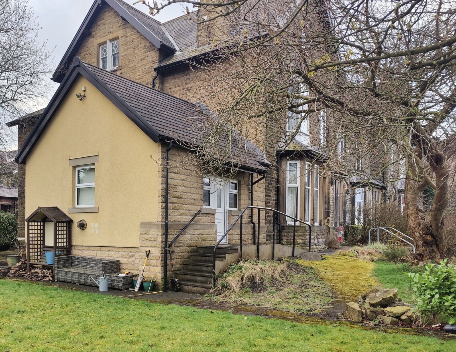

Had a drainage survey last year which found tree roots in the (mainly) plastic pipes at the front of the house. The downpipe on the right takes a little bit of rainwater off the original front bay window roof.
The other 2 downpipes take rainwater off the front single story extension roof approx 15m2 area at 40 degree pitch (built 20 years ago). Original plans show a soakaway at the bottom of the steps. There is a Cherry tree near bay and larger mature trees near the boundary with road - Sycamore, Ash, Horse Chestnut etc.

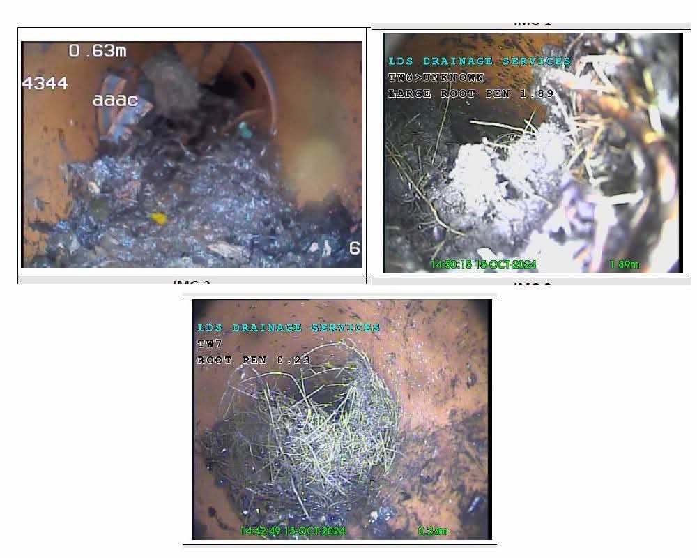

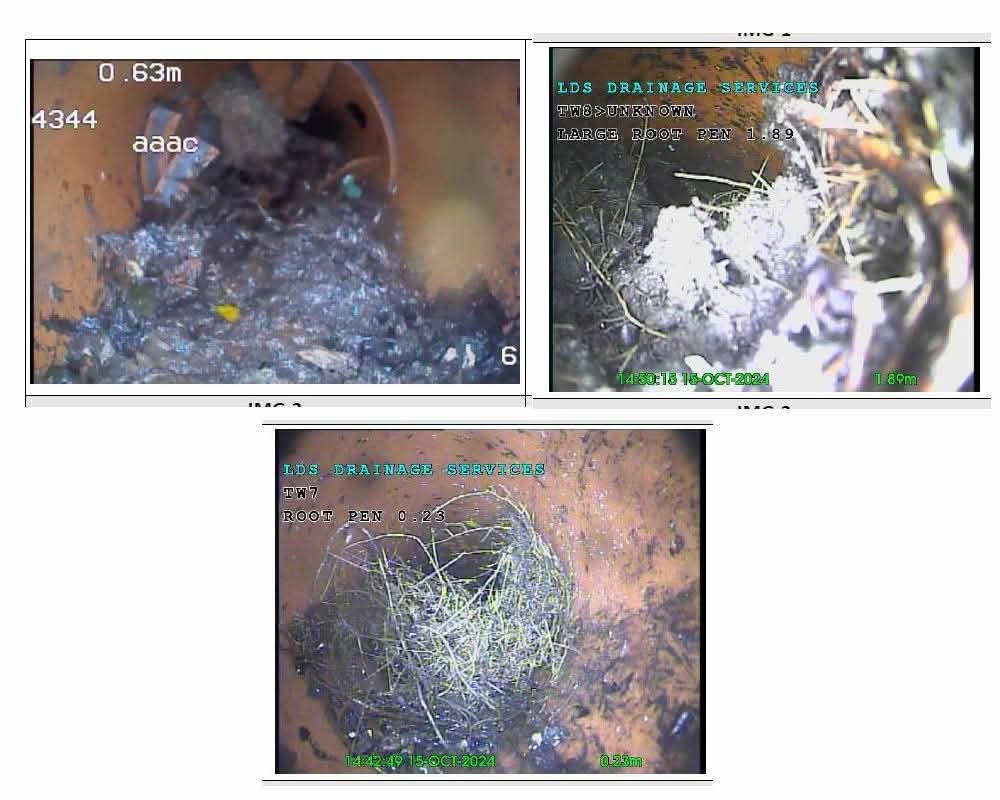

So you think as the pipes are usually pretty long the roots could have come from the opposite ends? I have pictures on the original drain survey and saw the roots live on CCTV they did say they thought some could have come from the far end of the pipe.
I've attached the drain survey pictures, top left is the bay window..

Looking at the photo's, top left is 'Supersleve' clay pipe, which is the more modern version of clayware, that section is knackered, only real option would be to replace the damaged stuff. (If DIYing, treat it like glass, broken edges can be razor sharp.)
Top right, not quite sure there, some root ingress but looks like some soil/silt also there, wondering if that is broken/collapsed nearby.
Bottom, some small roots, but doesn't look enough to impede flow of water or a camera for that matter.

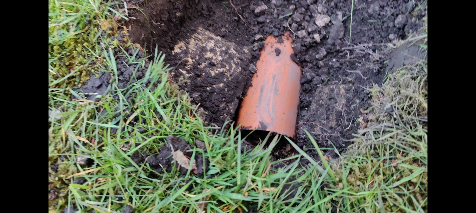

Hi @Hugh Jaleak I put on my big boy pants the other day and did some digging..
The plastic pipe that takes the majority of the rainwater just goes directly into the ground next to the raised paving. I actually dug a lot of this area out one year as it was full of clay, bricks, stones and other rubbish - so as a flower bed useless as nothing ever grew.
Anyway there was a big root (right hand side) next to the pipe/wrapped around it - might be inside it on the back of the pipe - unsure, the end of the pipe was just full of muck. I assume this is what has caused the paving to slope over the years as the water is not really going anywhere?
The other pipe that goes towards the grass, ends a very short distance onto the grass, it had some pieces of stone on the top and the pipe is sat between some sort of concrete benching. There's large chippings around the pipe but it was basically blocked up at the end. The water does drain away but probably backing up in heavier rainfall, the bottle gulley had an open connection in the back which I'd blocked with a rubber test bung but apparently that's fallen out, so explains why the wall is showing wet after rain.
Anyway I've no idea how much depth the chippings have but they don't look like they would be doing much. It's really close to the extension.
I'm not sure if it's worth doing any more digging or just look to a modern crate style linear soakaway 5-6m away from the extension, wrapped in membrane (not the bottom section)? with catchpit for peace of mind. Doing the digging for circa 3 hours really took it out of me and I got ill for over a week at Easter!
Methinks someone couldn't be bothered to do the job right when those drains were laid. I think its time probably to bite the bullet, and sort it out properly, but at least now you know what you're faced with.
There is going to be a fair bit of digging required, it seriously isn't worth making yourself ill over it, and I think you're pretty confident of what you need doing, so I'd be drawing up a spec and asking interested parties to quote for digging and building a crate soakaway, and connecting up existing drainage to it as required.
Note as rainwater going to a soakaway, the downpipes can be directly connected to the drain, although given the proximity of the trees, I would strongly suggest gullies are fitted at the base of the downpipes to catch any leaf debris, or other detritus and prevent it reaching the soakaway.
