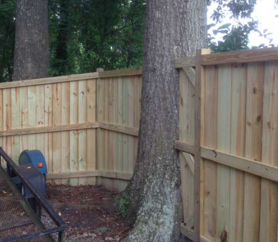

There's nothing that says there must be a fence between properties. Or that it must be continuous or meet any level of security. Unless you or your neighbour want it you could just live with the half grown hedge. If you have a dog then you are responsible for making sure it doesn't go into someone else's garden, but that's the dog owners job, no matter who owns the fences involved.
If you do decide to build a new fence, on your land, then anyone who buys next door has no right to do anything to your fence at all.
Or, just stop the fence before the trees and start again afterwards.
27 Apr 2008
9,092
794
Like this:
Image supplied by google.
