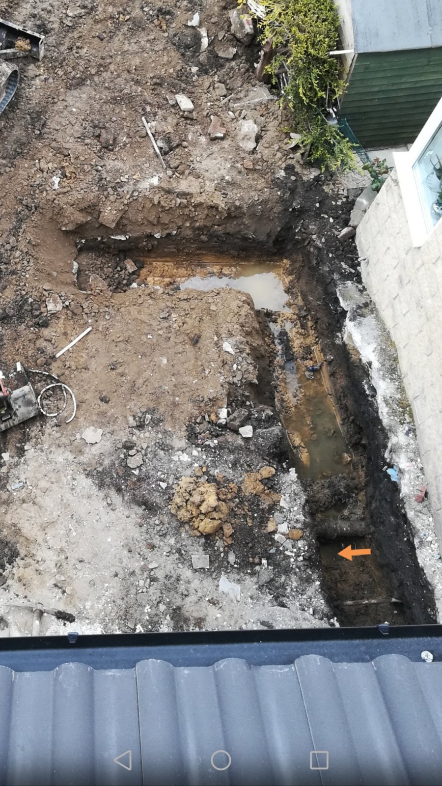

Hi. I've had trench dug out for single storey rear extension.
Water is filling trench up. It seems to be ground water. What's best way to deal with this? Had 1 foot of water over 24hrs for 4x5m trench.

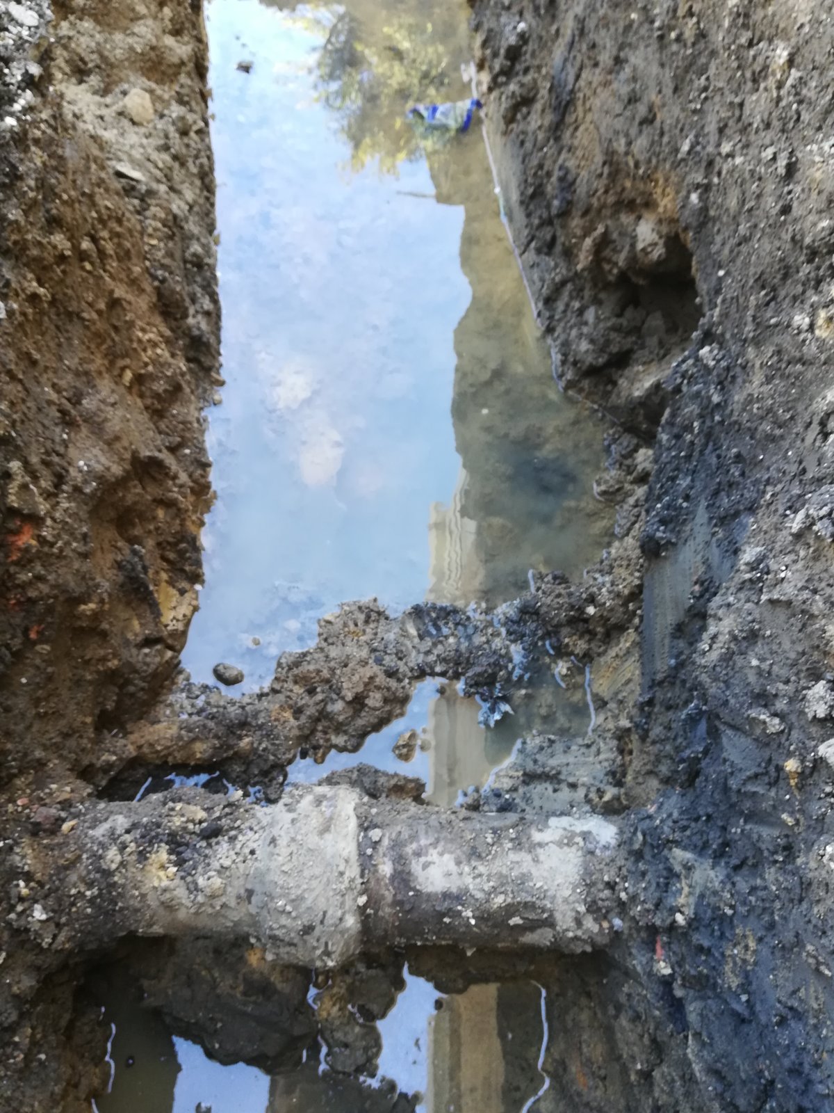

Also sewer pipe is cracked underneath and is slowly dripping.
That’s a lot of water. You would need to dig a corner out deeper and put a pump in.

The pipe may be leaking at a faster rate than a drip now and again?? can you discharge a load of water into the pipe and see what happens? it will need to be repaired???
Second thing, it appears on your image No 1 that there is a layer of what looks like DPM ?? could be that the DPM is catching a load of water over a fairly large area and dumping it into the trench??
Ken.
Hi. Yes there was a patio area there. About the "dpc" it was topped up with hard core. The water is coming out from below the dpc sheet below pipe. It's on the inside part of trench.
It can't be toilet water since there is no bathroom for last 6 months. Also water has not been on for 6 months.

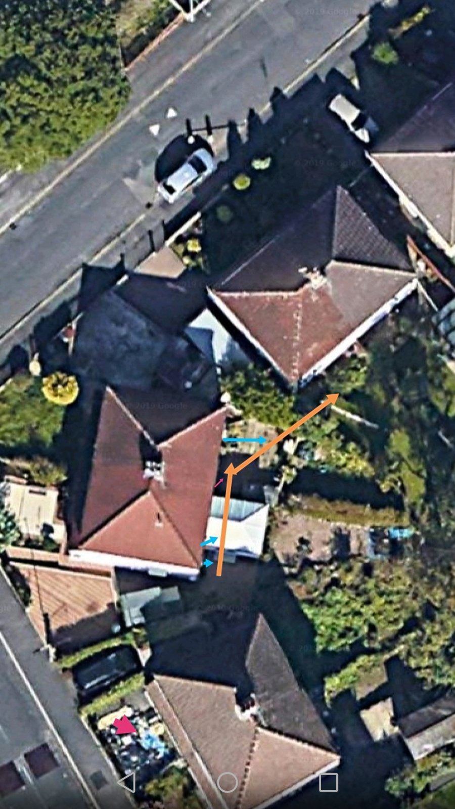

The trench was only dug out yesterday. The water is pretty clean, doesn't smell, so don't think it's soil water. That pipe is a public sewer. It runs from neighbour property to mine then to neighbour lower down.
OP,
First thing is to fix the leaking pipe - so wash clean the exposed pipe and determine the cause or causes of the leak. Search for other cracks, & then fix the pipe. Do you know how?
At the moment, where the leak water is coming from is irrelevant.

Thanks for replies. Not sure about repairing the pipe. It only drips sometimes. And it's quite slow. There is a small crack underneath collar. How would you repair this?

The water built up over time. It is constant flow. The source is about 10cm to 15cm below the pipe where arrow is in photo.
Don't understand about house being on made up ground. It's 1930s build. But garden could have been raised up. 5 metres away from back wall is a 700mm drop as garden was tiered.
Pink is where water is coming out from.
House is on a slope.

Dont attempt a repair - replace it. A small re-leak over a period could wash away part of your foundation.
Use a large angle grinder to cut the pipe say 300mm either side of the hub, and two flexible rubber pipe connectors (no-hub fittings) to tie-in a length of clay or plastic same ID pipe.
A plumber would make short work of the job - & sewage is considered an urgent repair.

Just seen your earlier pic/post: and you are on made up ground ("garden raised up" means its made up) - not good news for an extension unless you dig deep, which would be difficult slap bang next to another foundation/extension?
And you are receiving more ground water than usual because of the hillside site.
