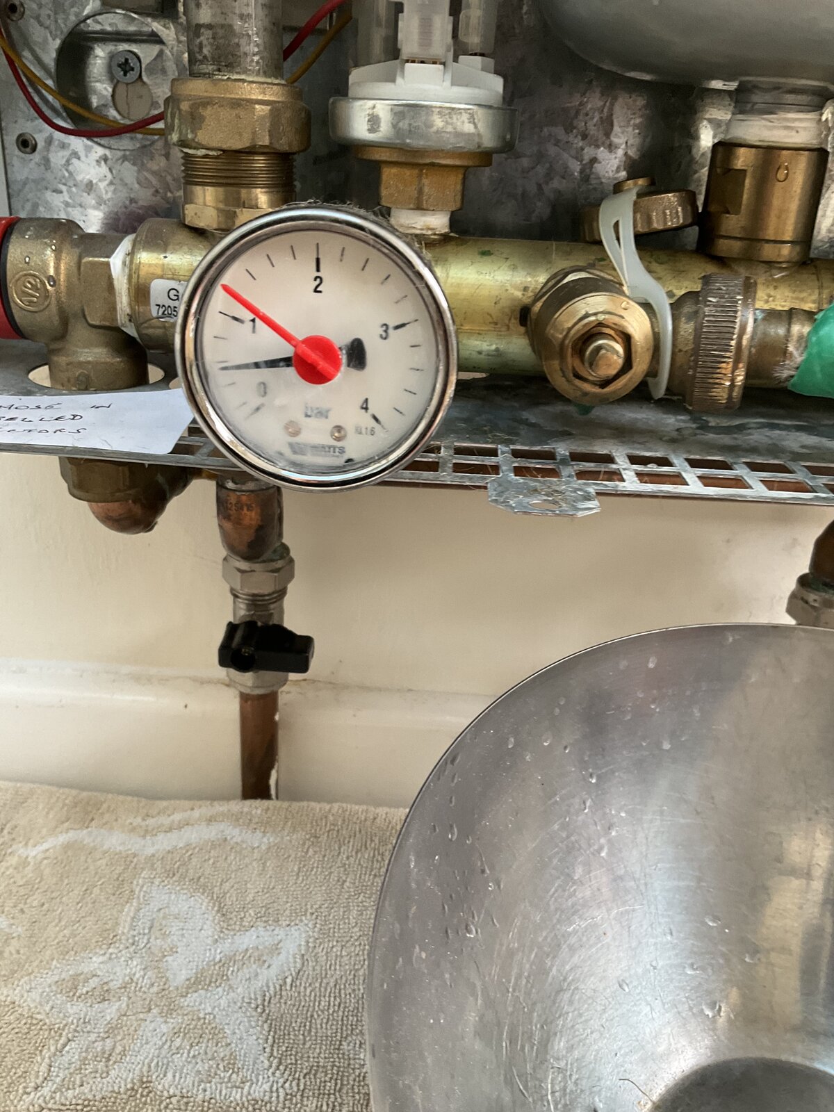

Before doing that I opened the isolation valves and noted a slight rise in water pressure really slight but a rise not a fall so that’s not likely to be the source of any leaks. Prior to drain down I noted then the pressure was still 0.8 bar as it had been since early morning so I think therefore that the PRV is not leaking and there’s no evidence of water anywhere around the unit.Clutching at straws, but there’s no water in the system and the pressure guage is not showing zero, see attached. Could that be causing me to fill to the wrong pressure in the first place I wonder?

Tap the gauge, they sometimes stick. I wouldn't expect the system to lockout until it dropped below 0.5bar not 0.8 bar, so the gauge may be a little sticky. If the EV still has 0.8 bar in it on a depressurised system then chances are the membrane isn't compromised but yes if you leave it overnight and the pressure stays the same then the EV.

To eliminate things I’ve ordered a new pressure gauge should arrive tomorrow. Having tapped it, the needle doesn’t budge, so probably best to have one that might be more accurate. I’ve had a go at removing the EV but it won’t budge, so I’ll have to use an oil filter removal tool or a strap to get it moving. Reading other blogs it seems that EVs generally only are good for five or six years, so after 13 it’s probably best to change it if I can find a replacement even if the pressure appears to be holding. It’s well sealed in with ptfe tape.

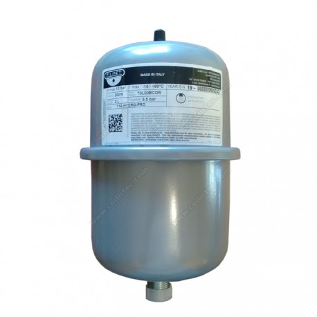

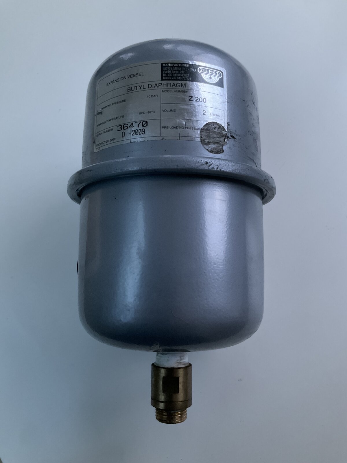

EV now removed see photo. It’s a zilmet unit appears to be still available so one has bee ordered. The unit unfortunately brought part of the fitting with it so will wait for new unit arrival before attempting to remove it. It was well lodged in to it’s fitting, but removed without damage using an old engine fan belt.
Contemplated ordering two units but that might be trusting to luck.

A question. The replacement EV arrived this morning and the shipped pressure was 3.7 bar. The EV that I removed shows 1.0 bar after 48 hours. I’ve just upped it to 1.15 bar and if that is still holding after 48 hours would it be best to re-use it or fit the new one which is from Italy?
I’m attempting to source a new pressure gauge as when at zero pressure it shows 0.5 bar so not helpful.

Well if the EV is holding pressure without loss, off the jig, then there can't be anything wrong with it. Wouldn't be any reason not to re-use it IMO.

Thanks, I think the original problem was the EV as there was at the time zero pressure in it when tested. As it’s holding pressure when outside the boiler as you say it’s probably good to re-use. On another thought I am trying to source a pressure gauge as I think that maybe, as it reads 0.5 bar with no pressure in the system has led me to set pressure too low and when the water cooled it dropped below the “low pressure” alarm threshold. There’s no indication of any water loss in the underfloor pipes though otherwise your conclusion seems right. Bit of clutching at straws at the moment. Anyway ripping up the concrete floor is definitely not a way to go and when put in I insisted that only one continuous length of butyl pipe was used to minimise the likelihood of leaks.

You want one of these - Trianco Gauge - 501808 (0-4bar 1/4" BS 557-2) - https://bhl.co.uk/pressure-gauge-557-2-0-4-bar-14-bs-trisp501808.html
Yes it arrived this morning but the rear thread is too small it’s 1/8th mbsp and the very helpful man from Watts suggested getting a boss as the unit I’ve taken off is 3/8. Watts have the one I need but it’s from Bulgaria minimum order qty 300 he suspects.
Just spoke with BHL thanks for finding that brilliant if it’s the correct one. I did speak to the Trianco spares person earlier in the week but he wasn’t very helpfu. Anyway if Neil from BHL can confirm the rear thread is 3/8th bsp (very unusual) and probably Monday now then I can order it and you’ll be my hero.
