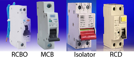

However first what is tripping? PartID_CU.jpg Using RCBO's to use a dedicated one for the Boilermate should mean nothing else will affect it, a RCBO is a MCB and RCD combined, but with the MCB you get multi MCB's fed from one RCD, so adding another will not really help to stop RCD tripping.

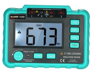

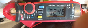

We have three tools, the RCD tester RCD tester.jpgis used to see the RCD is doing what it should, the insulation testerVC60B.jpgis used with the circuits dead to check for leaks, but it used DC so will not pick up leaks due to capacitive or inductive linking, so the clamp on Testing voltage.jpg tests the circuit does not exceed 9 mA with a 30 mA RCD. It would seem likely the fault is a neutral earth fault, as with these the more power used, the greater the leakage, and the problem is some thing plugged in even if switched off can cause a earth - neutral fault, so bit of damp toast in the toaster can trip the RCD when the kettle is used.
However with the tools shown an electrician should quickly work out faults like that, so assuming the electrician both knows what he is doing and has the correct test equipment we must be looking at some thing unusual.
