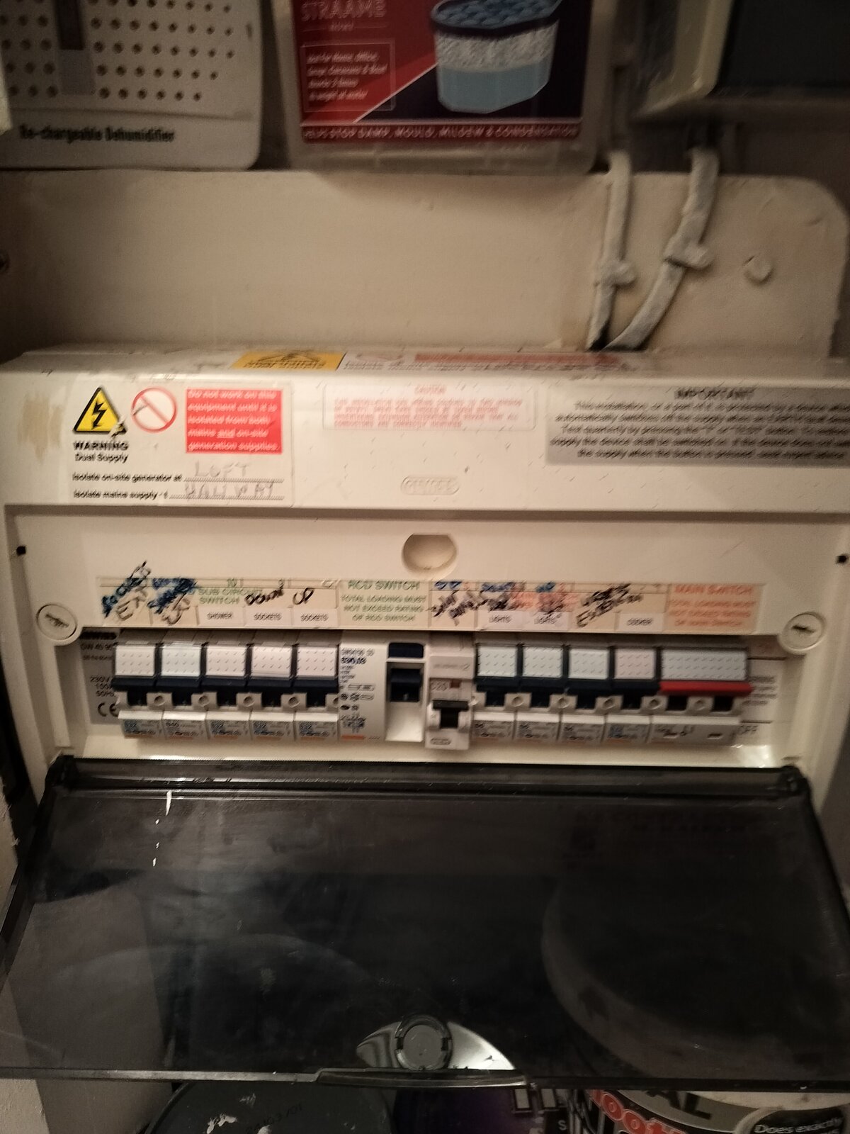

Thank you so much for your reply...I do have two way switch for my upstairs and downstairs lights in the hall with the outside lights running off the upstairs lighting circuit. Please see picture of my CU
It's the RCD in the middle that is tripping.

It's too fuzzy for me to read. You may need flash.
Do you really have an on-site generator in the loft? Is it solar panels?
Show the surrounding cables please.

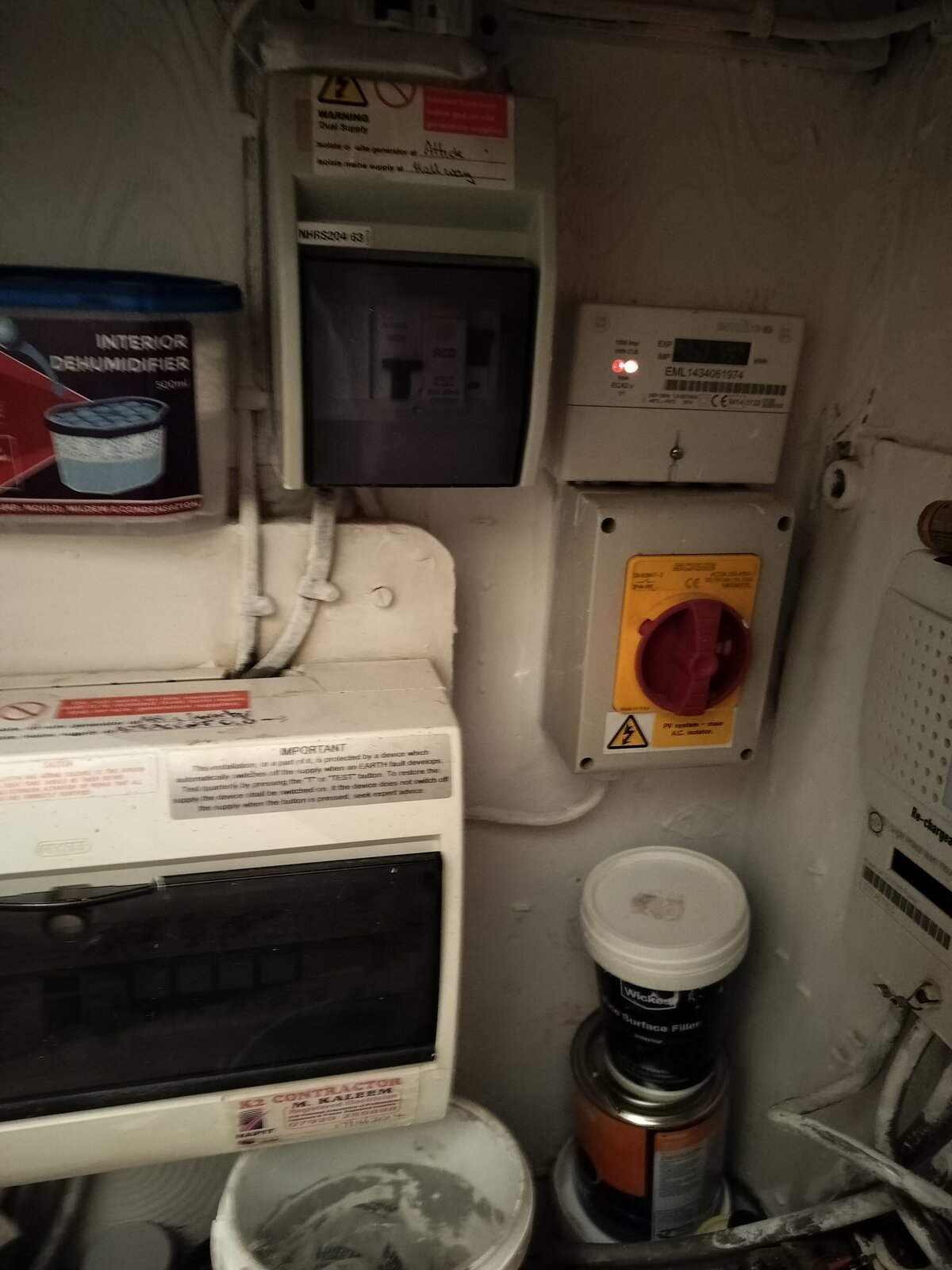

Other wiring in the cupboard

Thanks John..best I can do with my phone. Sorry. I'm pretty useless. The other thing you ask about are my solar panels..the second spark says they are protected by their own RCD... install done by a very good company, all certified and no problems since 2013.
I will try to do the better marking
The second electrician said some of the wiring was not congruent with the numbering and changed some of that..

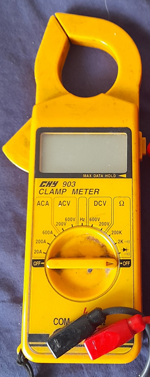

We have three tools to help us, one the RCD tester RCD tester.jpg it is to be far not that common to find a faulty RCD, and I don't really trust the testers, so I would swap RCD if could not find fault. The next in or arsenal is the installation tester, VC60B.jpg these use 500 volt to find faults, and is the main tool for finding faults like you are reporting, but these do have a small problem, they test with DC, so leakage due to long cable runs and inductive or capacitive linking can be missed, so we also have the camp on ammeter Diffrence line neutral 8 Feb 24 reduced.jpg this does show the total leakage, but will not work once the power has tripped.

The RCD should not trip at ½ rated value, but must trip at rated valve, and back ground leakage should not exceed 30%, also we are only allowed up to 3.5 mA per circuit without special earthing arrangements, so the clamp on shown is showing 8 mA for whole house, if using a single 30 mA trip would be allowed 9 mA, opening up the CU I would not expect any circuit to exceed 3.5 mA however for many years my clamp on, 1724194672384.png would only measure 10 mA on the first increment, what I hoped was if it did not trip at 15 mA the tester used, to test the ½ rated value, then likely less than 10 mA leakage, in real terms I was crossing my fingers. I do wonder how many electricians cross their fingers like I did?
But in the main they will have the insulation tester, and a reading of over 1 MΩ at 500 volt normally means there will not be a problem. The first meter is expensive over £100, the second two, I paid £35 each for them, the fourth I bought in Hong Kong for around HK$ 150 so around £12 before the Chinese take over.
One would hope when it's ones business one would have something like this,
which is not what we would call a multi meter, although technically I suppose it is, but without the tools unlikely to find the fault.
Hi and thanks. No clamp on meter used but the multi meter looks a bit like your last picture and he told me it cost upwards of a thousand pounds. Just utterly stressed about being unable to fully isolate it as to be fair, was this ast man who worked solidly and to my untrained eye, methodically, doing something, then testing...doing another thing, then testing.
