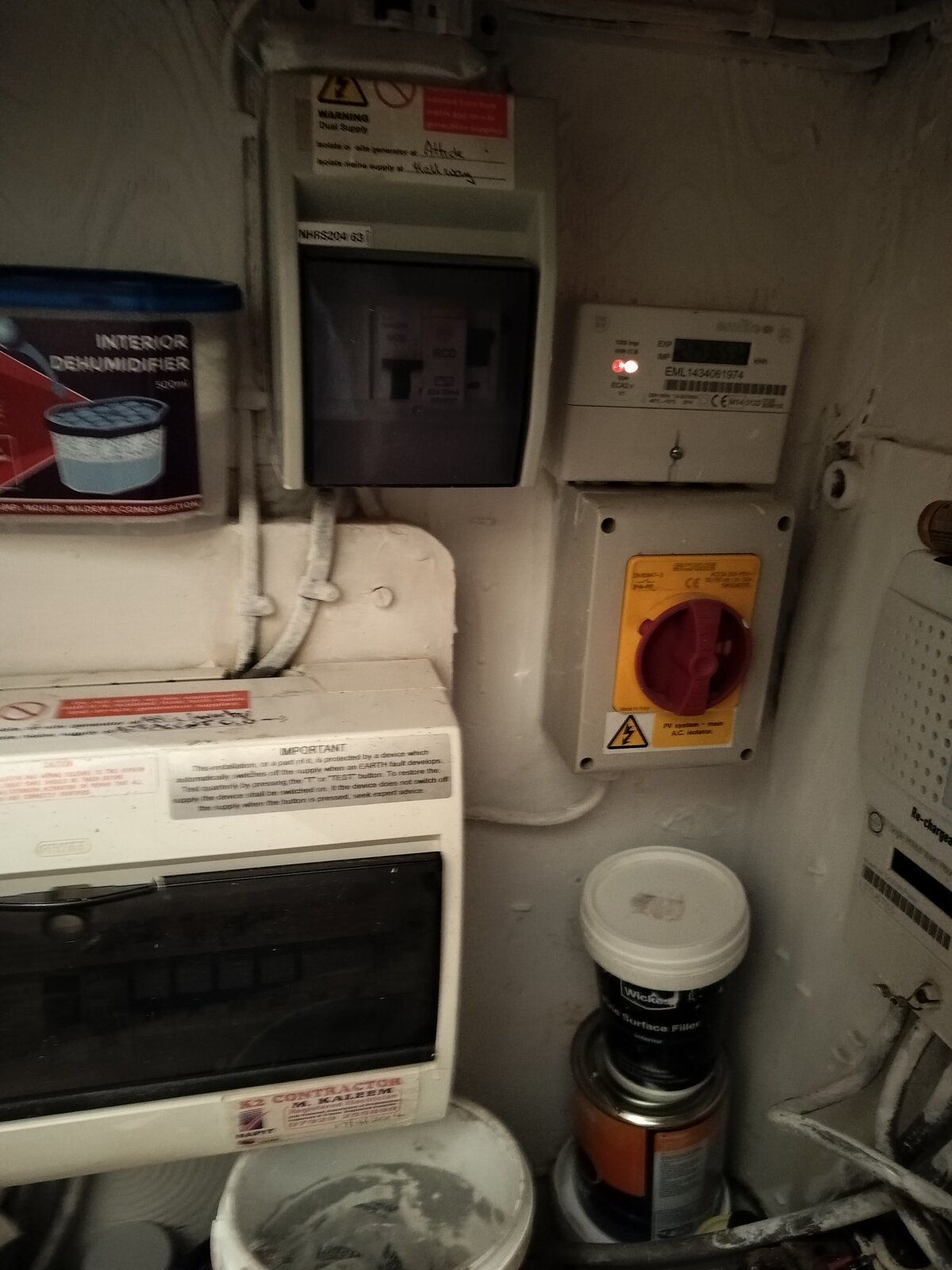

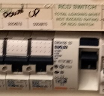

That was also my thought, I have looked at this picture 1724498329198.jpeg and to the right that looks like a smart meter, but there is also a meter above the isolator, I also have two meters, one smart and the other to measure solar export. I also see a RCD at top of picture, this
and this
have me wondering what is in the home, and if we have other things switching on at night?

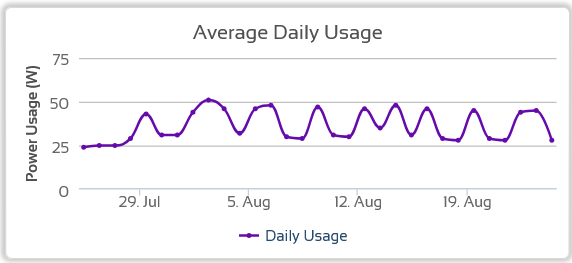

I have been monitoring my own upright freezer 1724498798312.png the spikes are when it auto defrosts, 29-7, 2, 6, 9, 12, 14, 16, 19 and 22 of August, so every 2 to 3 days. If the heater was faulty for auto defrost, it would seem rather random as to when it trips, and resetting in the morning, could mean next defrost happens at night.

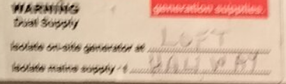

I am sure there is solar as it shows this
so could the inverter be leaking DC and freezing the RCD in the day, so it will only trip at night? I note type AC RCD.
If some thing easy the electricians would have found it, so looking for some thing less obvious, I have tried measuring DC leakage, the clamp-on has to be zeroed with DC, and change orientation just slightly and one gets an erroneous reading, I could not easy measure 6 mA, at 60 mA OK reasonably sure good reading, +/- 10 mA, but at 6 mA DC my clamp-on meter is a bit hit and miss.
Be interesting to hear how others in the trade get on at measuring DC leakage. AC my clamp-on meter is great, down to 1 mA, but DC using the hall effect it is a little hit and miss.
My inverter says it is OK with a type AC RCD, but that does not mean all are.
