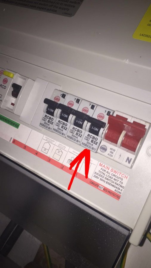

Hello,
Recently after running the shower for 5 mins, it trips out . If I reset it via the fuseboard it will again run for a few minutes before the same happens again.
I'm a little concerned re. the safety of this so any advice would be greatly appreciated.

I've attached a pic of the switch which keeps tripping.
It's a 40Amp shower on a 32Amp breaker, so of course it is tripping. It's overloaded.
The cable may also be too thin to carry 40A without overheating.
This often happens when somebody replaces an electric shower with a more powerful one without understanding.

Previous owner must have I guess. Is it possible to put a 40Amp breaker in place of the 32a one?
The 9.5kW is probably quoted at 240V, which would equate to about 37.9A at 230V.
A B32 should never trip at below about 36A (32A x 1.13), and would trip within an hour at about 46A (32A x 1.45). Indeed, the curve for a B32 in the regs shows it never operating at 40A, at least, not within the first 10,000 seconds (about 2.8 hours).
I am therefore far from convinced that the OP's RCBO is tripping 'in minutes' due to the OPD part of its functionality.

It worked fine for a couple of years until the past few weeks when it exhibits the behaviour I mentioned.
To your point, isn't that working on the assumption that the cabling is sound? I'm going to get someone in to test it.

That's consistent with what I just wrote. Even though one shouldn't overload a device (like your RCBO) 40A through a 32A RCBO should not trip in minutes. So, either something has happened to the shower or the RCBO as become faulty; the former would seem more likely.
I very much doubt that anything has happened to the cable to cause what you are now experiencing. The reason you need the cable inspected and tested is to determine whether it is adequate to support an upgrade to a 40A or 45A RCBO (which is what you should have).

An MCB that's been intermittently overloaded for "a couple of years" might no longer be within spec, so it could now be tripping at a lower current than expected.
That's certainly a possibility, even though the degree of overloading is not all that great.
As has been said, the important thing for the OP is that he should get the wiring checked by an electrician to see it is suitable for upr-rating the RCBO to 40A or 45A, so that he can hopefully avoid continuing to run with an overloaded (even if only a little) device in the future.
