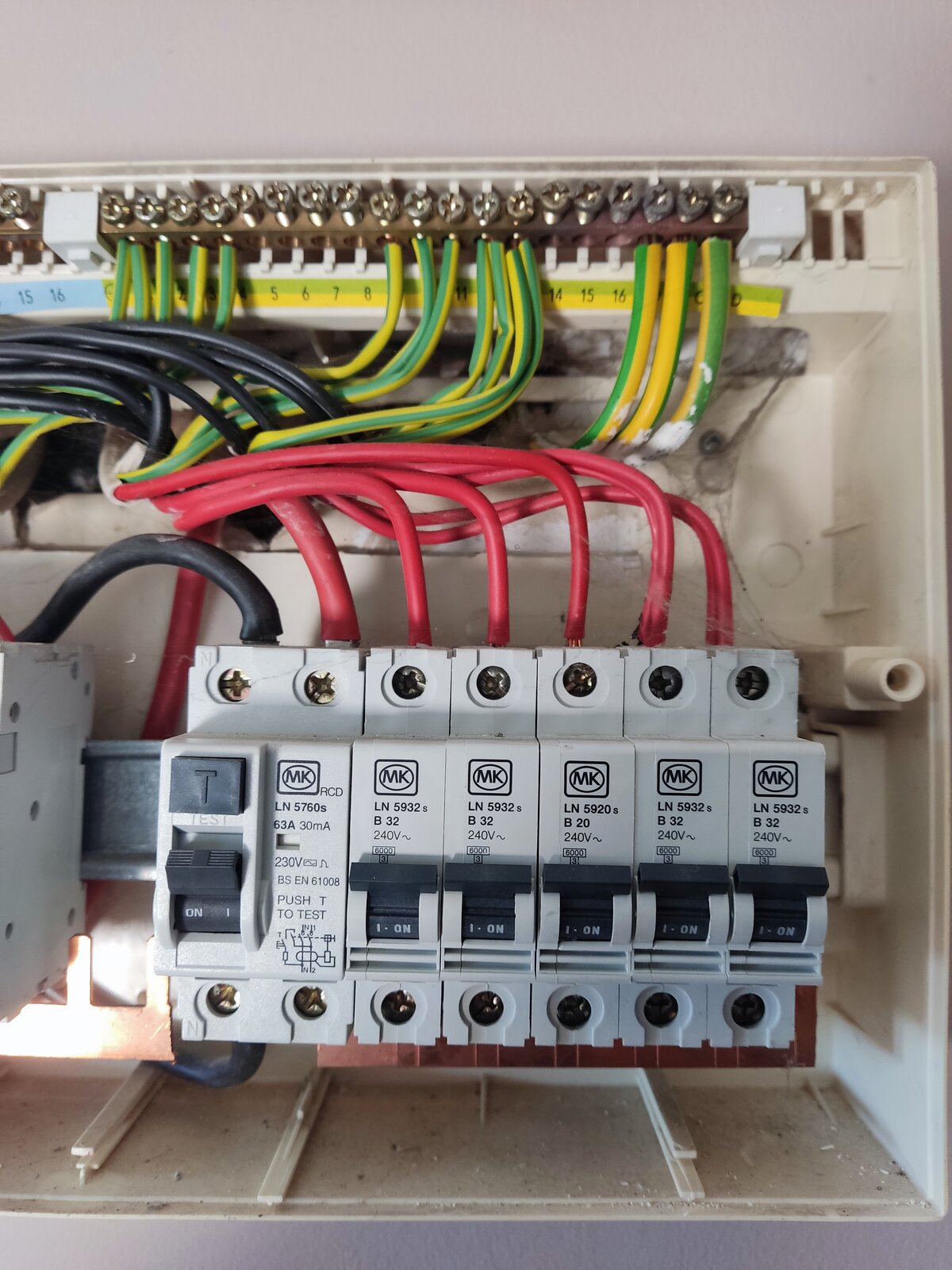

I have a Triton Enrich 8.5kw electric shower, my son was using it today and I just happened to walk by the fuse board as the shower was on and it was making a substantial buzzing noise from the 32A MCB.
If I push upward on the MCB the buzzing stops.
Once the shower had dried out I've had the front of it off to see if there's anything obvious but couldn't see anything.
There is also a buzzing from the shower unit now, but the MCB is a lot quieter.
If I push upward on the MCB so it goes quiet I can hear the buzzing from the shower upstairs.

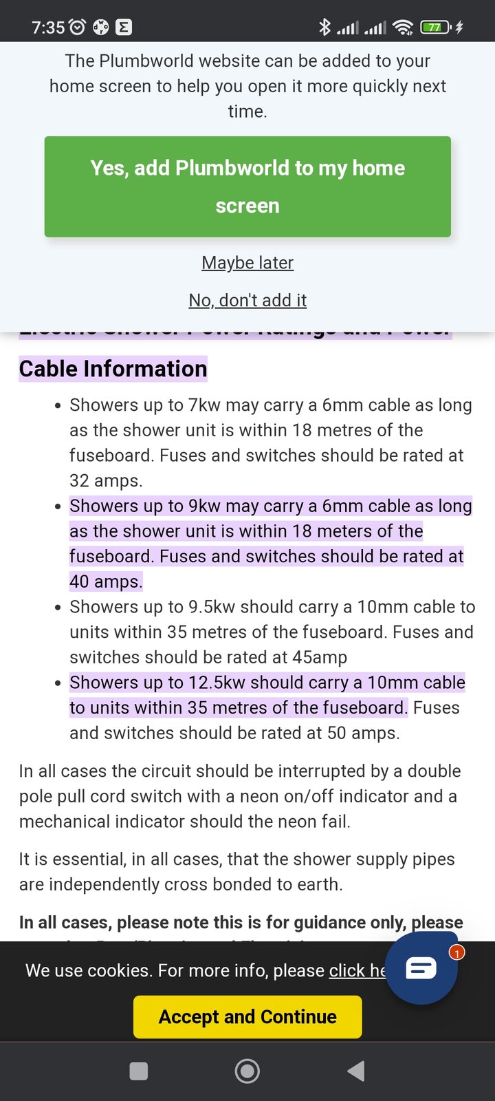

You might (unlikely) only have 4mm² cable which has a current-carrying-capacity of 37A - method C - so no.
Having said that, you have been using the shower which draws 35.4A @ 240V and is unlikely to cause an overload so it won't make any difference to anything except save the MCB overheating, so yes.

Is there a way to find out what wiring I have at all please? The house was built in 2003 if that makes a difference regulations wise etc.
I would change the 32 amp to another 32 amp, it's on the brink and it finally worn out, cable size dependant a 40 amp would be a better solution.
If I took the cover back off the shower and took a photo of the wiring to it would that help knowing what size cable I have or difficult to say from a photo?
But, as I said, a 40A won't make any difference apart from not over-heating a 32A MCB - so would be better.
The cable and the current drawn by the shower won't change.
The shower is the second single MCB from the left.
So 6mm wiring?
Worth trying a 40A as the screws all seem tight?
