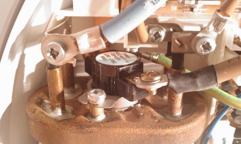

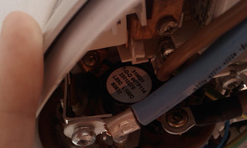

Hello, i have a triton spellbind that is refusing to give out any hot water.
it now just shows the current water temp 12 degs.
This is the second time that it has done this but unfortunately it is 2 months out of warranty.
I switched the unit on and it sounded like the unit was filling itself up with water. not sure how this happened as it is used 4 times a day.
Has the thermal cutout tripped?
no continuity is a failed tco.
on the spellbind it only comes as a complete unit.
it does look like the tco will come out?
part number 22010270 £12.20 from triton.
is it worth a punt? either that or £90 for call out.
ive uploaded some photos but not sure how to show them![/img]
yes your one looks like it will come seperate to the can.
you've got a lot of condensation on the top of the can, that won't help the situation.
Shower doctor it is then.
i will get one ordered on monday.
This could be the best £12.50 ive spent.
Hold on! it shouldnt of failed in the first place.
Thanks for all your help.
showerdoc has it listed as you say.
Just to confirm, that did the trick.
Ordering another today for spare.
Thanks for your help.
