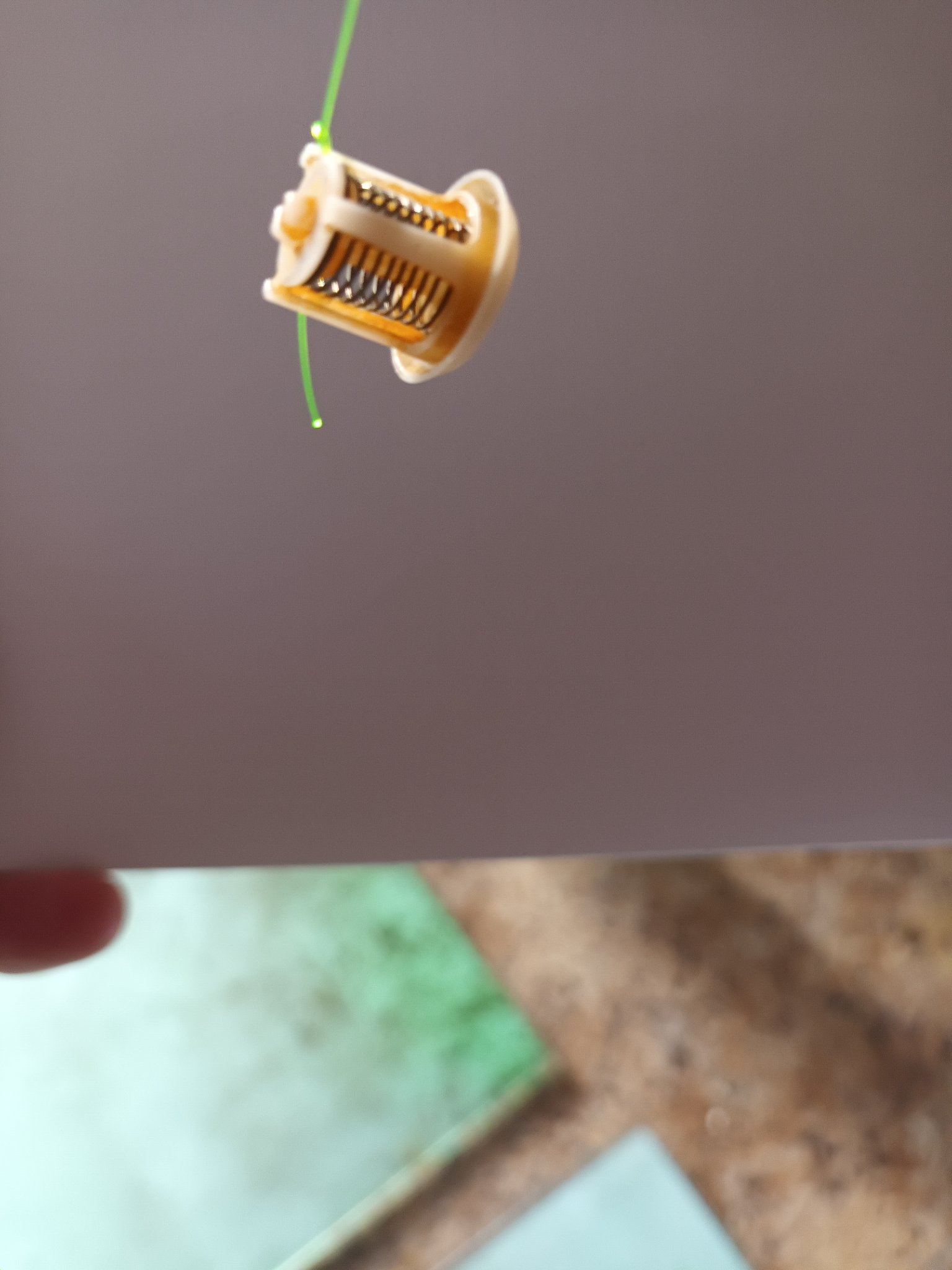

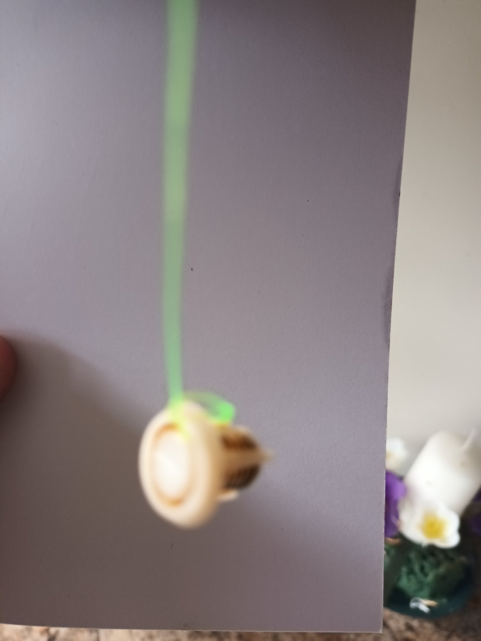

Here are a few photos of a old Mira shower stabilization valve, the valve is (in photo) just hanging from a piece of fishing line.
This valve is incorporated in the flow (temperature) control valve and I think the water pressure just pushes the spring loaded valve open a certain amount based on the differential pressure across it..... depending on the opening of the flow control valve, there is still a minimum annular space around the (stabilization) valve when shut.
