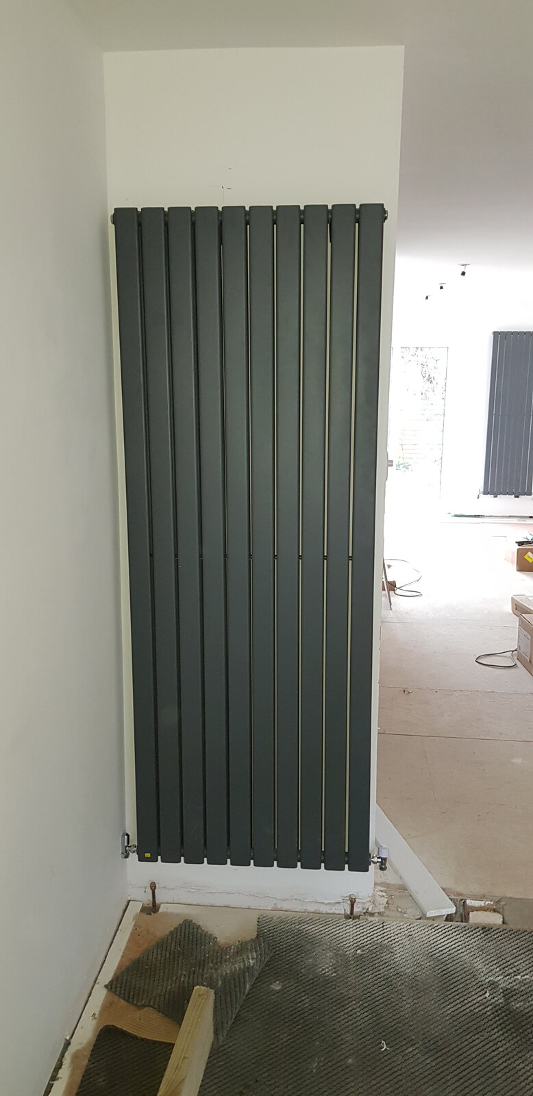

Hi
Ive put a radiator on the wall but am about an inch close to the wall as the valve is sticking out - (2 × 2" valves either side). Can anyone suggest a way around it? I cant seem to fint shorter ( narrower) valves which would probably do the trick.
That’s not going to work. Either swap rad for narrower or swap for bottom inlet type.
What kind of inlet(s) can resolve this? Trying to Google 90 degree or elbow inlets without much success....
1. Whatever you do isn't going to be ideal. TRVs sense room temperature, and you are fitting one in a corner which unlikely to be representative of the room temperature.
2. If you have to do it, I'd suggest:
2.1 A couple of 15mm chrome street elbows (Screwfix 7087R) to bring the tail down and parallel to the bottom of the radiator.
2.2 Fit the TRV to the second elbow, with the head out into the room.
2.3 Use whatever fittings you like to connect the other side of the TRV to the pipe work. Better to replace with a straight rather than angled TRV.
3. The lock shield valve on the other side of the radiator is going to be very exposed to damage. You might like to consider doing something similar to bring it under the base of the radiator.
4. I assume you have checked that the flow and return pipes are connected to the correct sides of the radiator if it requires specific connections.
