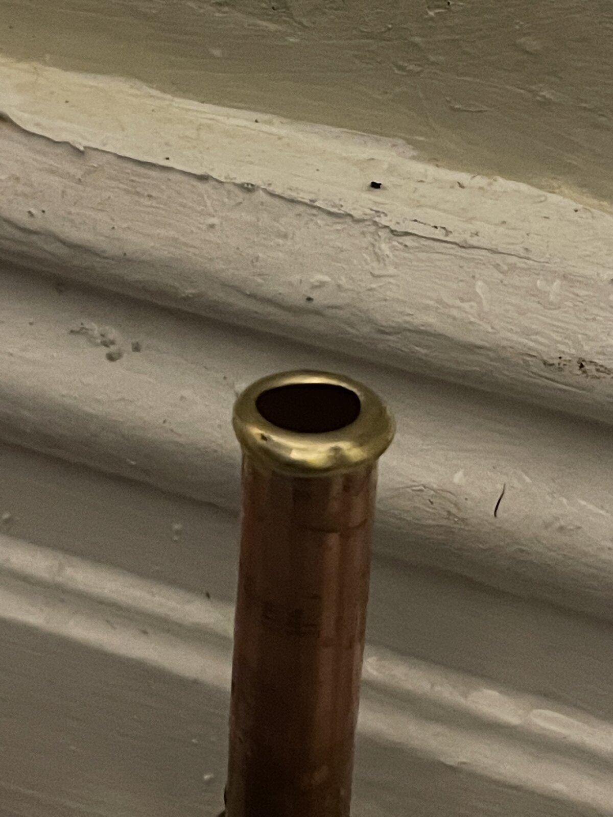

And the ORIGINAL copper pipe end, if you still have it.

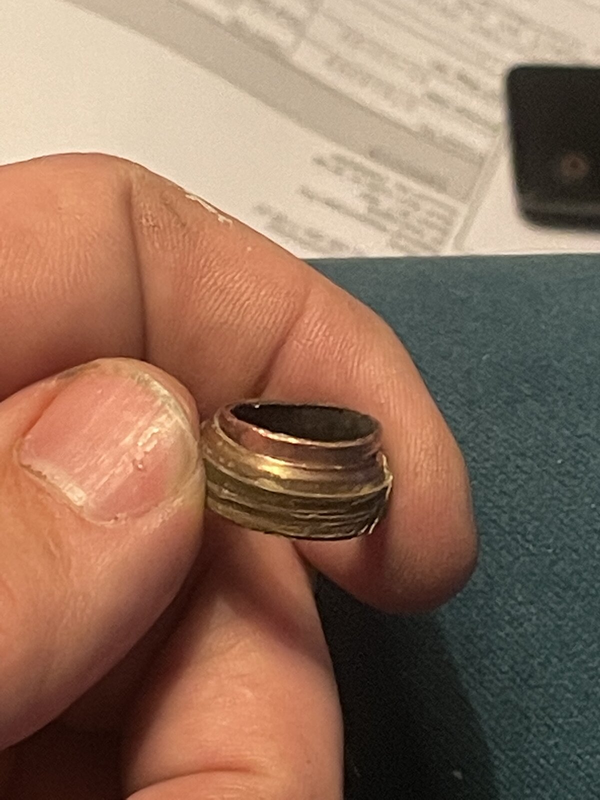

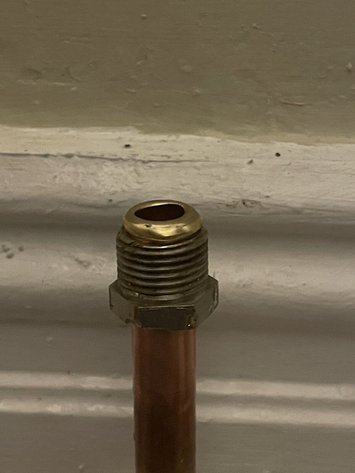

This is the original olive and the top of the pipe. I cut the pipe directly below the olive
It's a type B ,and someone has shoved an olive on . It's pure luck it didn't leak originally.

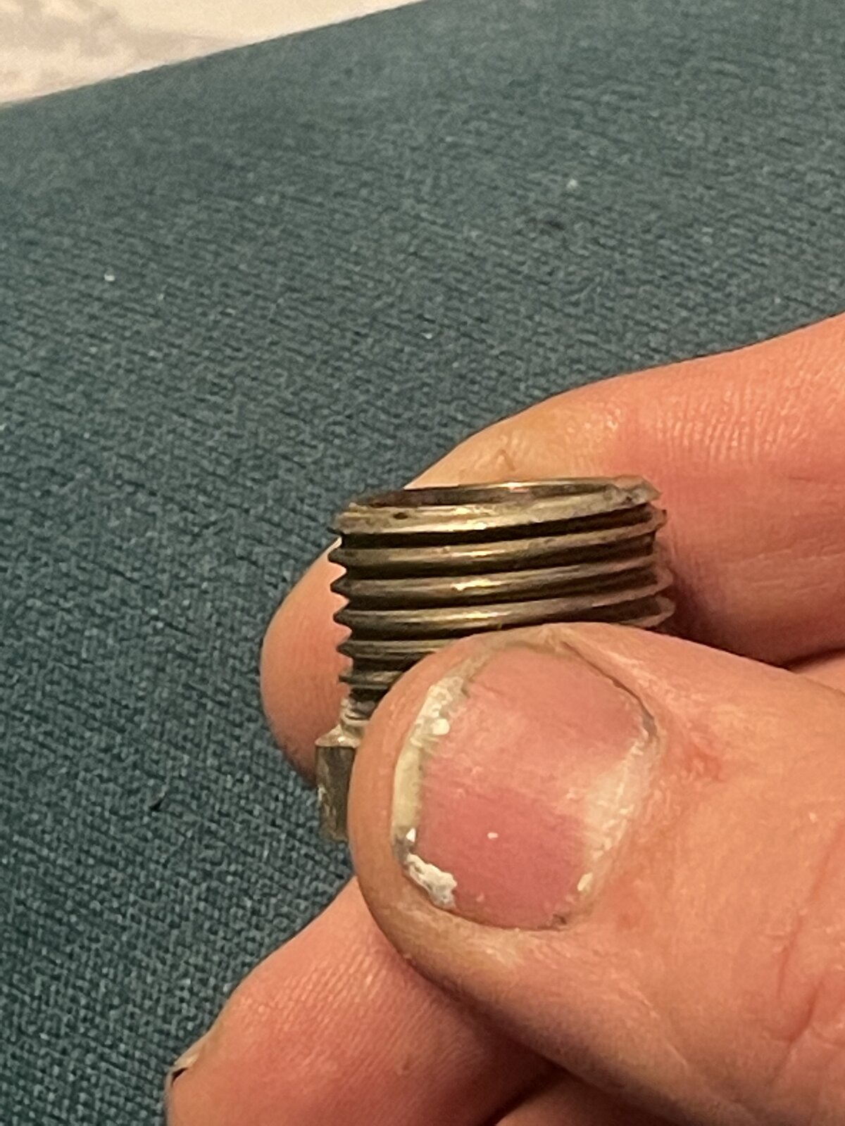

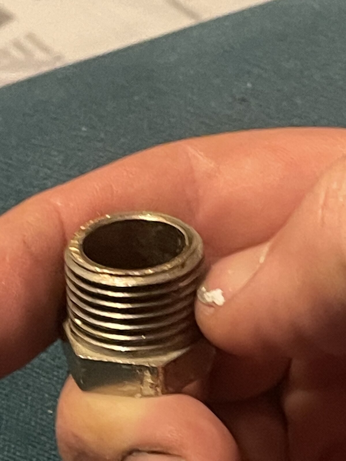

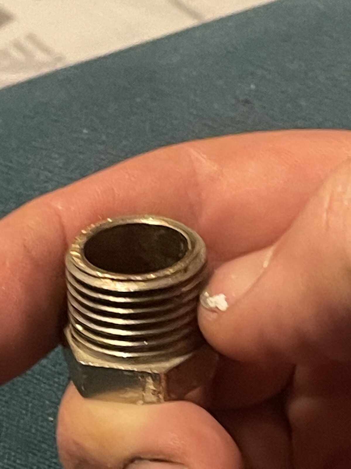

This is the male thread, as you can see there is no chamfer on the end.

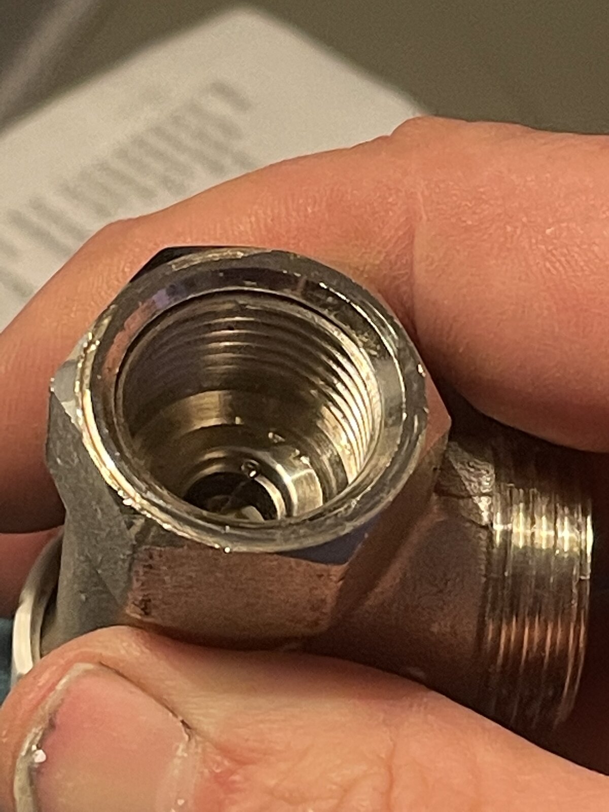

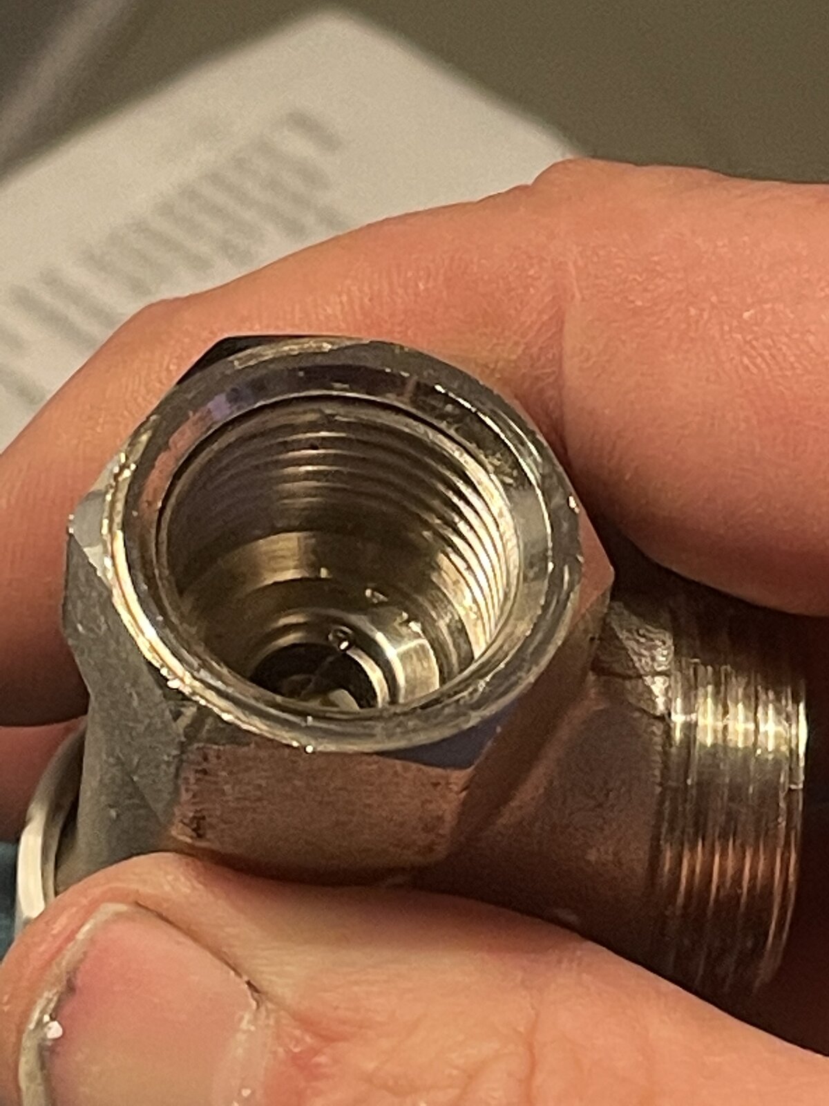

Then the female trv body. The male thread goes the full length of the female.
Is the valve tail that is threaded into the radiator a half inch BSP THREAD,if it is fit a complete new valve.
That type of joint requires the male threaded part to be put onto the pipe ,and the copper pipe end is flared over ( so the threaded part can't come off) .The seal is made by the flared copper pipe end being compressed when the joint is tightened up.
so is it a DIY job? can I buy a flarer? is it going to be cheaper to buy a new radiator tails and TRV?
Buy a new valve ,if your tail thread is half inch . It takes a bit of skill ,even if you have the tools to do it.

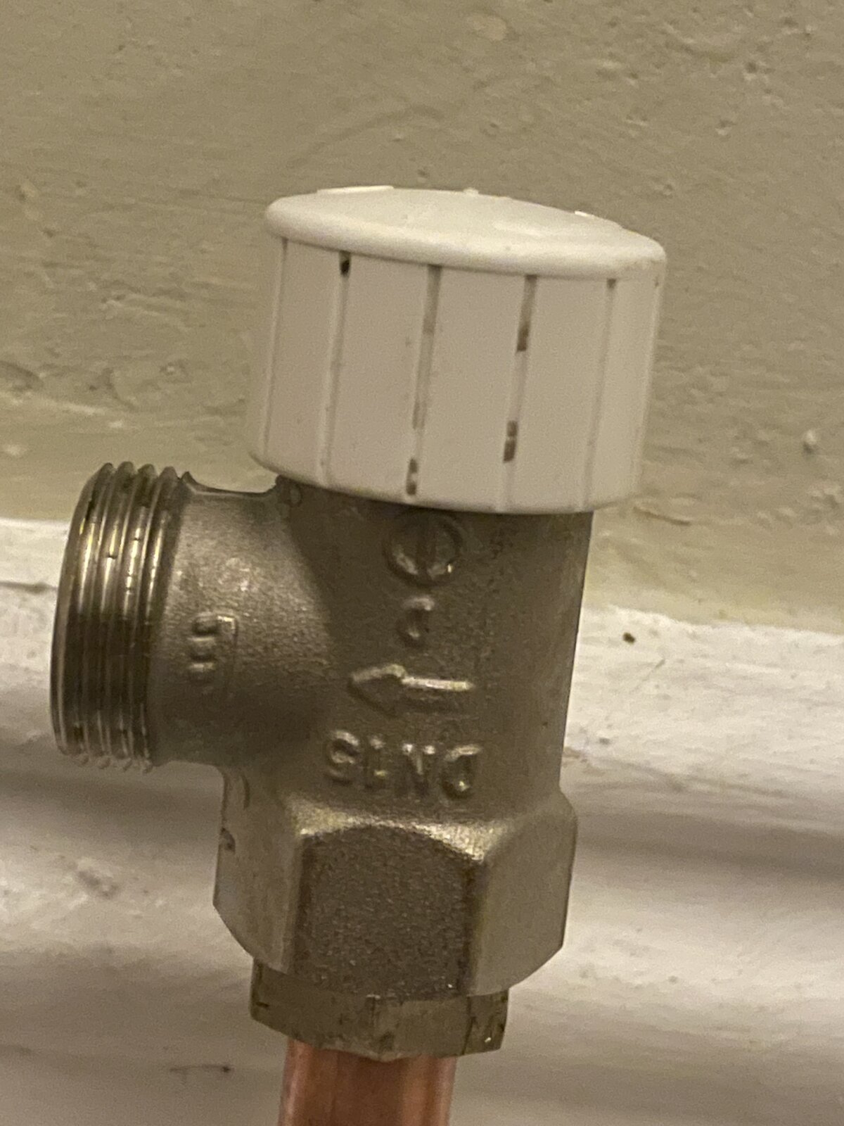

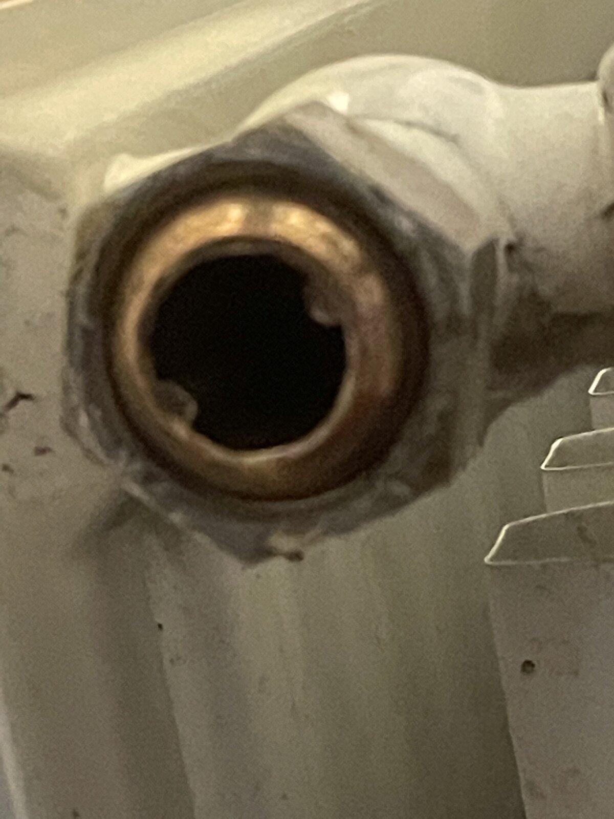

the tail thread is 3/4". this was the only TRV body I could buy that had a 3/4 inch connector to the radiator. I guess I can replace the tail, but then I need to get the old one out. that is a different issue. it doesn't have a hex key to remove it, it has two lugs.
What valve have you bought ??
Your pic shows the union to the valve ,which may be 3/4, but the thread that goes into the radiator ( the tail) is possibly half inch.
