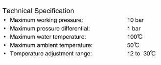

The lower range of the BiWorld Bentley valve setting is quite limited. 12 degrees is as low as it goes.
Most TRV's will go lower than this and just provide frost protection.
If the valve is set to the minimum of 12 degrees and the room temperature is at 15 degrees, then it should really be closed. My experience though, is that whilst TRV's are usually quite good at maintaining a room temperature, their dials are not particularly accurate, I have all my main rooms at 19 degrees, but in reality whilst the valves I have (Drayton) do this admirably, they are actually at different settings in the different rooms to achieve the same end temperature.
Perhaps yours will close off fully when the room temperature rises a degree or two more.
Ok thanks for the advise everyone. My next question is can anyone recommend (from experience of having them installed) any traditional looking TRV's that actually have a lower frost setting that will just keep the room above freezing and not heated to 12°C.
