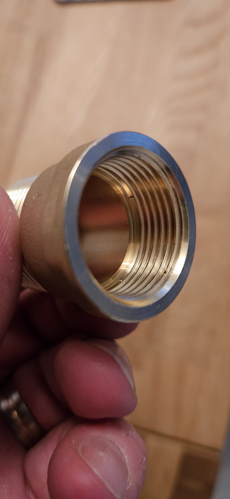

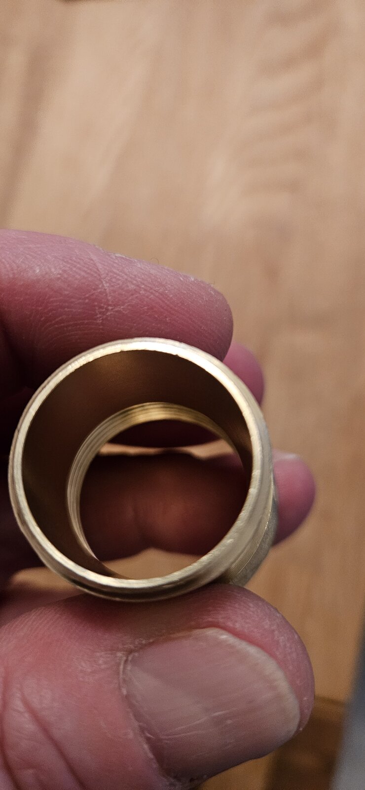

Hello All
I stupidly bought a Bristam Wall mount 11 (large letterbox cut out and plastic section with 15mm compression fittings), but didn't know that it is only compatible with Bristam bar showers. I bought a Mira APT ERD a while ago so can't take it back...
So the wall mount is fitted to the wall and the tails are too short to fit the mixer without leaking. Also the rigid riser won't be parallel to the wall... It's about 15mm shorter.
I've bought a tap extension from B N Q https://www.diy.com/departments/flomasta-straight-tap-connector-x-l-32mm/5059340111643_BQ.prd which is about 3 mm too long, but that'll be OK.
2 questions please!
1. How do I seal the tap extension to the tail from the wall mount (there doesn't see to be any 'land' inside to put a rubber washer?
2. On the opposite end (the face which mates with the mixer bar) is quite narrow. Will it seal on the rubber washer/filter or just give me problems?
Really appreciate your wisdom. Thank you!

In that case I don't understand why. The Bristan kit is 3/4 male at 150mm centres, and the Apt is 3/4 female at 150mm centres. Or have I totally misunderstood the problem?
If you can't solve it by putting an extra rubber washer (3/4 washing machine hose ones will do) in the Apt, you might have to try wrapping the male threads of your adaptor in pipe thread cord.

Thanks for your input. You are the the same place I was. Correct centres, correct thread size. The problem is that the mounting kit is fitted and then tiled over. The brass tails for the shower mixer to couple to are indeed longer, but not enough. If you put the Mira fixing kit on the tile and measure the Mira tails to the Bristan ones, they are 15mm shorter. I've found that an anerobic sealant will most likely work but now I'm concerned that the end of the end of the adaptor may not have enough meat to seal on the filter/rubber washer. The joy eh !

I'm sure I've had this problem in the past and solved it with some chrome adaptors I found on eBay.....!
