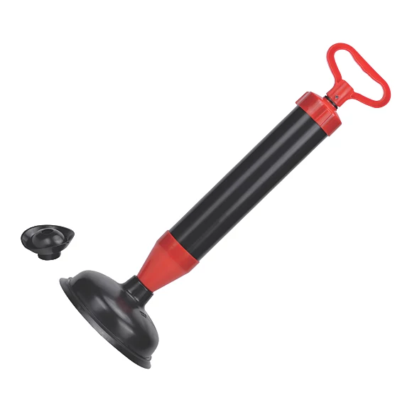

Another DIY option would be a power/pump plunger, had relatively good success with them if a snake does not get past an elbow.
