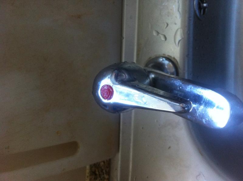

I have a leaking tap/faucet in my kitchen. I am trying to do the following:
(1) tighten it see if the leak stops or (2) change the washers.
I have looked at videos on youtube how to do this and they show different type of taps/faucet. In one video they show changing the washer with spanner and in another video using Allen key to get to the washer. However on my I am unable to get to the washer.
I thought I can access washer by taking of the very small plastic cover on the tap. I anticipated that once the red plastic cover is taken off (picture attached), then I will be able to access the washer, perhaps by taking of a screw with flat blade screw driver. However I am unable to take off the plastic. How else can I tighten the tap to stop the leak or change the washer to stop the leak?
They look like ceramic cartridge taps and you may have problems getting spares for them if that is the case.
I would get new taps if I were you. Lot less hassle or you could just buy some tap converters.
To remove the top remove the red indices and there will be a screw below it. Once removed the tap head should pull off. Brute force or coaxing required.
