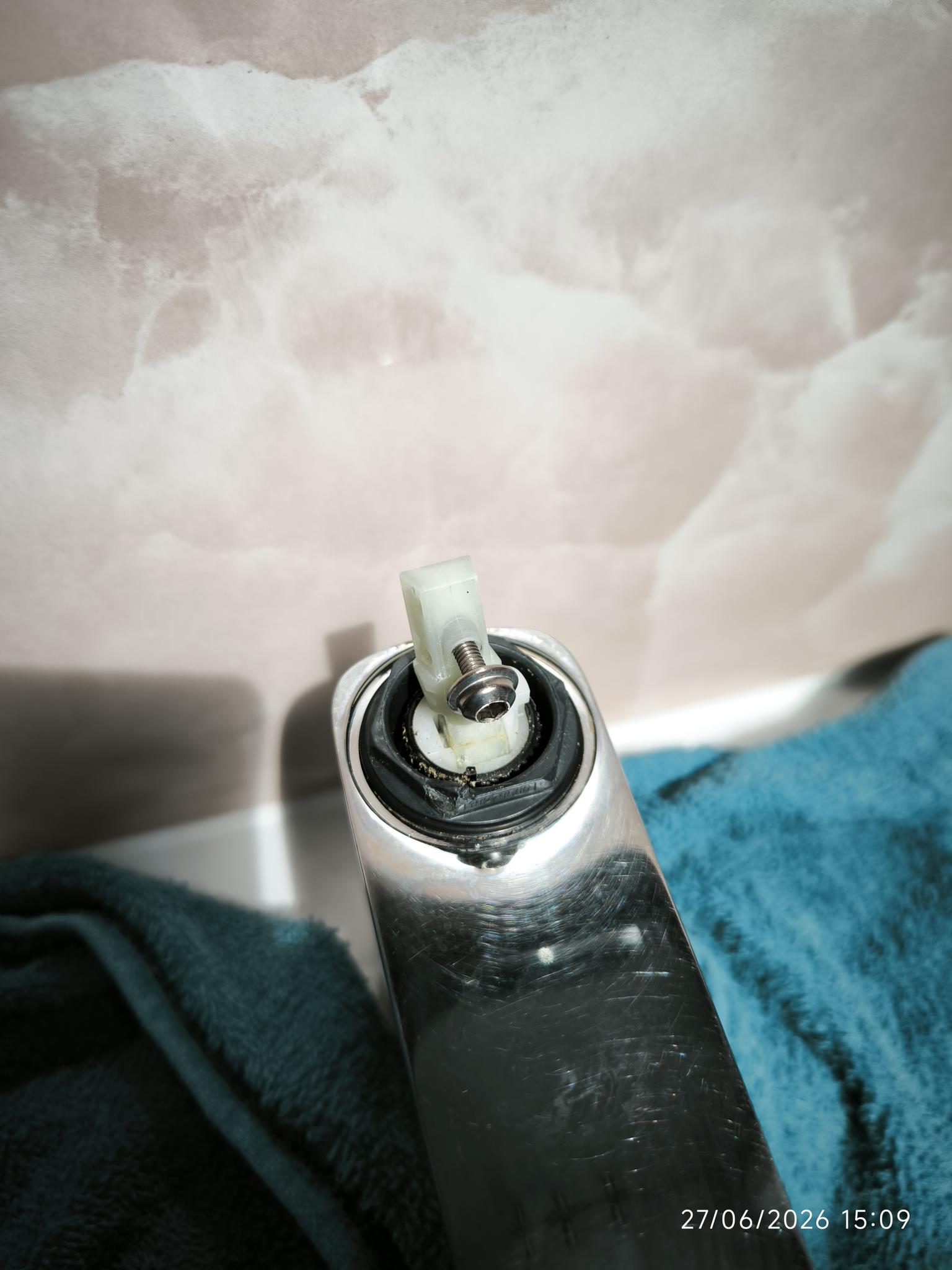

I was trying to replace the cartridge on this Hansgrohe tap.
The retaining nut is plastic and it is very stiff and distorts when I try to undo it. If I press harder it will snap.
Is there anything I can do other than replacing the tap?

Is that a screw going through the front of the tap. you will probably need to remove that if it is. If not you need a box spanner or socket that will cover all the flats and prevent distortion as you undo it.
Thank you and I thought about that, and then worried it would strip the head right off. But I iwll try, nothing to lose.
No screw?
That screw on the photo holds the lever in place, you only need to slacken it a bit.
The cartridge is held in with that plastic "cartridge retaining nut".
The replacement cartridge arrived without a new o-ring seal and nut (being it plastic).
The nut is 30mm, very hard to find box spanners at 30mm. I initially tried my precision adjustable wrench but no way, you can see the nut bending under pressure.
Try some boiling water on the plastic.

Thanks for the suggestion. Unfortunately I need a 30mm box spanner, they are rare or very expensive. I got a 30mm heavy duty socket that I may also use elsewhere. It might not work due to the plastic nut having a very short head. In which case I will need a proper box spanner.

Have you tried the boiling water? It should expand the plastic and release the threads... Also try tightening first then loosening.

This morning I used the new 30mm socket I bought, and it came out with no fuss. I did not even have to use the wrench, I just turned the socket with one hand and it came off...
