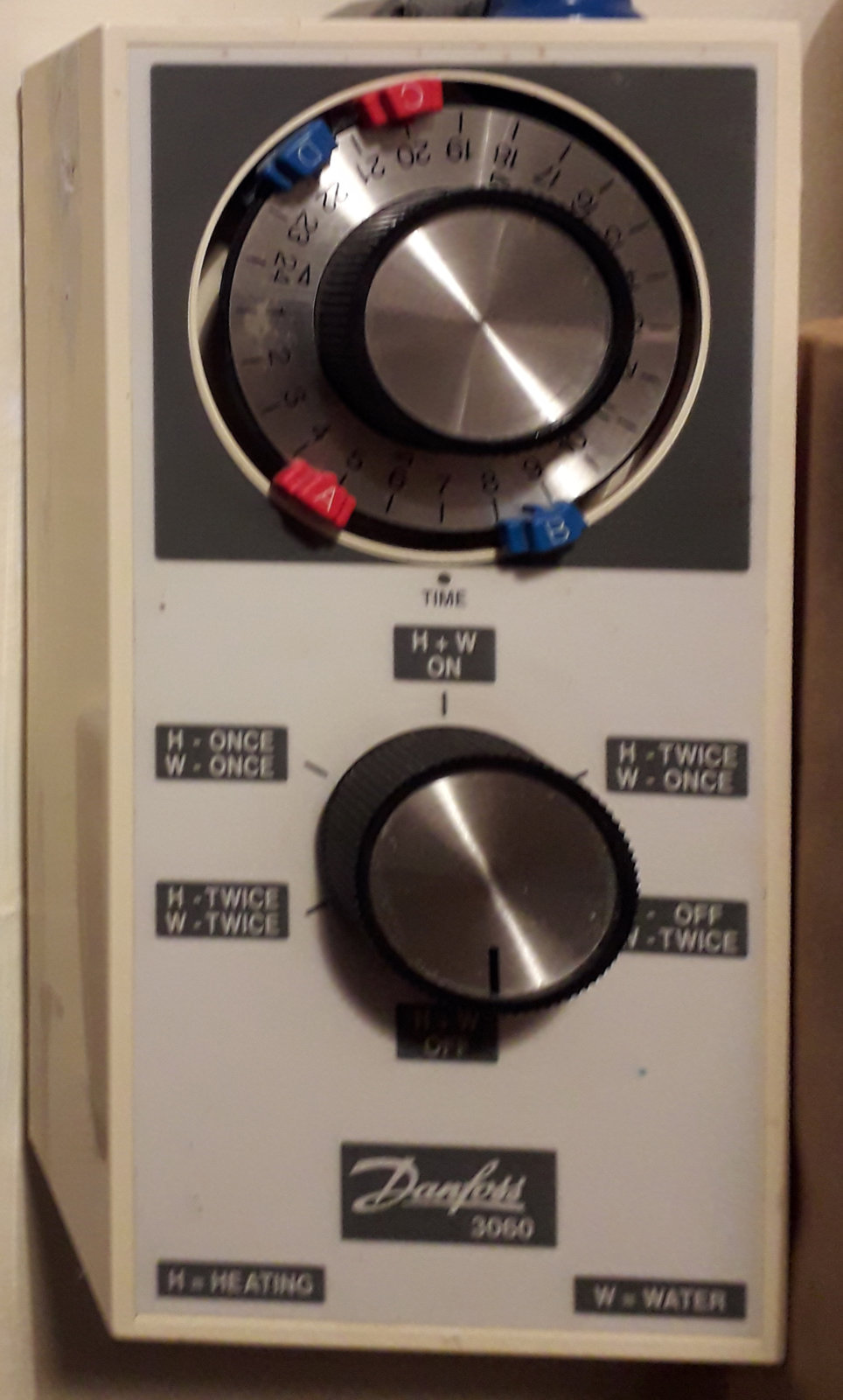

In the house the only control is a timer

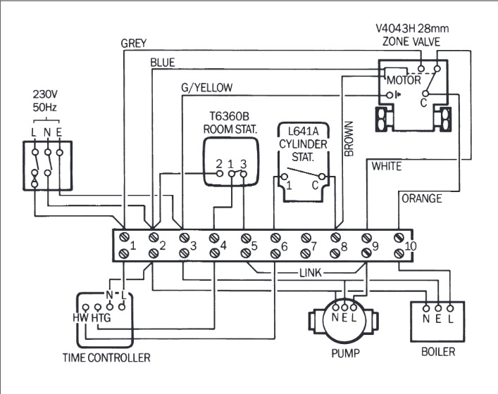

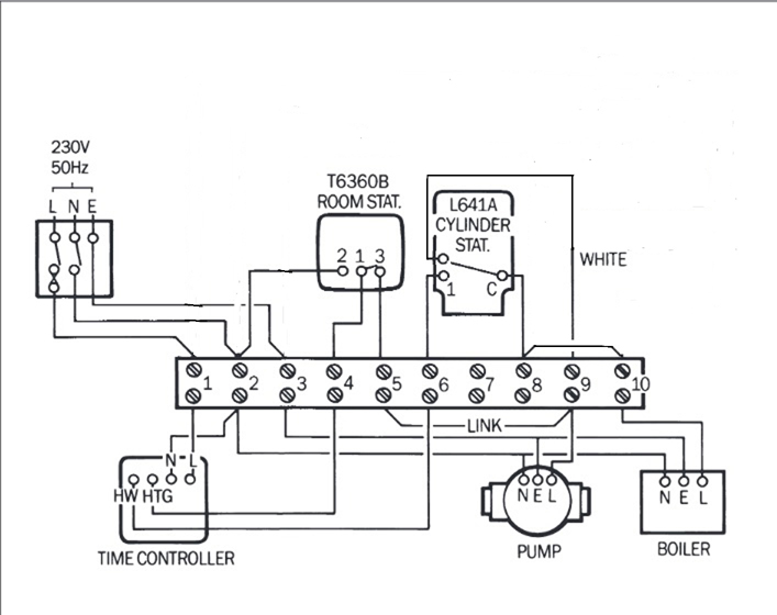

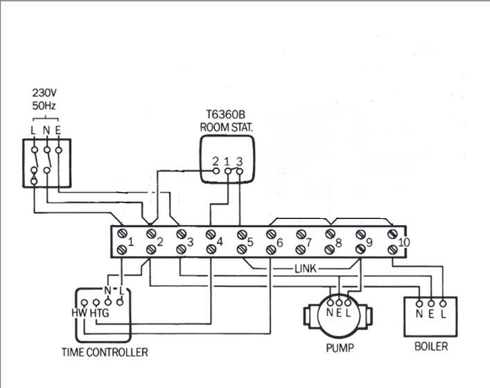

In order to use oil to heat domestic water in summer I would like to convert to latter C plan,
however to do this I need either a RF thermostat or to run extra wires, so maybe better to have a motorised valve fitted which would also stop water getting too hot in winter.
