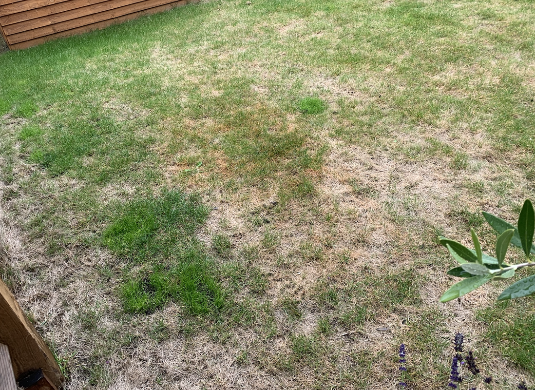

Hi there,
I moved into my new-build in July 2018.
The lawn was in an awful state on the day I got my keys and had clearly not been looked after between my viewing the home and becoming the owner.
During the course of my time here, I have laid thousands and thousands of seeds, dug out some areas and filled with high quality pete and topsoil but still, the lawn is not growing in places. Wherever I dig, I am finding barely any soil just thick clay and flint.
The builders are finally taking some responsibility on this and have asked what I want them to do.
Can anyone suggest the best way forward with this. Not a lot I can do at this time of year other than put yet more seeds down.
I am wondering if I should get them back next year to pull it all up, get rid of some of the clay and put some decent soil and turf down, but not sure if this is the best way forward?
More often than not, builders bury all the rubble under the lawn and the grass as nowhere to establish strongly. For this reason, it may be worth starting again, as you mentioned. You need too to remove any rubble you find quite a few inches down as grass roots are quite long.
When you put the seed down before, did you water it every day out of interest? Shouldn't be allowed to dry out while trying to get it growing.
Thank you for your post. By "start again", would that be:
  1. Remove everything that is currently there.
  2. Remove any rubble or flint.
  3. Strip back some of the clay.
  4. Install at least 100mm of topsoil as per 10.2.9 of NHBC Standards 2018 (as this house was built in 2018).
  5. Lay fresh turf?
I need to go back to the builders with exactly what I want them to do so need to make sure I am saying the right things.
In answer to your question about watering the seed, yup, every single day, even if it had rained. The small patches of healthy grass are mainly my seed.
Yeah, I'd start again completely if there is evidence of rubble and your plan sounds about right.
Before the builders come, it may be worth digging and area down a fair few inches, to prove any rubble. Your lawn does look like a typical failure because of rubble, the way it's so patchy but you need to show them.
You may not be able to get them to remove clay and flint, as it's naturally occurring but they certainly should clean up their mess and not bury it. A general rule of thumb is to remove pieces that are much bigger than a matchbox a foot or so down as that's the good length for a grass root. I think you'll have a hard time getting them to do this though - a bit of a fight in your hands.
We laid our lawn this year and had two layers of rubble to clear out first, first was close to the surface and the second nearly a foot down. Some of it was from Victorian times, some from the 80's, which is when we think the garden last had any work done. We found huge pieces of broken cement, whole bricks, a dead dog and cat!
It looks very dry. Was it watered or over fertilised? Did you try aerating and removing plugs and filling holes with compost and topdressing!
I had same problem with my new build (Redrow). They essentially laid a few inches of topsoil on clay. Looked great for a few months until the rain just pooled on top. I got Redrow to install a French drain. Doing this messed up the lawn further but it needed to be done. There were a few bricks and pieces of wood but not too bad.
I ended up hiring a rotovator and turning it over. Then I mixed in Gypsum which will break down the clay together with some sharp sand and then after a few weeks some topsoil. I mixed this all in then laid the new turf.
The result is great, but I did make an error as I started getting dead spots which I later realised was because I was over fertilising. Now I have quite a lot of mushrooms because of the water, but that is a good sign of organics apparently.
If I were you I would get it rotorvated now and let the old turf decompose. Remove any stones etc. If you can’t increase the height, you may need to remove some fill and then make up with some quality manure and topsoil. Leave this a while then lay new turf in spring.
The downside doing it now in the rain will be that the clay will clump as you are working it.
Manure is fab for nutrients but it really has to be completely rotted down before laying turf and this can take some considerable time, up to a year with some. If its not rotted, the lawn can end up with little lumps and pits as it rots down under the turf, making it uneven.
Some people recommend using slow release lawn feed just under new turf.
