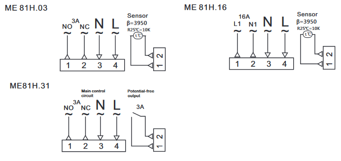

At the moment you have L and N powering the thermostat and volt-free contacts connecting 1 and 3 when heat is required. Lines 1 and 3 might not be 240 volt, some boilers use an extra low voltage for that function.
Your new toy uses the L supply to the stat for signalling as well as power. More info needed- pics of the terminations at the boiler or wiring centre would be useful, as would make/model of boiler, are there motorised valves, that sort of stuff

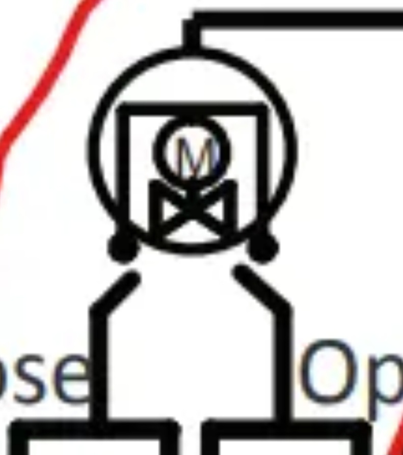

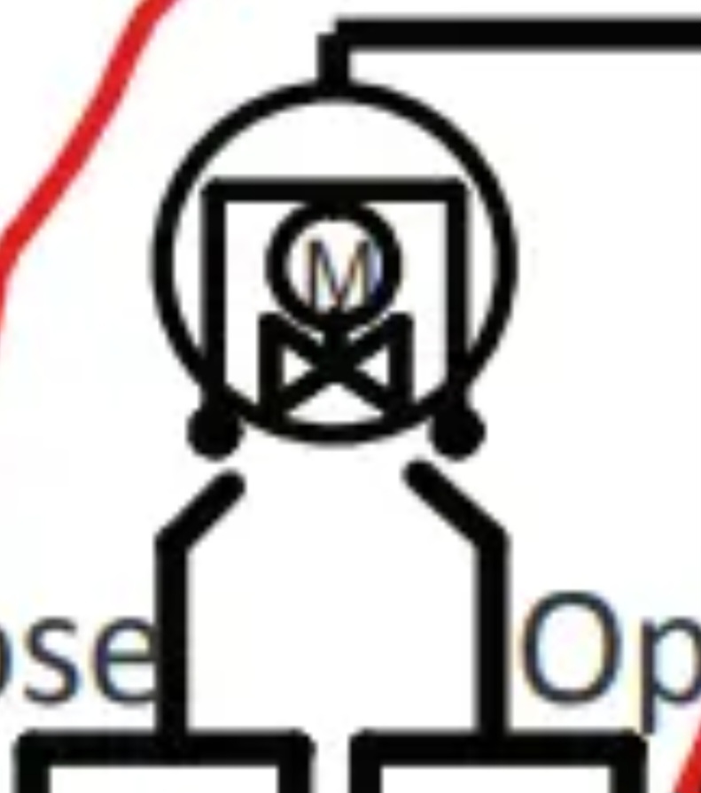

It is the symbol for a motorised valve.The Moes instructions don't really say why one would want the GA version, I would assume for heat pump as can be used heating or cooling, for a gas boiler it would be the GC version, and electric underfloor heating the GB version which has a 16 amp rather than 3 amp rating.
Thisis showing the heat pump, there is a M which I would assume means motor.![]()
For use with mains powered actuators that are driven open, or closed - usually with wet underfloor heating systems.
If you must have the Tuya, get the GC version, and do this..I am trying to avoid the GC version as I only have 3 wires to play with
It will be fine taking 230V.I could use GC and connect one of the "dry contacts" to the incoming L,

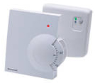

batteries last around 2 years, I replaced every year to be sure they did not fail. Non programmable like this If you must have the Tuya, get the GC version, and do this..

For a battery powered cheap programmable thermostat like this View attachment 363470batteries last around 2 years, I replaced every year to be sure they did not fail. Non programmable like this View attachment 363471 actually lasted around 4 years, caught me out with mothers house had not realised battery powered. To have a wifi connected thermostat not sure on battery life, mine not old enough to have even used one set of batteries. Even the TRV's the cheap eQ-3 last a year, the Energenie over 2 years on a pair of AA batteries.
