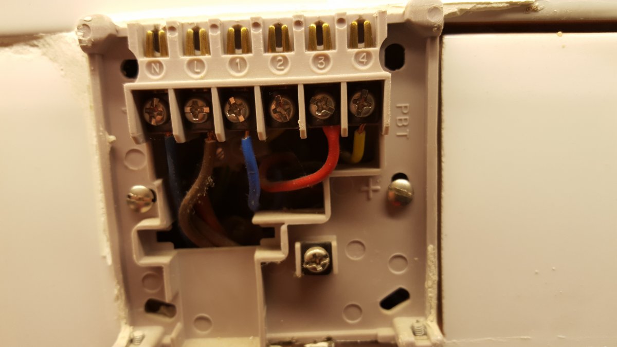

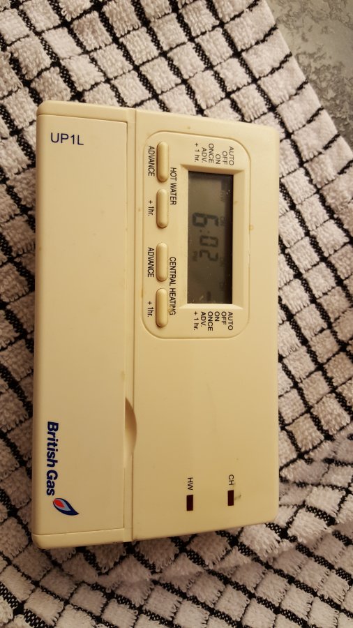

Hi,
I have just moved into a new house and it has a British Gas UP1L controller and thermostat controlling the heating and hot water. I have a new 3rd Generation NEST controller and thermostat to install and I cannot find a wiring diagram for the UP1L.
N and L are self explanatory.
I think 1 is for the water and 3 is for the heating but i am unsure what 4 is for (Is this correct)?
Does anyone know where i connect these wires on the NEST controller?
Thanks in advance

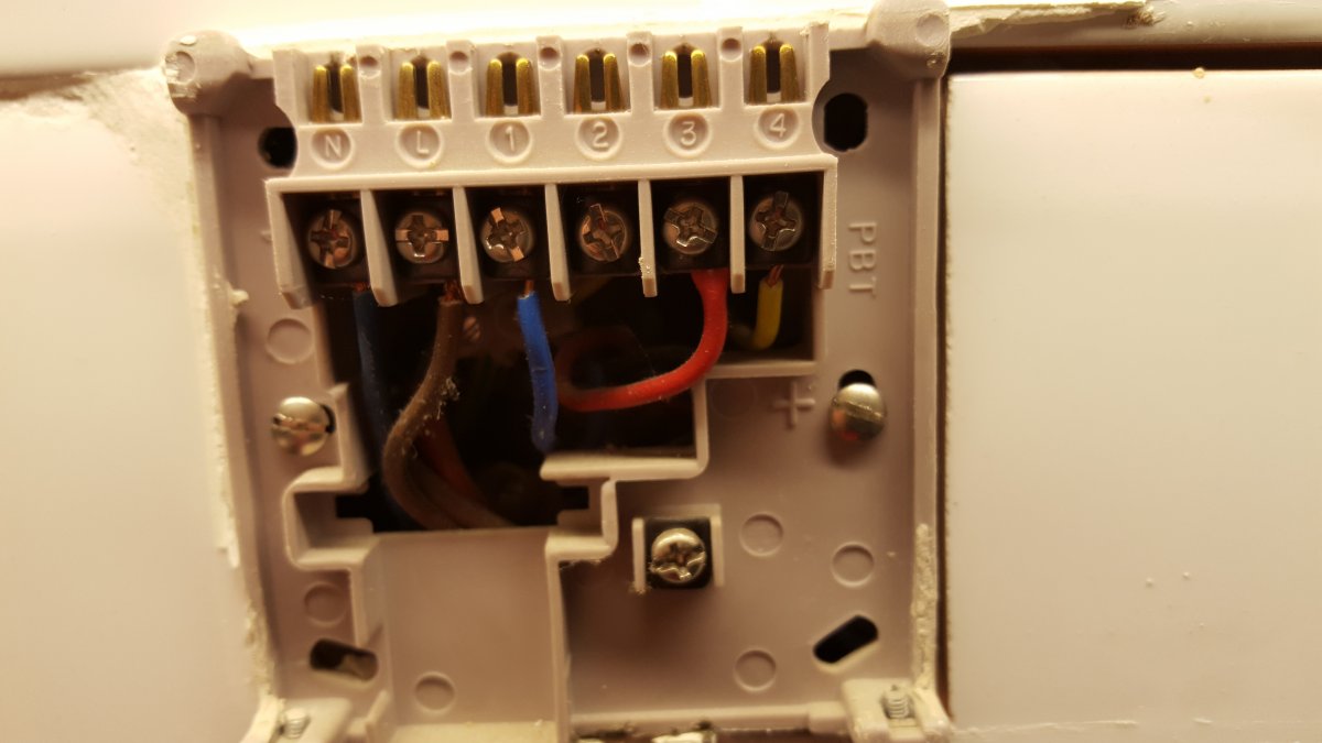

Fairly certain this is a rebadged landis and staefa rwb9.
Live and Neutral are as you would expect.
The wires in the old backplate terminals.....
1 HW OFF will go into Nest terminal 4
3 HW ON goes into Nest terminal 6
4 CH ON goes into Nest terminal 3
You also need two short wire links
One from Nest Live to terminal 2
The second between terminals 2 and 5.

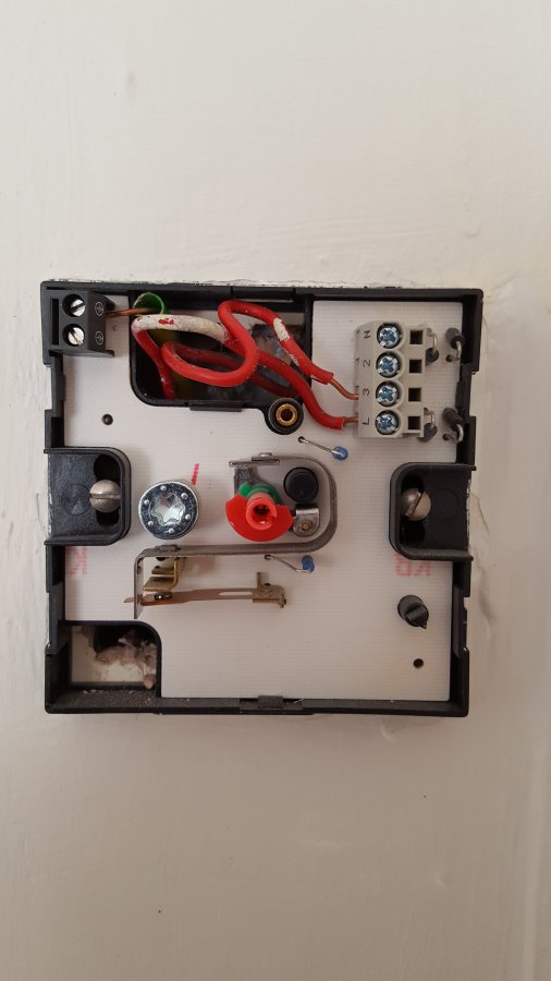

Here are the thermostat connections, I am unable to remove the cable between the old programmer and the thermostat. I presume if i connect both the 'Live' and 'Switched Live' wires together behind the old thermostat using a chock block this will be OK ?

As stem says the best way is usually to find where the thermostat wires join into the wiring centre.
If you don't have such a central junction box then safely joining those two thermostat wires in L and 3 together will get things working. If there's enough space in there you can buy chocboxes from screwfix which will keep the wires safely covered.
Predictive text is the work of the devil!
In your photo, it looks as if the thermostat might be fitted to a metal pattress / back box. If so, you could remove the thermostat, join the two red wires together with a screw terminal. Stick the earth wire (if it is connected to an earth at the other end) in the back box earth terminal and then cover the whole thing with a single blanking plate.
