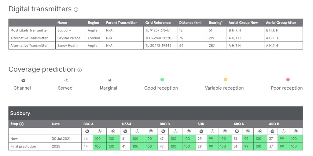

Once you have the hardware side of things sorted, you'll do a little research in to what your local TV transmitter is called and the mux channels it broadcasts on. To do this, use the postcode checker here: Detailed transmitter information for industry professionals | Freeview Enter your postcode and house number. The information that comes back is a list of the most likely transmitters, and the RF channel numbers that each of the mux groups is found on, and then a signal level prediction.
For example, say I lived in Halstead at 7 Ravens Road CO9 1NZ; here's what the search would show:
The above tells me that my most likely transmitter would be Sudbury, and that I'd be picking up transmissions on RF channels 29, 31, 37, 41, 44 and 47. The site's best guess is that the signal from these would be pretty strong right the way across the board. However, your aerial and where it is positioned and how it is aligned might change things.
Armed with this info, the next thing I would do is a quick tour of each RF channel to look at Strength and Quality. If any is weaker than the rest, then this is the one to start with. What we're doing in this next part is to reduce the signal level in progressively larger steps to see if and at what dB level the Quality starts to change.
You can think of quality as the difference between the signal and the background noise. (There are other aspects to it, but this definition will do for now.) Reducing the signal strength shouldn't affect the Quality until we reach a tipping point. If it takes say 21dB of attenuation to start to change the Q reading, then we can make an educated guess that there's at least 19 or maybe 20dB of safety margin. At that sort of number, you definitely don't need an aerial amp. But if you were to do the test and found that things go south with say just 6dB of reduction, then I'd be tempted first to look at the aerial type and group to check if it's a good match for the transmitter. If the aerial was a Wideband High-Gain type, then it's reception favours transmissions from roughly RF ch40 through to the now obsolete ch68. It wouldn't be a good match for Sudbury. To test this, I would compare the stress test results for channels 29 versus 47. The result I would expect is for ch47 to stand up to more attenuation than ch29 which is well out of band.
