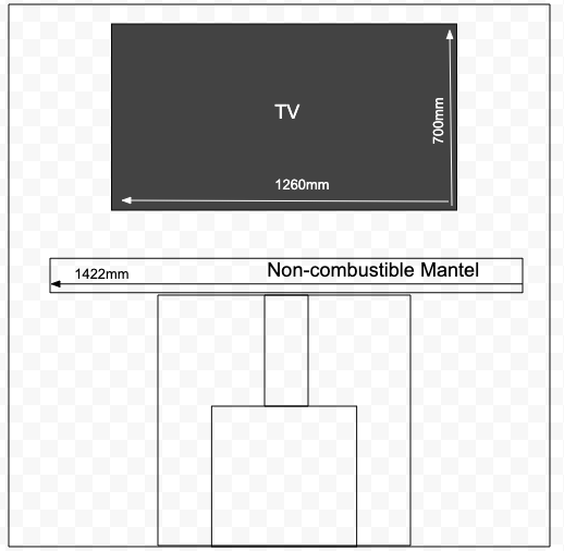

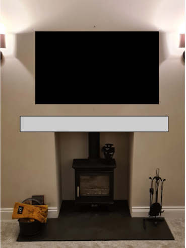

I have a bit of a dilemma which I'm hoping some members can help shed some light on. Our lounge, while a good size room, only really lends itself to mounting a TV above the wood burning stove. Worth noting that this is a block wall not stud.
From a bit of research I see concerns of heat, viewing angle and building regulations. The viewing angle while not ideal we can live with. Heat and building regs I am hoping can partly be addressed with a non-combustible mantle.

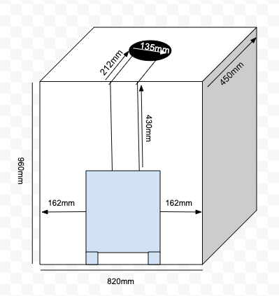

Key measurements:
Recess for Stove - 820mm x 960mm
Top of stove to top of insert - 430mm
Flu pipe diameter - 135mm
Questions
  1. Can the bottom of the mantle sit flush with the top of the recess?
  2. Is there a minimum depth and height the mantle should be?
  3. How far should the TV be above the mantle?
  4. Has anyone seen any evidence of a TV being effected by heat/smoke/suit in a similar setup to what I am suggesting?

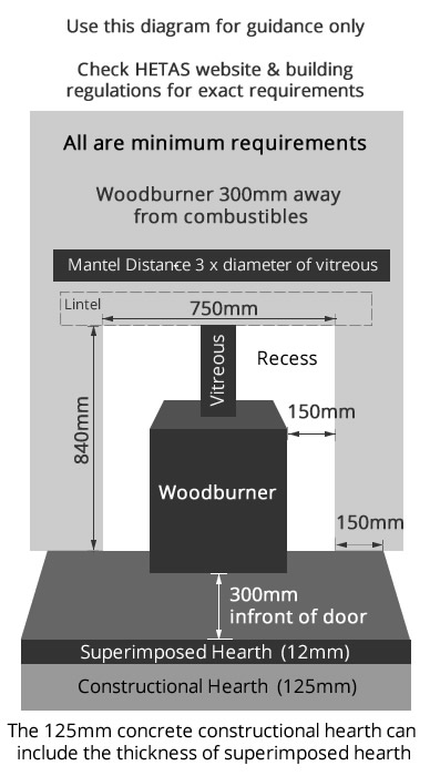

I have added some images and (terrible) mock-ups of what I am hoping to achieve. The HETAS diagram is for a combustible mantle (non-combustible mantle distance is 1.5 x diameter of vitreous/flue pipe).

From a tech point of view, there really isn't a direct answer to Q3 because local conditions will vary so much. TVs will work okay up to a room temp of 40 degrees. The speaker sound from most ultra thin modern tellies is fairly parp, so you might want to think about leaving adequate space for some kind of soundbar to beef up the audio.
Q4: LCD/LED TV panels are not sealed. Over time, the internal air currents inside the TV will circulate and deposit fine dust in between the layers between the backlight and LCD matrix (the bit that makes the picture), and between the matrix and any surface protective layer. After a couple of years in an average living room you can start to see some variation in the brightness of the screen when displaying a uniform light coloured background image. It looks a bit like a dirty window.
Putting the TV over a heat source that chucks out this same kind of fine dust will speed up that degradation.
Where the room layout is fixed, and you've already got the fire and the TV point set up, then there's really not a lot that can be done to change this. Either don't spend a lot on a high-end LED TV, or go for something with a sealed panel. That means spending top Dollar on an OLED next time.
@Lucid very helpful thanks for that. The wall above the stove doesn't actually seem to get too hot. I need to get a thermometer taped on and a good 4-5 hours burning to test.
I actually have an OLED TV to go up. Are they sealed panels?

as for the TV you will need something underneath it to reflect the heat away, so your mantle piece idea would be good, it will require a heat reflective coating underneath.
the chimney breast will only ever get luke warm at best.
no problem with mounting the telly there if you wish providing the relevant precautions are taken.

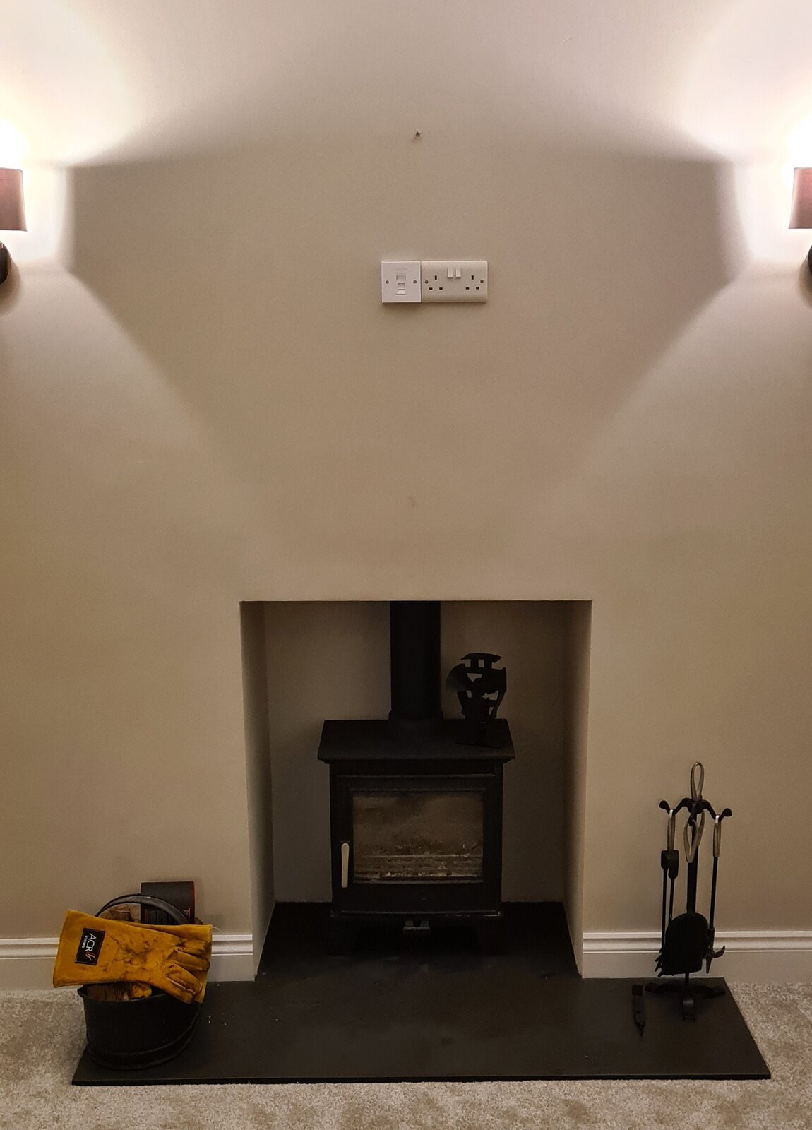

The only cables that will be exposed are the power and ethernet to the TV. We chased the wall for Electric and ethernet to the sockets (see pic in first post).
Heat proof/fire resistant sleeve - will look into this.
Heat reflective coating - will take a look at this as well.
Sure is. It was installed early November. The picture in my first post is how everything sits right now.
If thats the case if the tv could be mounted with an air gap behind and as suggested , mantle protruding out under to deflect the air flow then I cant see a problem
