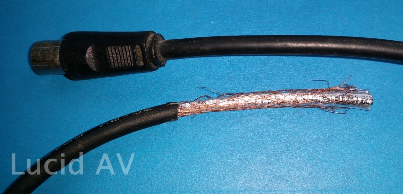

Power cables interfering with coax suggests poorly shielded coax is being used. Typically, it's the sort of cable that comes with moulded-on plug ends. The shielding can be anything from barely adequate to very poor. Unlike loose cable off the reel, you can't tell with this pre-made stuff without destroying the cable first.
This one is in the barely adequate category.
Another issue with moulded cables is that the plug-end connection of the centre pin can break. Some will die instantly, so that's easy to spot. Others form an intermittent joint with a small gap where the break is. The thing is, the cable still works because RF effectively jumps the gap a bit like a spark in a spark plug. However, the resistance of the cable with such a gap is much higher, so the signal level reaching the TV takes a hammering.
