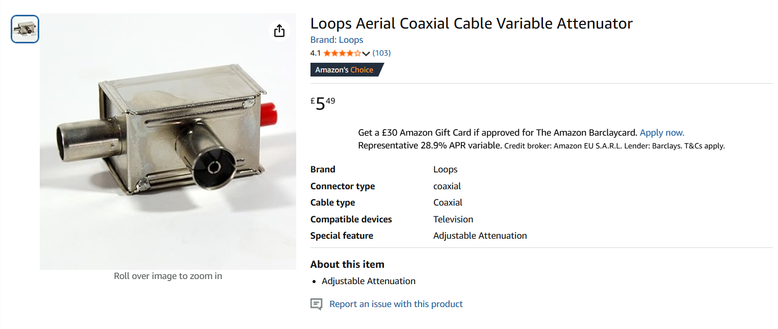

Try a variable attenuator at the socket of your main TV. Reduce the TV's signal strength to about 70%. See how you go.
thank you mate. i will get one of these and connect to the TV i watch most. i guess. i will have to play around with adjusting the signal a bit witt the red button on the side, which i assume is for increasing or reducing the signal strengh. thank you
An attenuator just reduces the signal strength. It doesn't increase it. What it does though, being a passive device rather than amplified, is that it leaves the signal quality unchanged. It reduces the power without reducing the quality. It's a good diagnostic tool.
Next time you lose signal, turn the attenuator down. If signal overload is the issue, then it's a quick way to find out.
