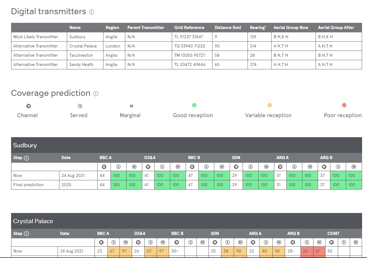

Thanks all, I'll try and change the cable unfortunately some of it is buried in the wall, I've attached my local transmitter details if that helps.

could you tell us the town/village you live in so that we can work out if the small sudbury or larger main transmitters would be better to get your signal from
The channels you've mentioned having thmrouble with are on mux channel 31 - ARQ A. The last full list I had was:

Both 29 and 31 are towards the bottom of the channel range for Wideband High-Gain aerial, so the signal level coming off it at the lower frequencies will be weaker. Combine that withbtge effect of the extra losses from a poor coax extension...

I remember the guy that fitted the aerial said the signal was too strong and had to point the aerial slightly away from the transmitter which I can see from my roof, not sure if this was right but it's be up for about 15 years.
At 9 miles(?) from a 100,000W transmitter I wouldn't be too surprised at that. However, at the time, pre DSO, all your channels were at the upper end of the frequency range. They were from RF ch39 to RF ch68. That would be a really good fit for using a Wideband High-Gain aerial (WBHG).

Third, the transmission frequencies have shifted from Sudbury. They're now in the range from 29 to 47. They're in the weak zone for a WBHG aerial. In fact, the channels where you notice a problem are at the lowest and weakest end of a WBHG aerials reception range; your Sudbury ARQ A on RF ch31. That, plus the aerial's reception being made weaker by being off axis, makes RF ch31 disproportionately weaker than the higher RF channels.
