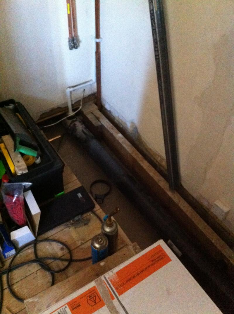

Floor lifted and new pipe installed
Pipes connected to the loft where the boiler is .

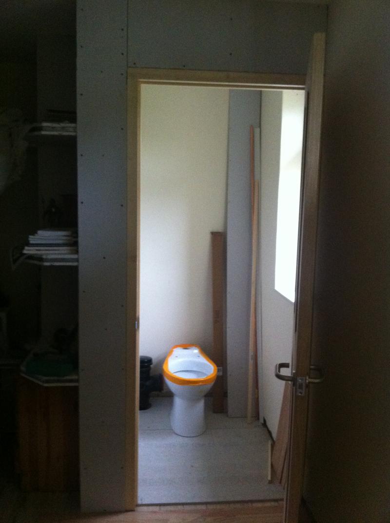

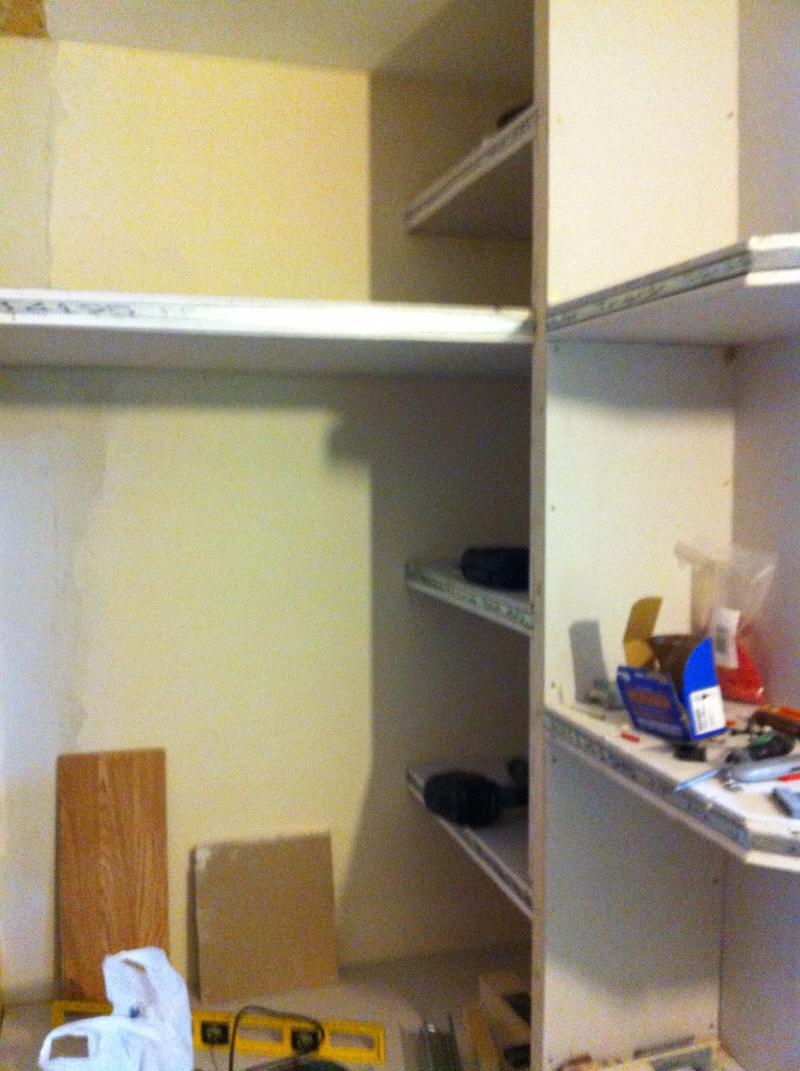

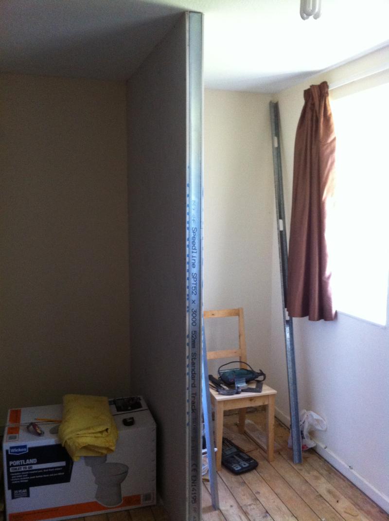

While doing a bathroom we thought it would be a good idea to build the wardrobe and the toilet at the same time using a combination of metal studs /wood and plasterboard.
Partition wall for toilet
Shelving

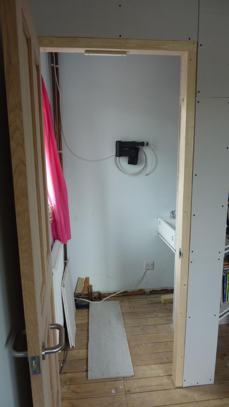

Hardieback on the floor and toilet positioned but not yet connected.
Door installed
I hope to start the finishing touches over the weekend and hopefully fit the sliding door on the wardrobe . I will post more pictures on Toilet one once is updated.

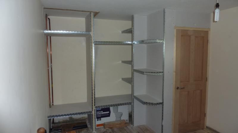

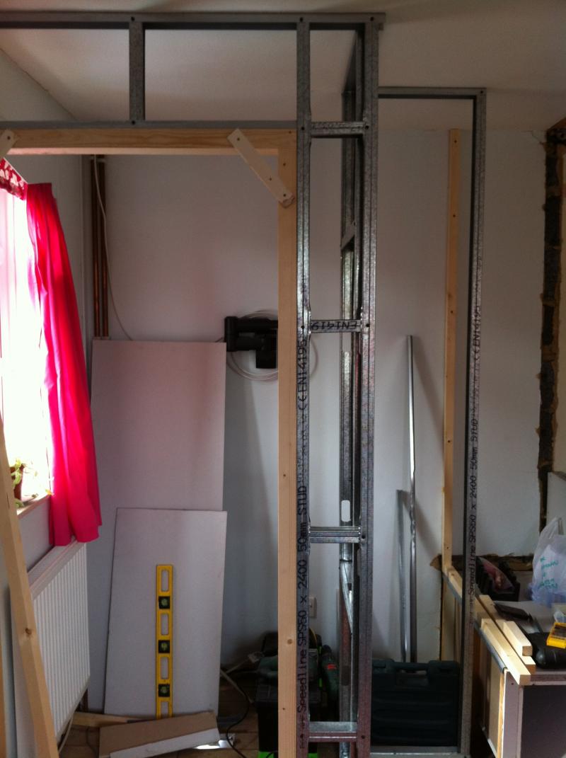

Here is numero 2 :D

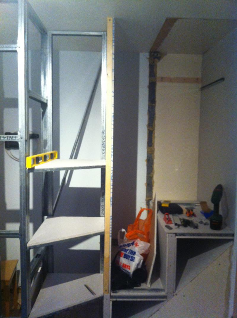

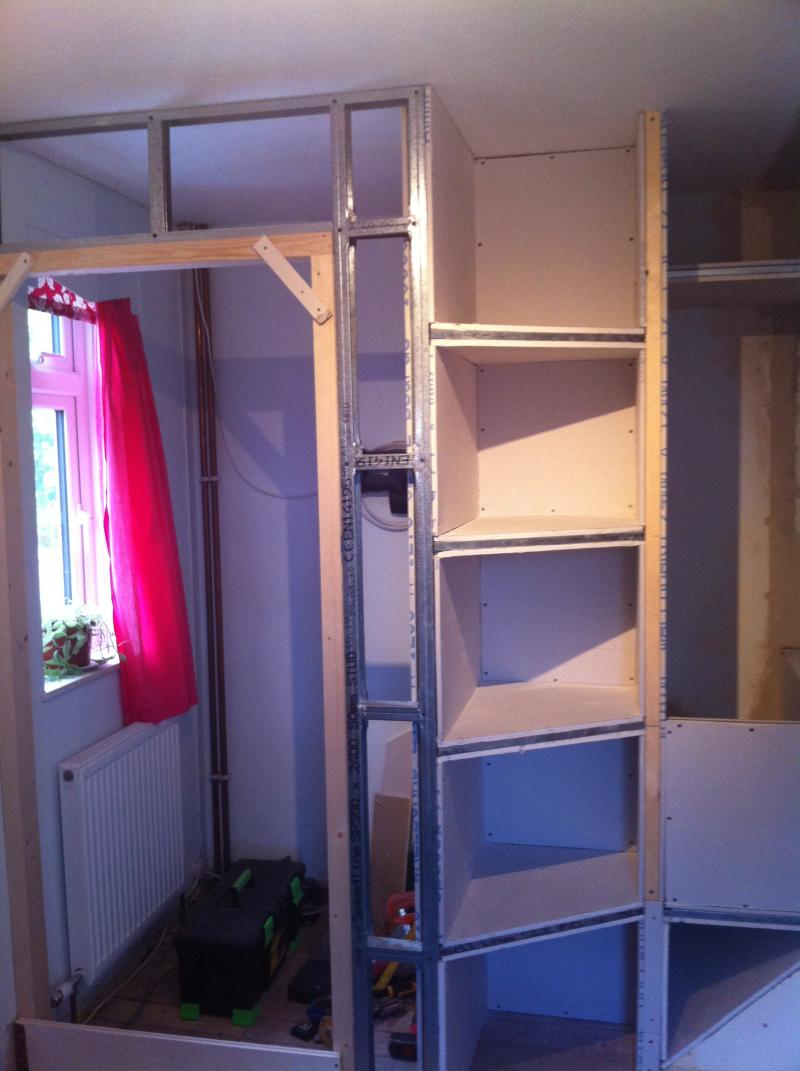

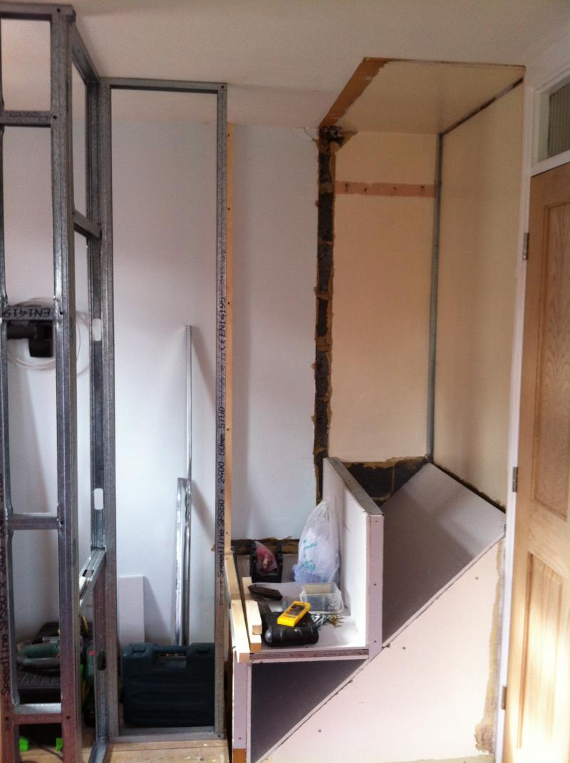

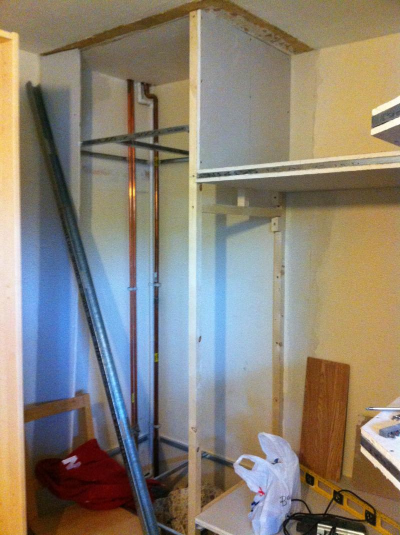

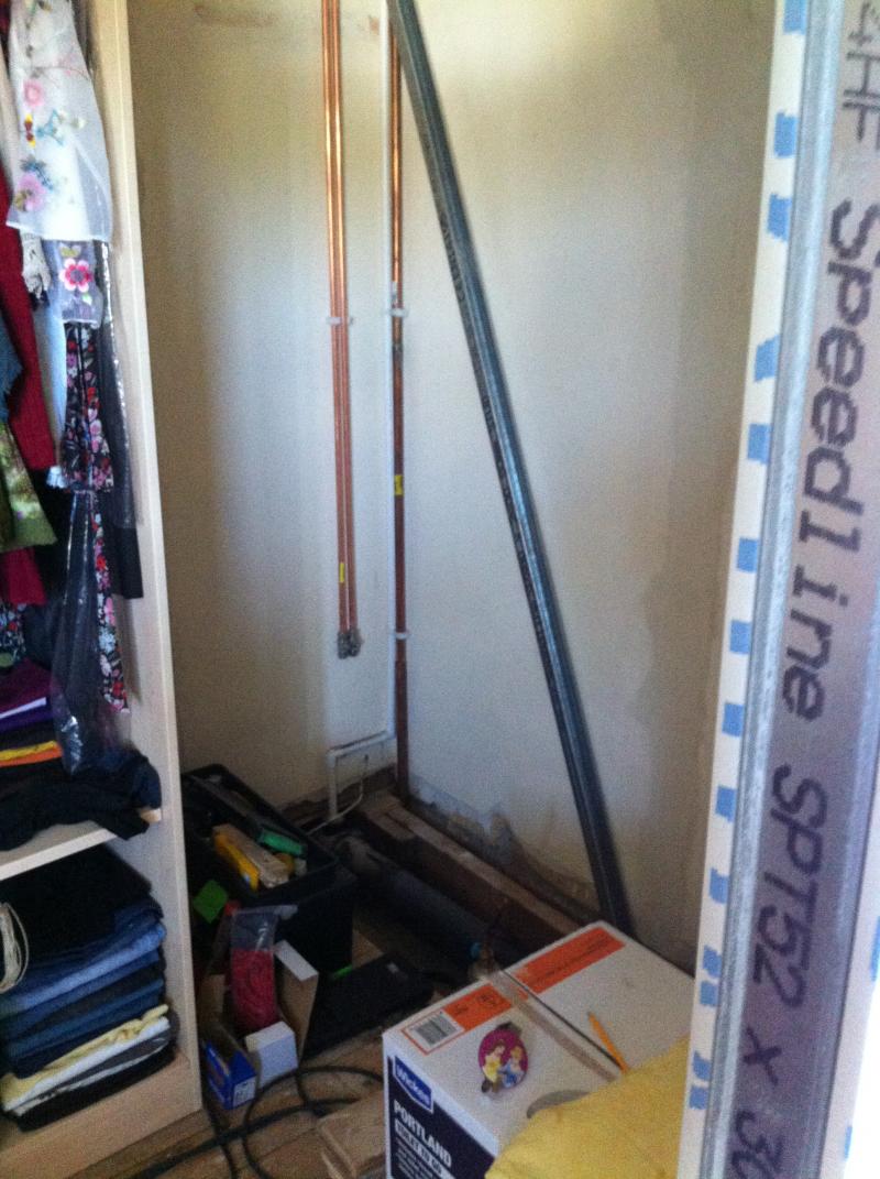

Old wood cupboard in the top of the stairs removed and structure started.
Door Frame
Shelving
Small wardrobe frame
Bedroom Door View
to be continued ...

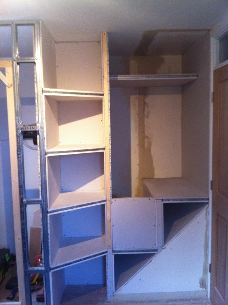

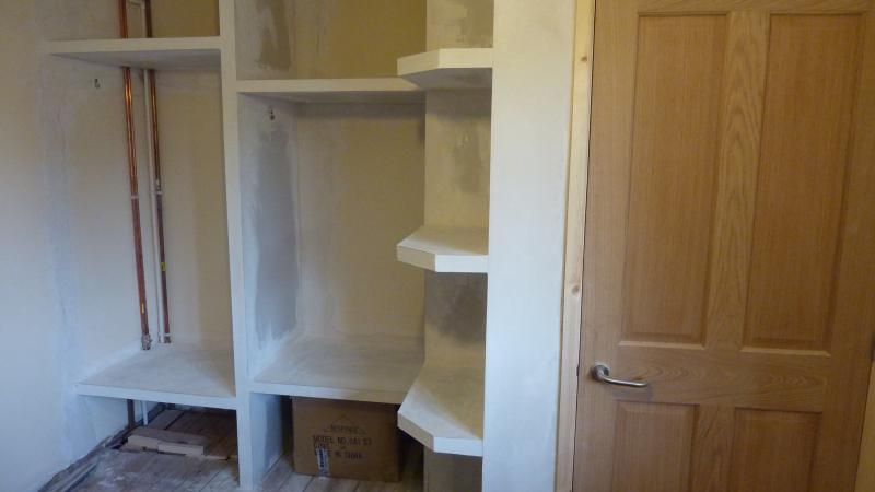

I have done more progress over the weekend so here are the pictures.

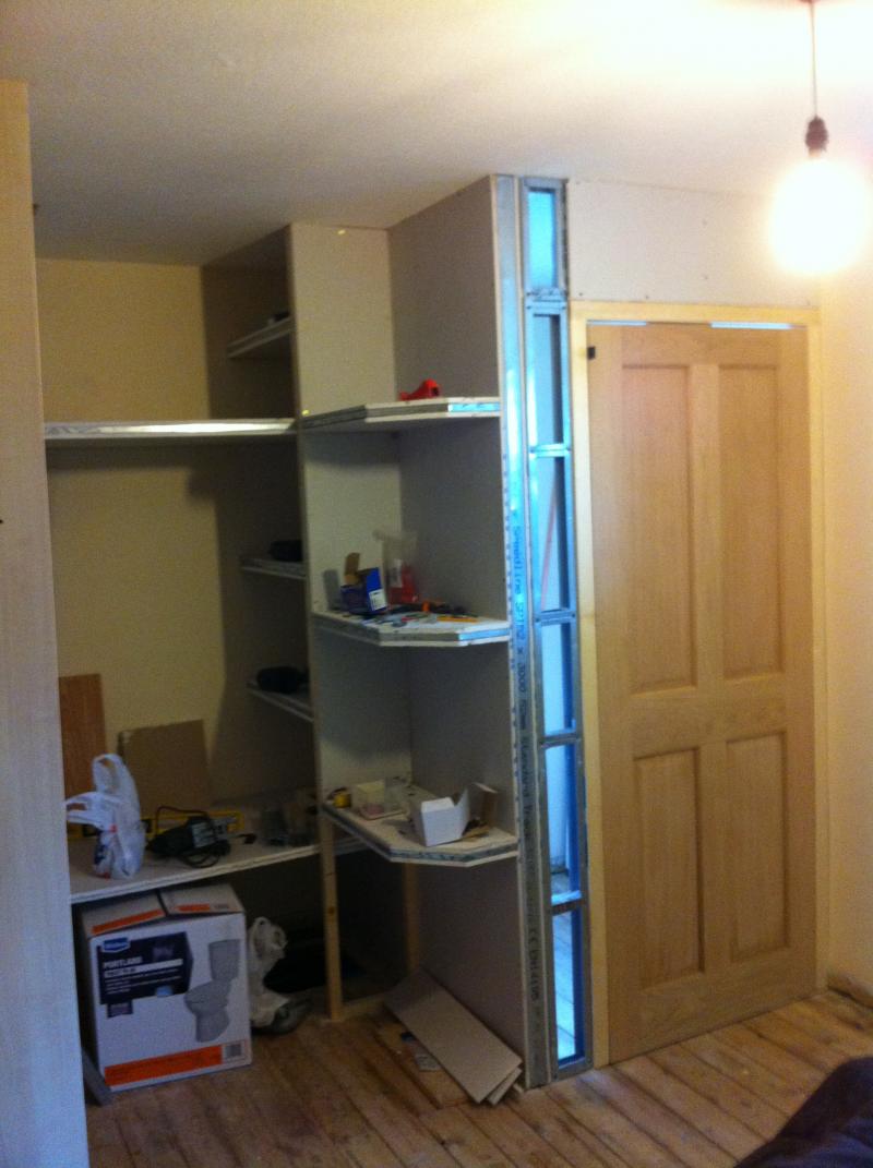

Toilet/wardrobe 1 is now ready for plastering after cutting and sorting the angle beads

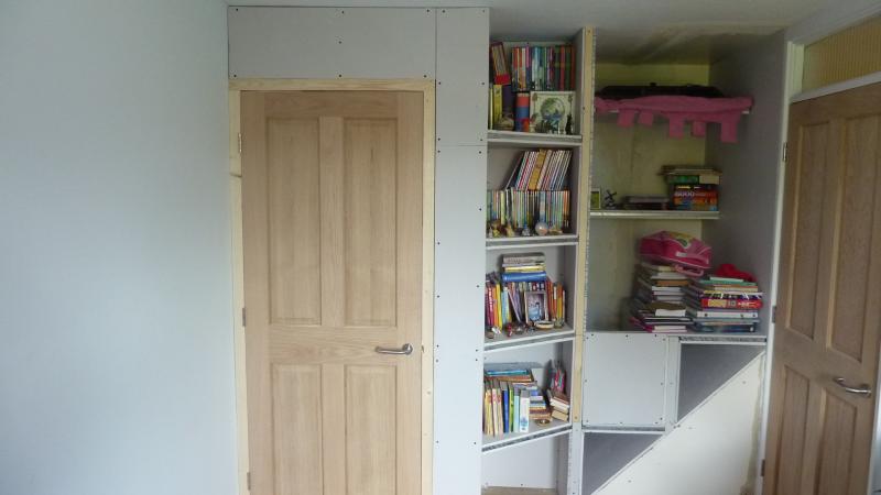

Toilet 2
Door is now in place and all plasterboard fitted.
I was just finishing and my wife immediately dumped all my daughter stuff onto the shelves before managing to take a picture LOL

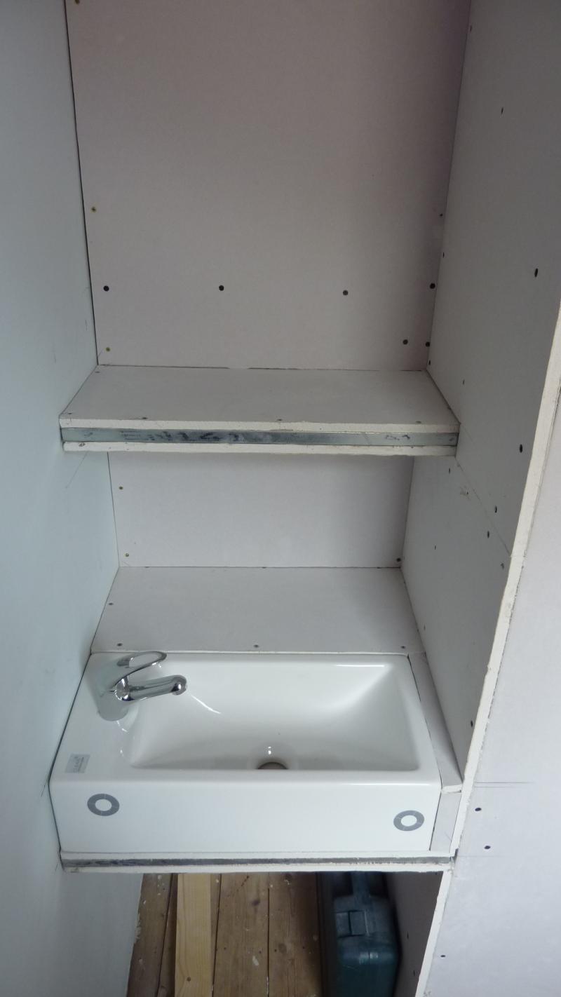

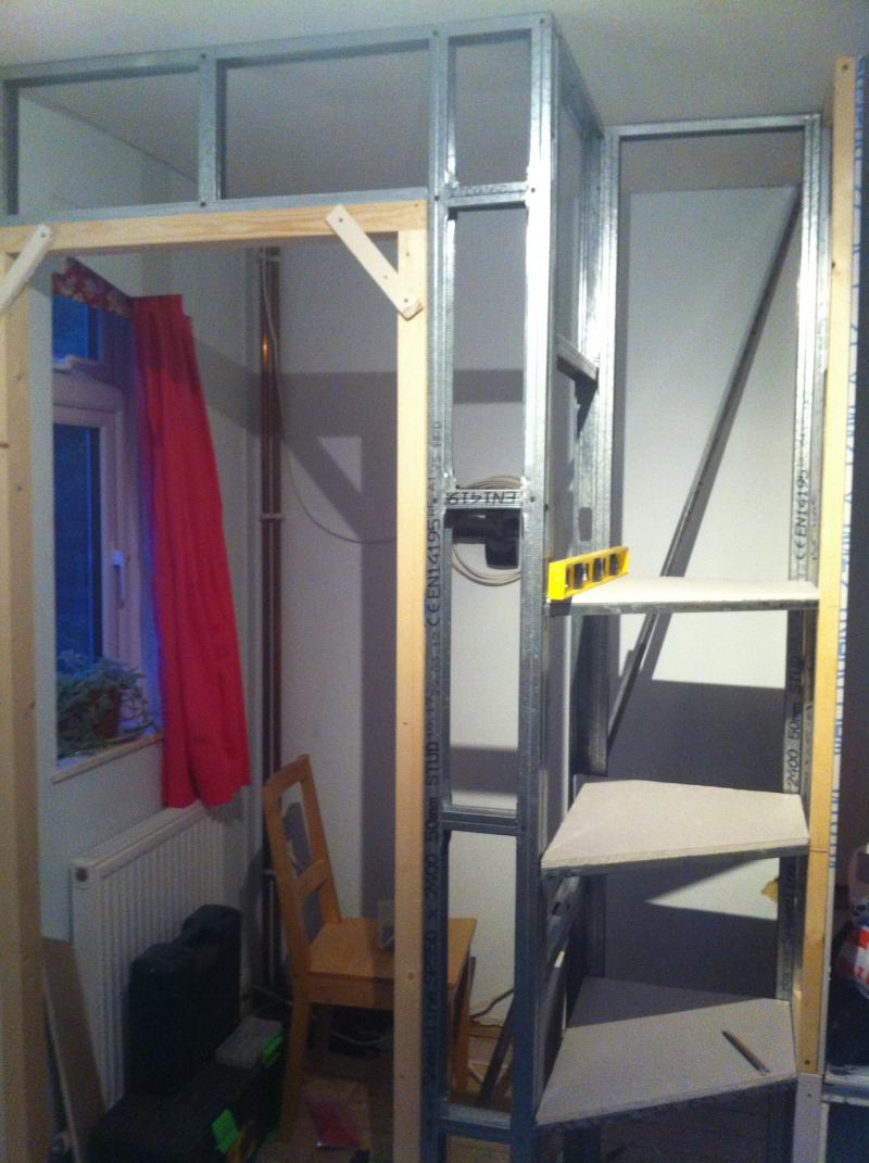

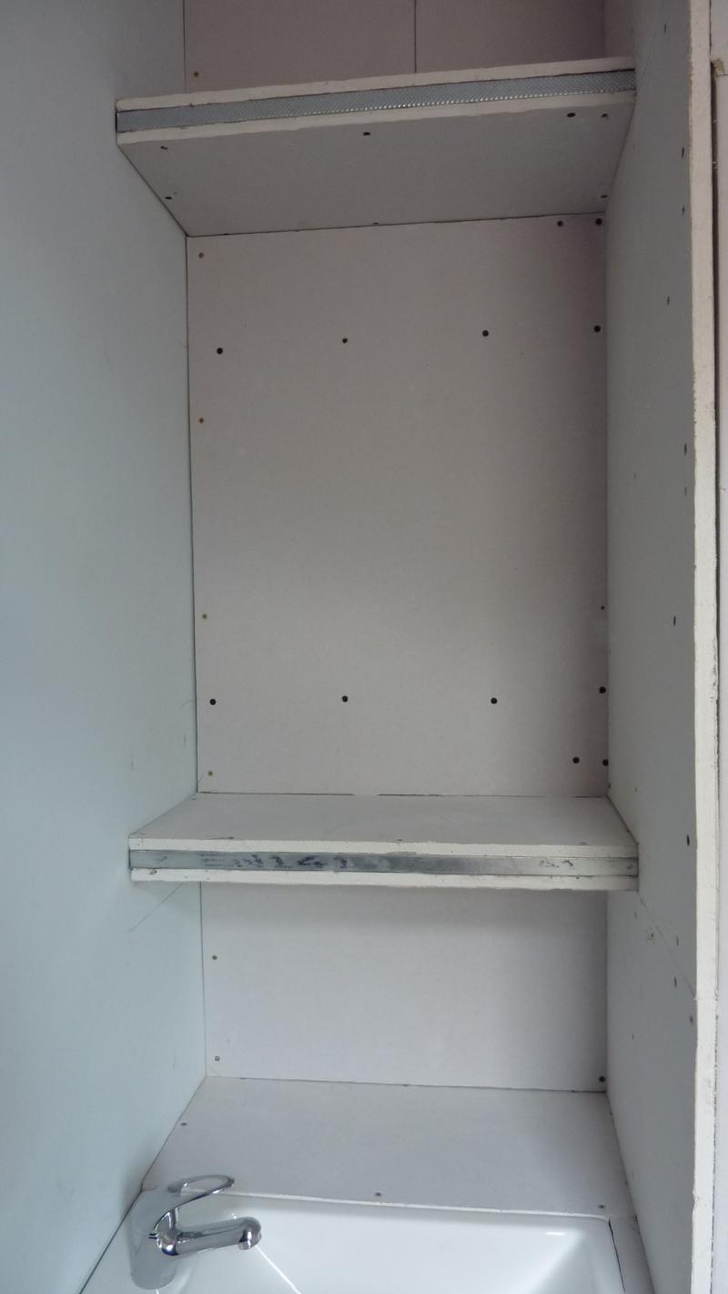

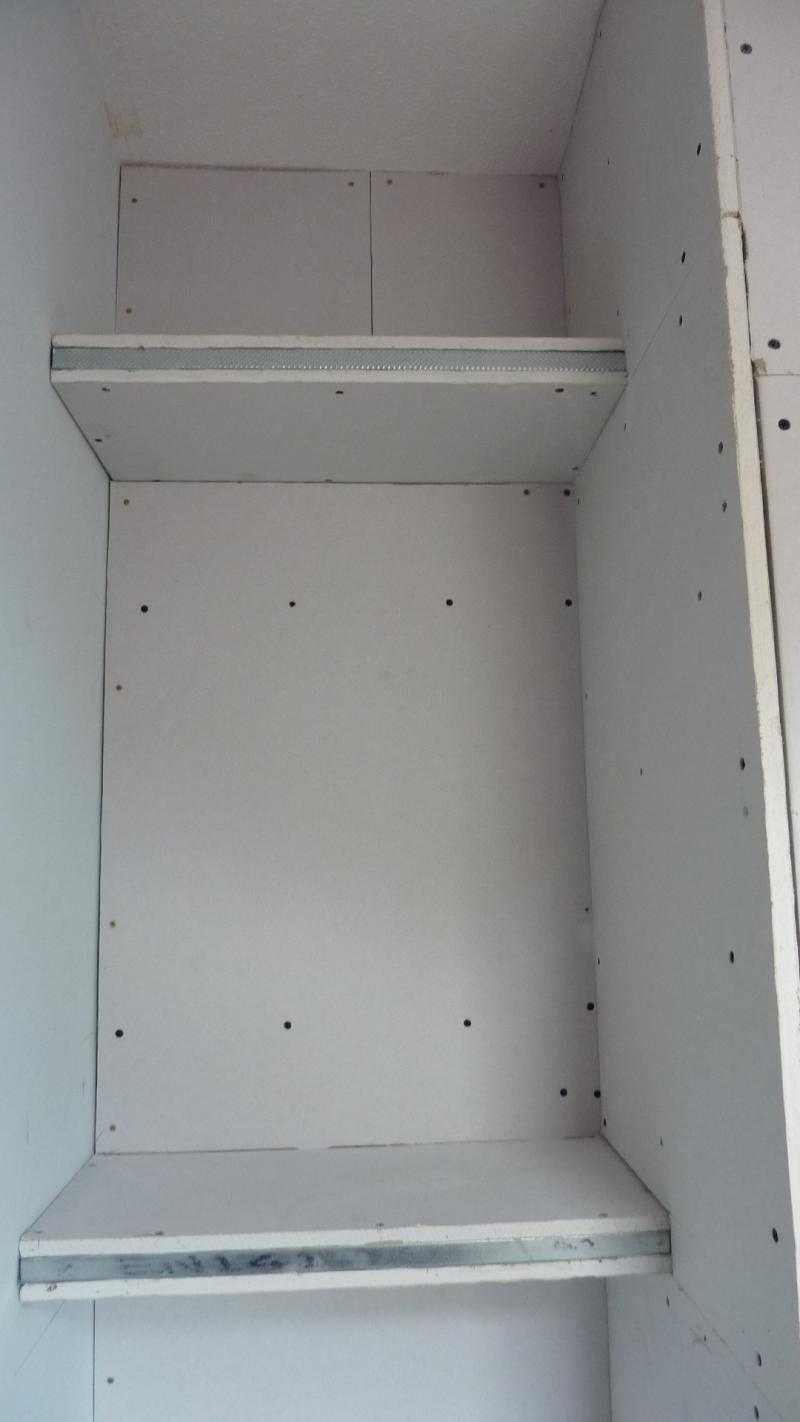

Here is my sink which is 500 x250 . Initially I was looking for a vanity unit but than I changed my mind after I saw some prices :D
I have created a structure out of metal studs which is pretty solid. I think I will do something rather similar in toilet 1 where the sink will be on the wardrobe wall.
I have added two shelves and I will fit a mirror between them.

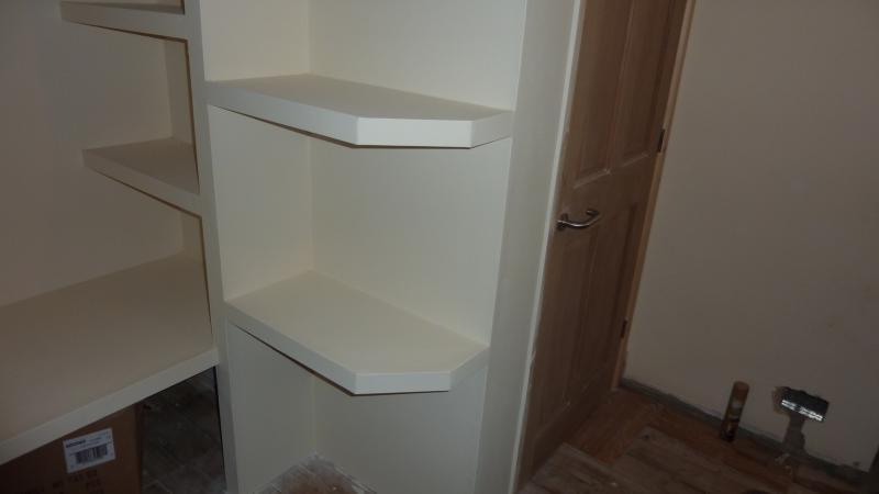

Plastered and sanded
Ready for paint
Painted and waiting for the sliding doors + lights

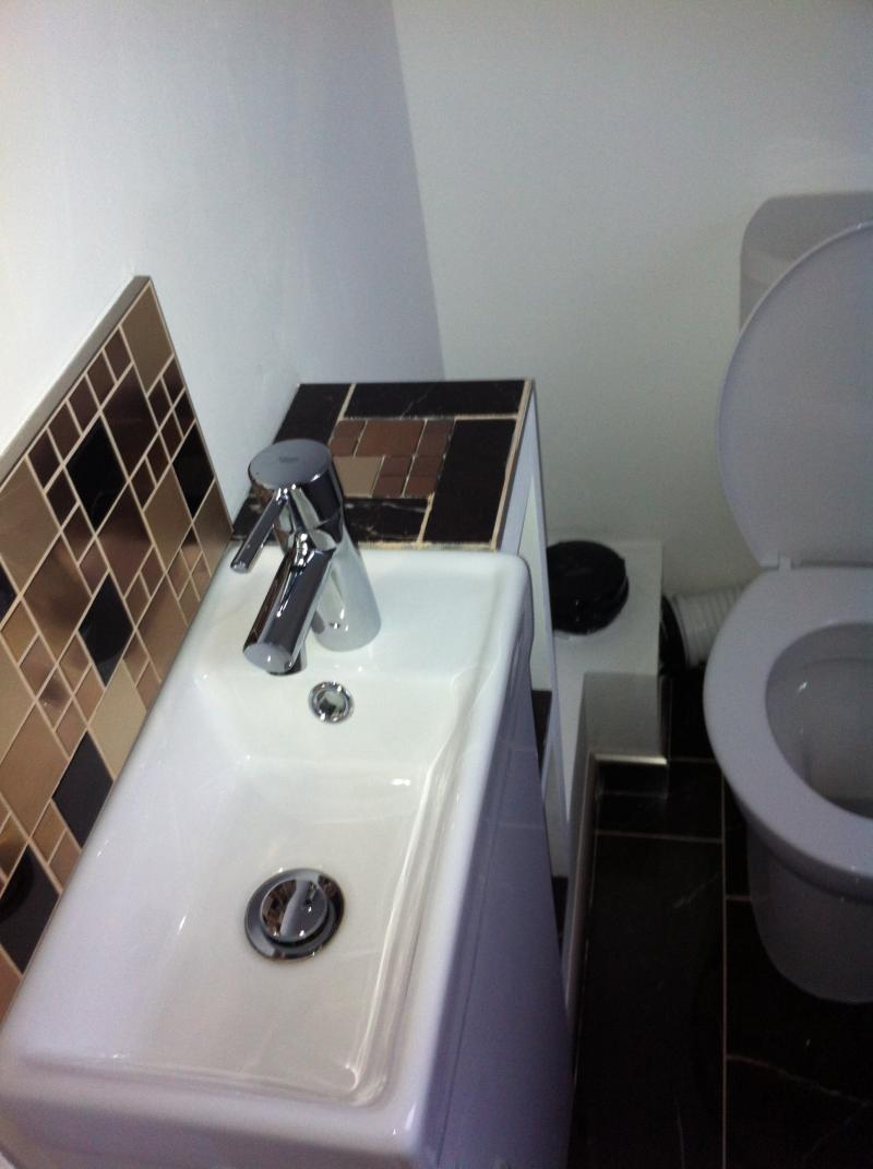

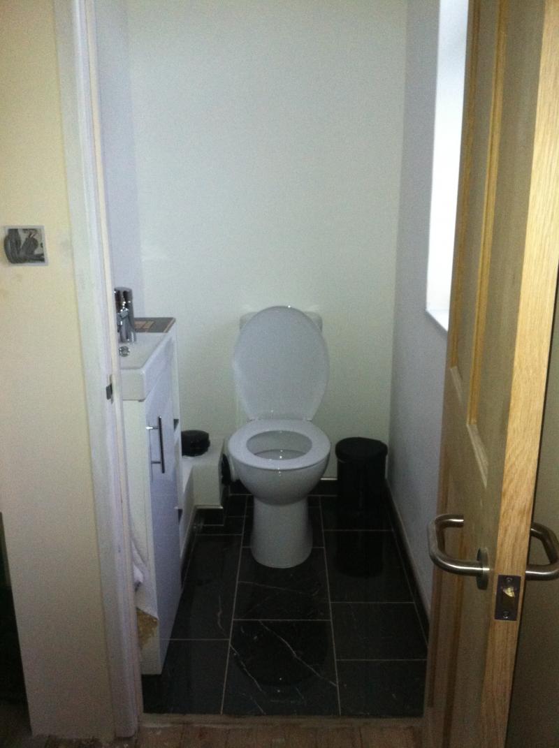

Finally I managed to almost finish the toilet to our bedroom.
I still need to do some touch ups on paint and grout.

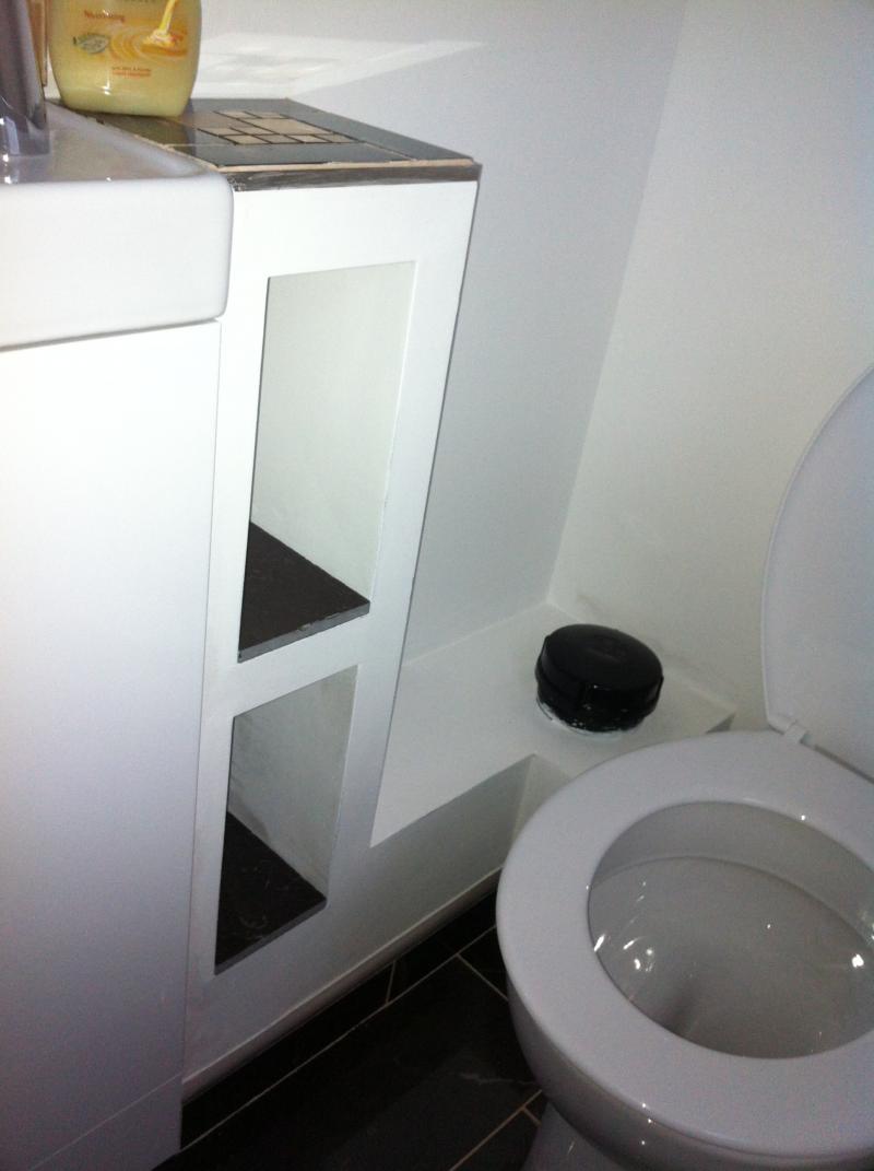

In the end I found a cheap vanity unit and then built all the unit next to it to hide the pipes. Quite useful for storage too.
I got marble on the floor which was about £120 sqm at B&Q but they had some broken boxes which I bought for £15 :-)
I cut the broken bits and I ended up with a very nice floor which actually looks even better in reality than in photos.
