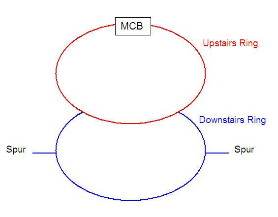

My guess is that the downstairs was intended to be an extension of the first floor ring final but it went horribly wrong when they did not know how to break into the circuit.
Instead of taking each leg of the extension circuit and connecting it as an extension of the upstairs ring final, they connected each end to two different sockets, ending up with a spur feeding lots of sockets, fed from both ends.
Indeed, as I've been discussing with EFLI, my interpretation is the same as yours.
However, that does not necessarily mean that there is anything (electrically) 'wrong' with the circuit. It results in lower EFLI and VD, better current sharing and more CPC redundancy than would be the case had the 'extension circuit' been inserted into the existing ring in the conventional manner. The description of ".. a spur feeding lots of sockets, fed from both ends" might make some people's eyebrows rise, but it should be remembered that a bog-standard ring final could be described as a "radial feeding lots of sockets, fed from both ends"!
Kind Regards, John
But then you wouldn't end up with two sockets upstairs AND two sockets downstairs all with three cables.
Fair enough - I take your point. However, unless the circuits have been traced, some of those 3-cable sockets could be supplying spurs, rather that representing interconnections between two rings. Nevertheless, I suppose it means that your interpretation of the topology may be correct - but, even though that is an even more complicated arrangements than I was considering, I don't think it alters anything I've been saying about the circuit.
Indeed, the arrangement you are considering is quite interesting, since the 'inner ring' is actually comprises parts of two additional rings (as far as supply is concerned), 'in parallel'. Most of the cross-connection in the primary ('outer') ring is therefore effectively 5mm², hence offering even more theoretical 'advantages' over a conventional single ring. It would certainly be 'interesting' to fully test such a circuit!
Kind Regards, John
If it is not as I am thinking (which is what the description states, although, obviously, the OP may be mistaken) and one of the downstairs three-cable positions is a spur (then consequently one of the upstairs three-cable connections must also be a spur) then it definitely IS non-compliant because there would be two rings (only one of which is from the MCB) one of which is connected and supplied by a single cable.
It's only speculation, but what I was suggesting was:
Kind Regards, John
Yes that is what I am deducing is the case.
Thanks for clarifying. Are you basing that deduction on the fact that there are two 3-cable sockets upstairs, and the same downstairs, or do you have any additional evidence that the arrangement is probably as you have suggested?
As I have been saying, although it is a very unusual arrangement, IF it is as you believe, I cannot personally see anything electrically wrong with it (no 'worse' than a conventional ring) - although I am sure there will be continuing debates as to whether it is strictly compliant with regulations.
Kind Regards, John

If I have understood correctly, this is the configuration:
No - neither of us said those things.
