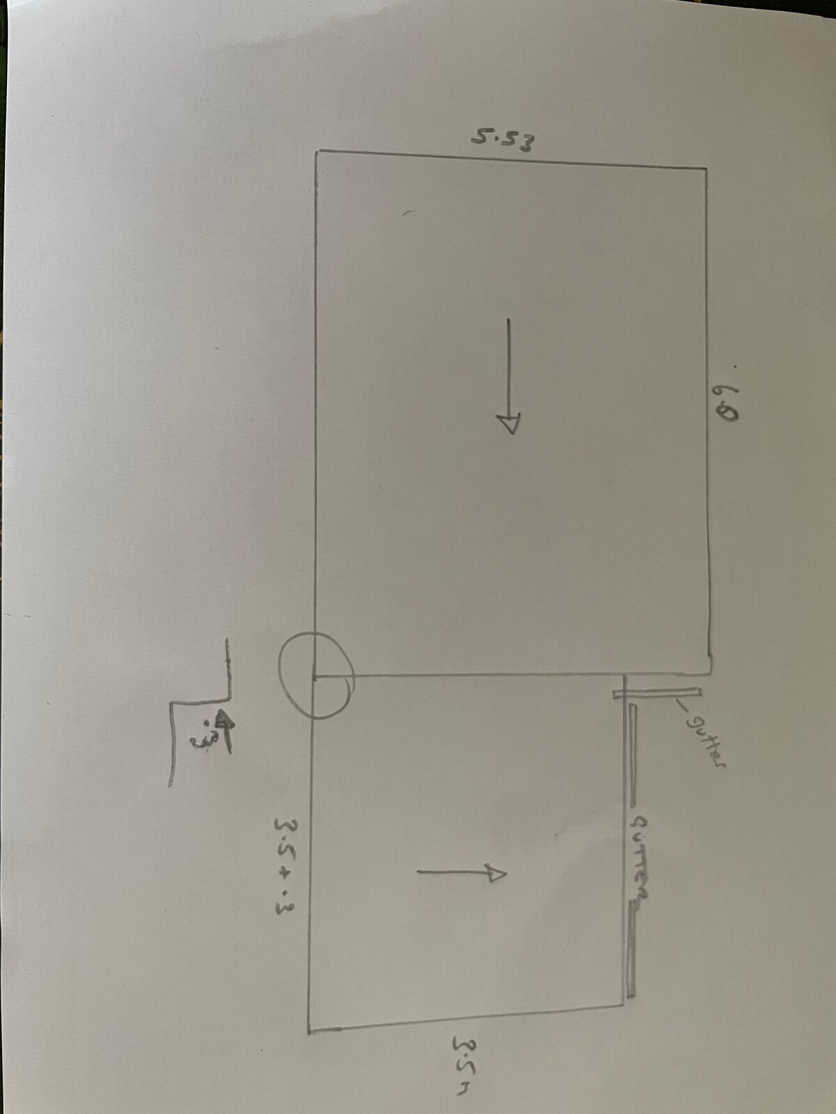

Ive got a split level flat roof im going to replace with EPDM.
Question is do I treat it as two separate roofs and facia the step down and chase the wall for the lower roof or overlap the EPDM and join the two roofs?
Any pros/cons or either method?
